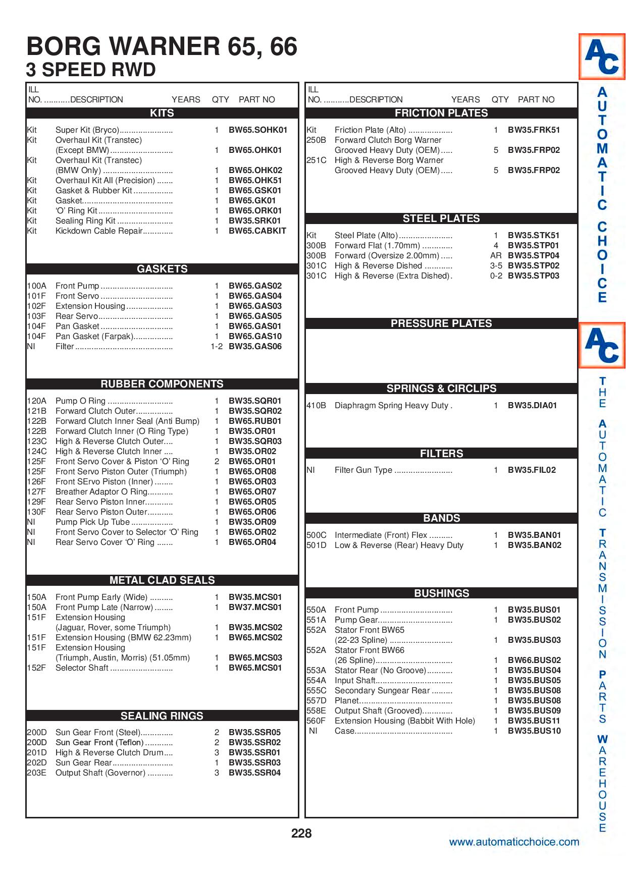

You will be ok 3/4 on the hot marks. Don't worry about the cold mark just a initial fill guide properly hot so you cant touch the casing its likely to be on the full mark. I checked the factory data for the correct oil this am it says BLMC type F Trade name Castrol TQF. I think the plate you are talking about are the clutch servos see exploded diagram of main case.

Yes they are the parts where its got a slight misting from Dave. I am not unduly worried. The leak from the sump and the dipstick tube union were far worse and now appear cured. After the last top up I've driven the car, not that far but to my parent's house, about four miles each way, and it is fine. It is possible, or maybe my imagination, that when I drove the car for 35 minutes earlier today, with the 'HOT' level appearing low according to my post-drive checks, the transmission was a little clunky on down-shifts, and may have been smoother when going to my parents after that last half-litre was put back. Or like I said, it could just be my imagination.
