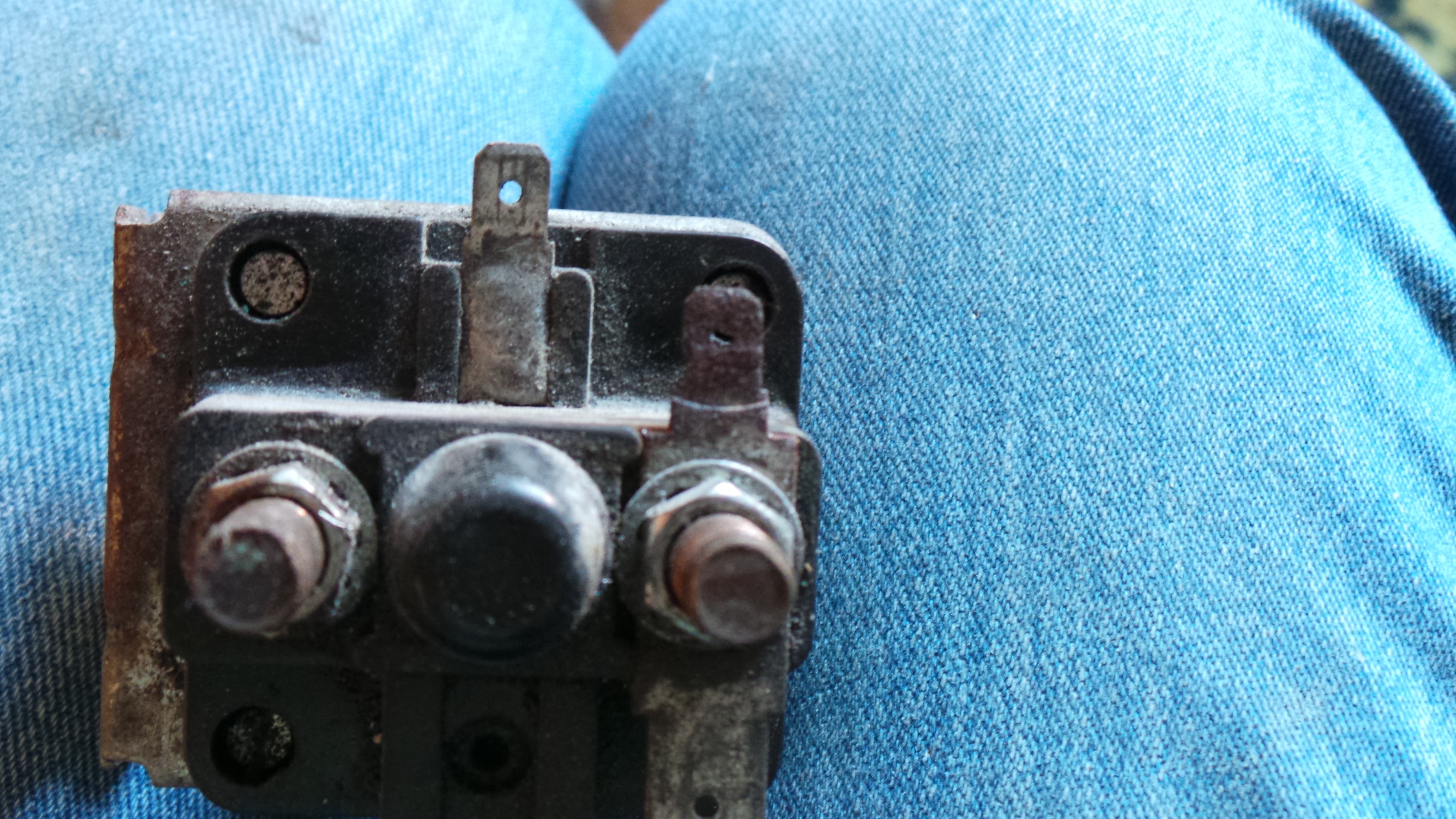

The problem, can often be the to do with the starter solonoid. It works by connecting the battery power to the starter motor itself. When you turn the key it energises the solonoid and throws the connection making a physical electrical contact. The contact patch spark erodes each time the starter is used, so over time the contact patch is reduced. To begin with there is engough contact for the electricity to flow, but overtime it reduces so that the starter can’t turnover so well. Finally the contact erodes so much that when the solonoid energises the contact is not made and all you hear is a click.
You can get the solonoid reconditioned, or you can buy a kit and do it yourself for £10 or £15.

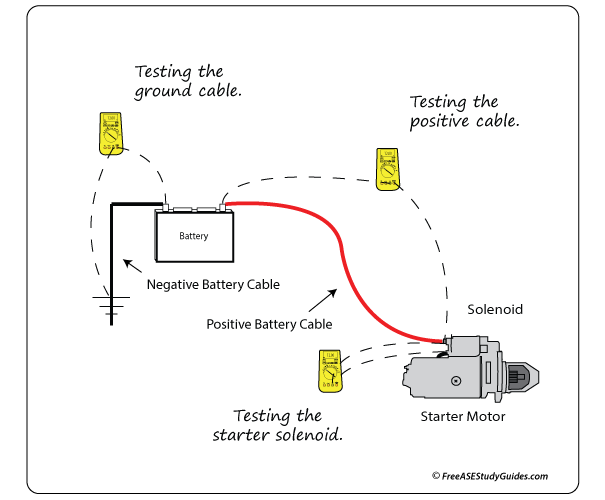

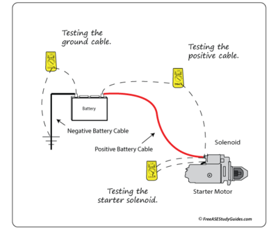

When the diagnosis in my above post and the threads are followed the correct diagnosis can be obtained with just a Volt Meter without even having to consider try and measure amps ( current) a Starter motor takes approx. 100amp this is usually measured using a inductive clamp.
1 Check Voltage at battery should be 13.8 volt fully charged 12 volt is sufficient below that charge / replace battery as required
2 Check battery Voltage while cranking starter should be above 10 Volts if below as above charge / replace battery
3 carry out same voltage test as above at starter solenoid result shout be same 12 volts at rest 10 volts under load if below check battery positive voltage check for volt drop ( done by connecting negative lead of multi meter to battery positive and multi meter positive to starter solenoid under cranking meter should read less than 0.25 Volts if above you have a fault lead/ connection
4 Repeat above test on starter result as above
5 Check body and starter earths for volt drop under load again should be below 0.25 Volt The above testing can be carried out with a cheap Digital Multi Meter in about 10 mins without any dismantling.
T make starter work you need 10 volts under load ( cranking) at main starter terminal and less then 0.25 volts in the earth side under cranking. In addition you need a trip voltage at starter solenoid from Ignition switch this again must be above 10 volts when cranking.
The last thing I would be doing is going the effort taking the starter off and powering it up in the vice. All this tells you is motor turns without load. Some cars can take upwards of 2 hours to remove and refit starter when a poor connection on battery can be fixed in a few mins !
