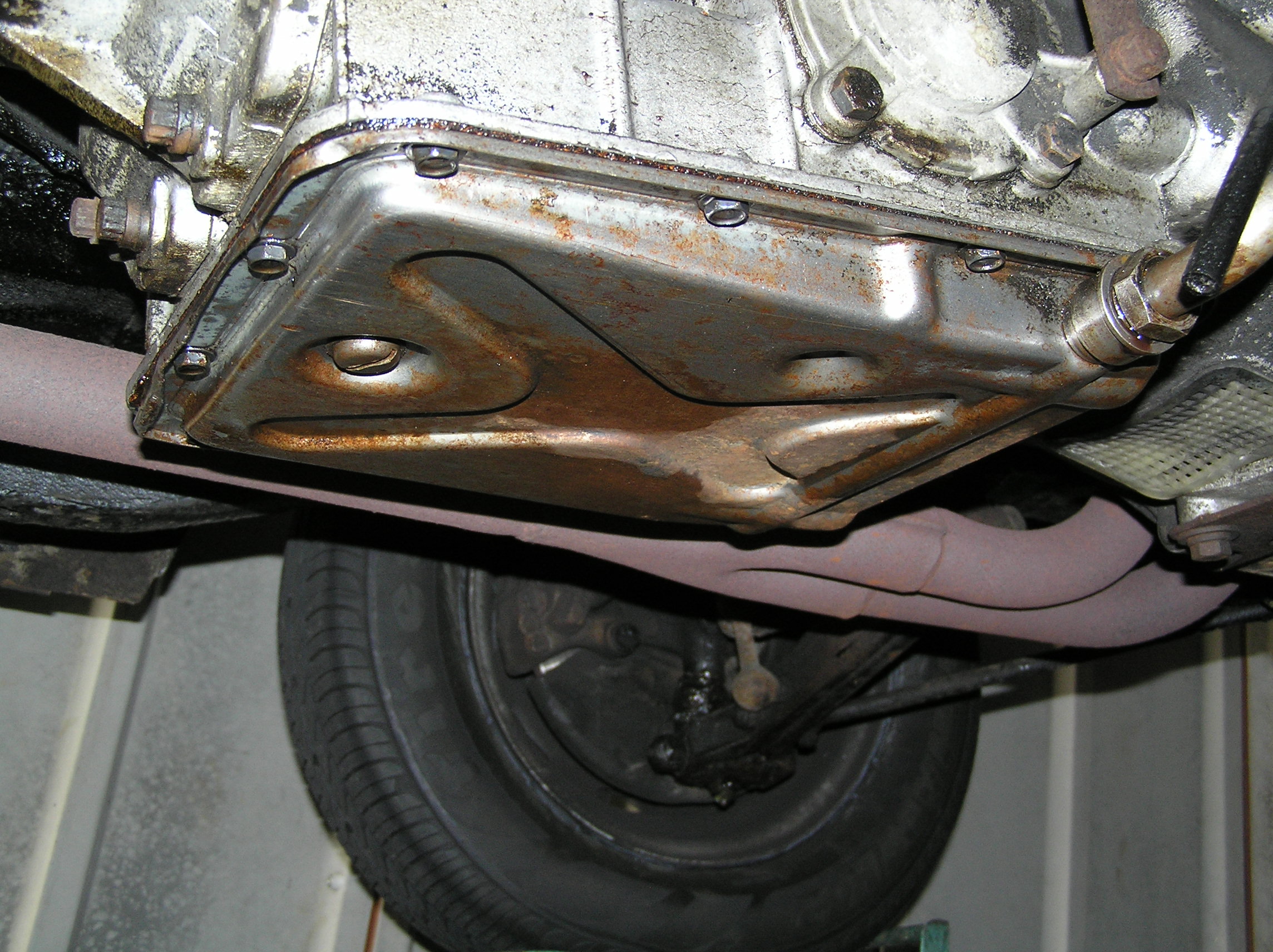

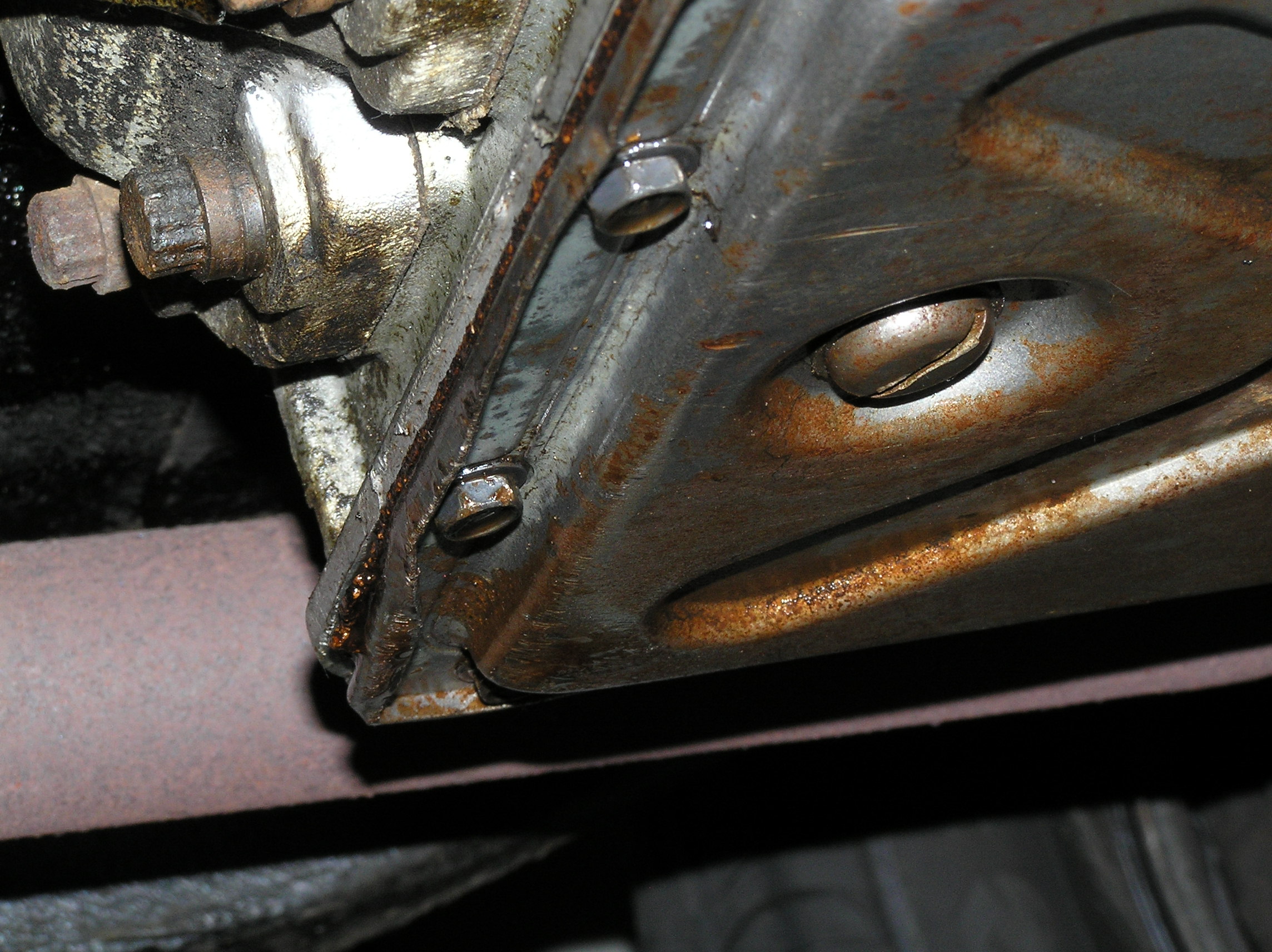

I think it is leaking from the sump gasket and the union. I've got a new filter anyway (that's the pistol grip looking thing in the bag) so the sump is coming off and the procedure is to dress all the holes with a hammer on a flat metal surface, because the holes can dish, then the bolts feel tight but the gasket isn't compressed. Also only light force is needed to tighten the bolts - I've read only hold the rachet by the head, not the handle. Otherwise you dish the sump holes again. I've also got some Loctite hydraulic seal for the threads on the union. That was £9 for a small bottle...

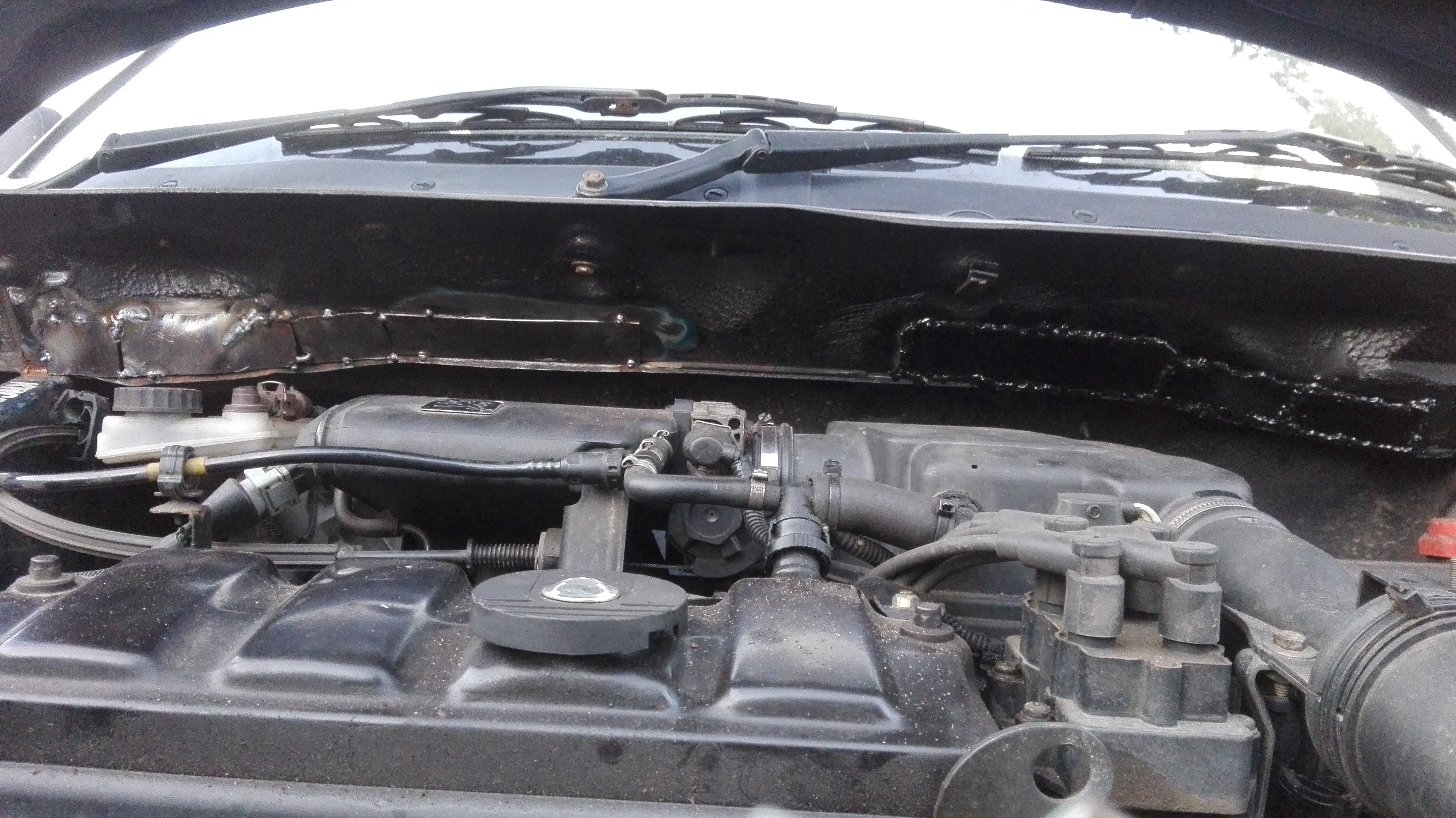

Once again not quite a Marina, but have spent half the day welding the Peugeot along the scuttle panel for its MOT (just need to finish welding around the driver's side bits :thumbup:.

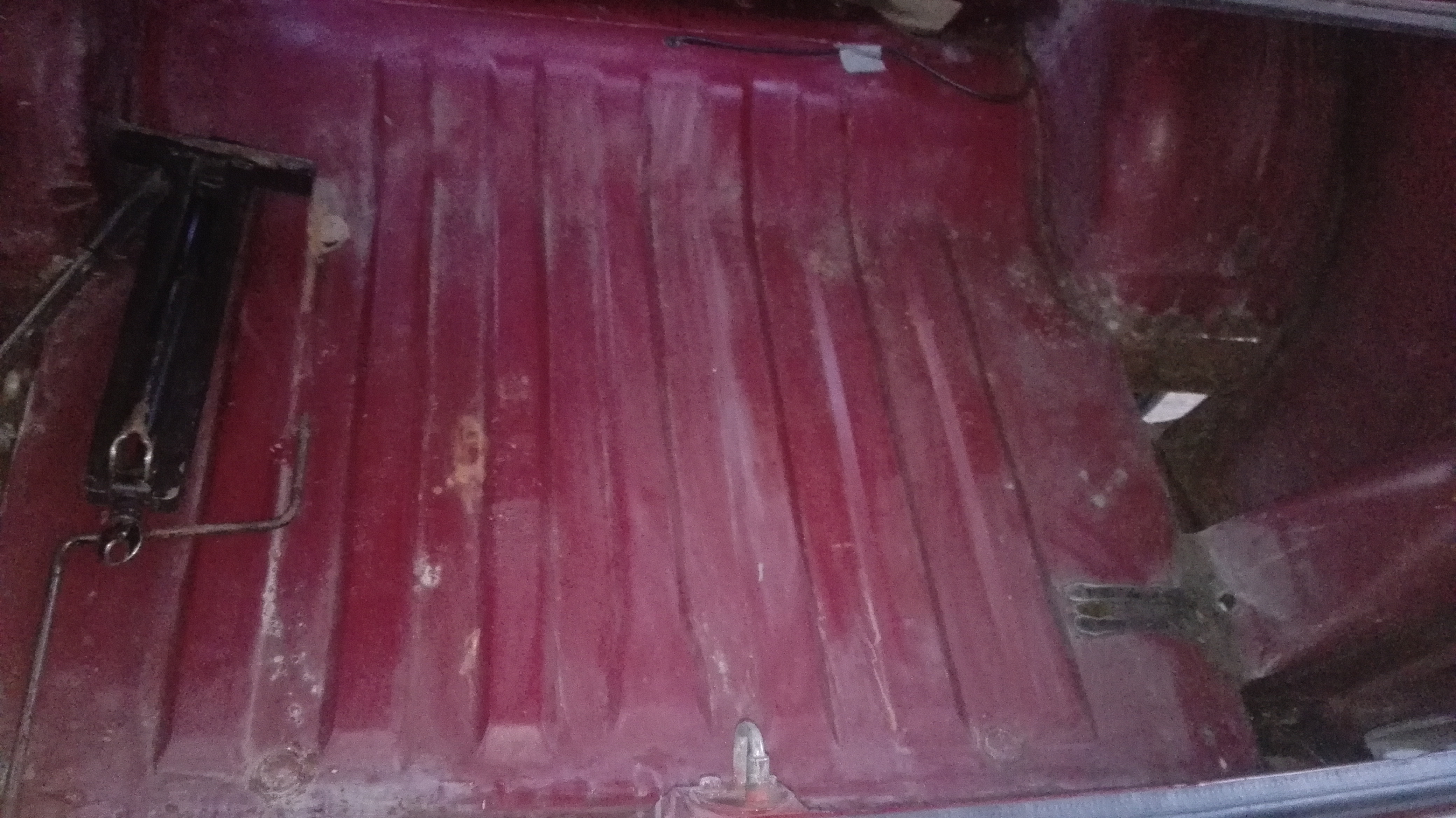

While my girlfriend has been clearing out PDA from the mass of stuff that's built up in it and cleaning up the back floor and boot areas to encourage me to fix it :thumbup:. (It's working ;)).
