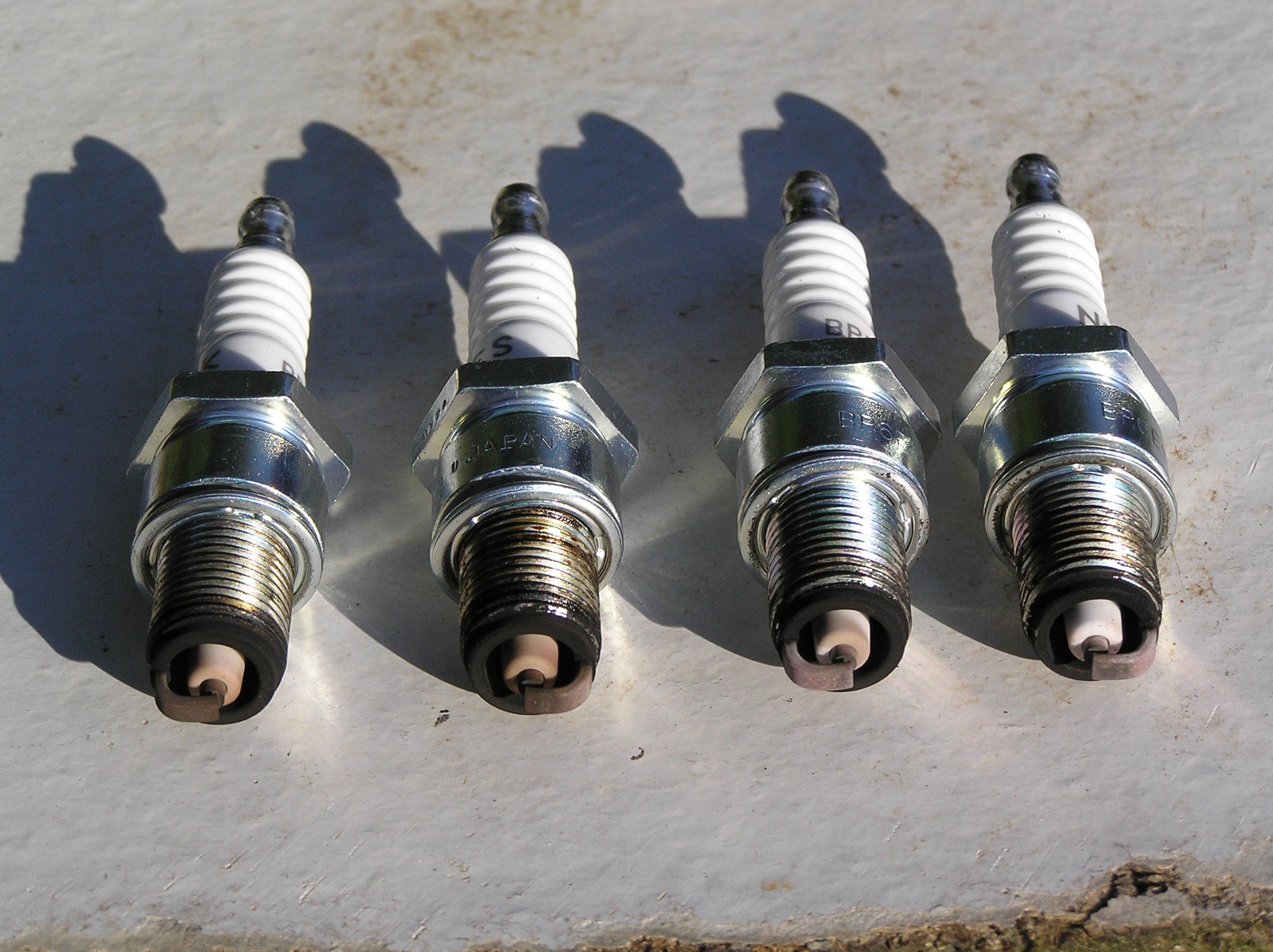

I've uploaded a picture of my sparking plugs though. What do you reckon? Is it tuned right? They are in the order of the cylinder they came from i.e. number 1 on the left, 4 on the right. The ceramic nose on 1&2 looks a bit 'pinker' than that on 3&4, with 4 being very white.

They look fine to me, if you being very fussy rear carb running slightly weak. Not enough to need adjustment though.

Thank you! That's just the reassurance I need!

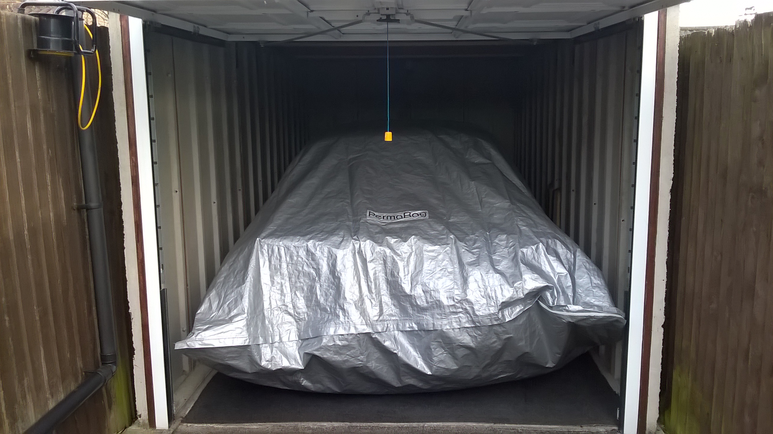

I said it couldn't be done, and I said I wouldn't do it. But I've spent Christmas morning wrapping something instead of unwrapping something. Last week I went into the garage and found the underneath of my Marina drenched in condensation. I used a fan heater run from an extension lead strung along the garden fence to dry it out, and very effective it was, but the open bedroom window for the lead, and rate of electricity consumption meant this couldn't go on. So the Permabag I bought in 2009 to protect a £1500 Mini held together with welded plates, was forced into action again. I'd bought a bag big enough to house a Cortina or a Viva (I never imagined I'd buy a Marina back in 2009) but when I put this car in this garage almost two years ago I believed I'd never get all the way around the car to pull the bag over the top. And I thought it would be best to keep it running anyway. But last year it hibernated with a sick engine, but I never noticed the damp on the car like this year. It's not easy pushing a big car over a bag, single handed, without running over the folded section that I've got to pull over the roof, but I managed it eventually. It'll be here now till the end of March. I know that's not everyone's idea of classic car ownership, but for me this is the best step for preservation in winter. Happy Christmas

It's out.

Can you see why I bag it?

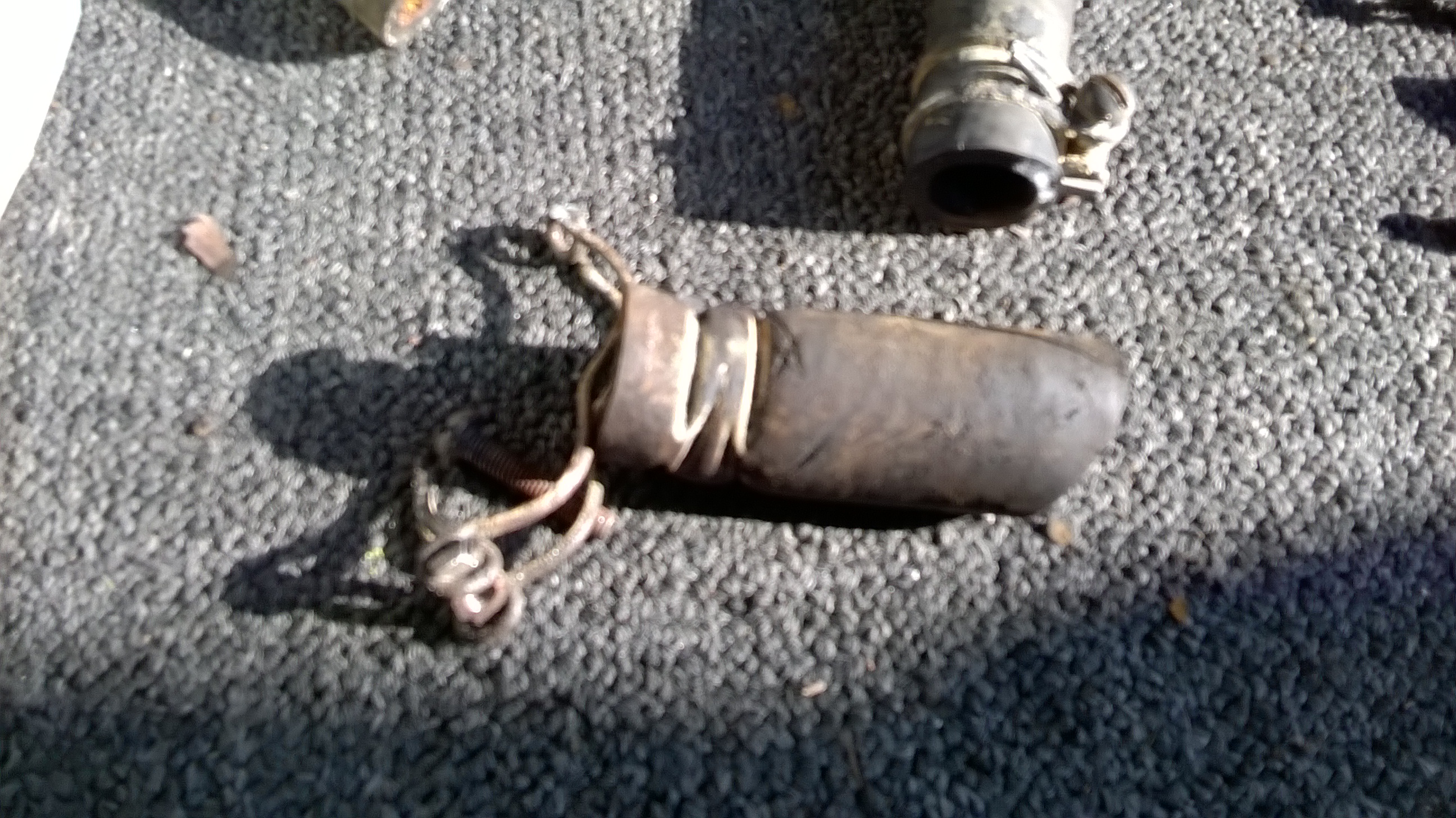

Well I'm having huge fun changing my heater hoses. Which by all accounts, once I'd passed the point of no return, looked fine, but going by the wire hose clips on them, they could have been the 40+ year old originals, which is why I got some Kevlar ones off the club a while ago. Only trouble is, having chopped up the hoses bit by bit to get access and peel them off the heater box stubs in strips, rather than risk damaging the heater somewhere by pulling and tugging, I'm left with a stub of rubber held by an immovable, virtually inaccessible wire clip behind the heat shield of the twin carbs. No screwdriver will turn the screw, nothing I've so far tried in the limited space has succeeded in cutting off any part of the clip. I refuse to take off the carburettors to get to one hose clip! After my cup of tea I'm about to embark on another attempt to cut the wire with a broken off piece of 18tpi hacksaw blade. Its a bit like trying to saw through prison bars with a file smuggled in with a cake. Remind me why I love this hobby, because I keep forgetting...

Miserable little......hoseclip
oh, those things. I think they are original to the car and a far better than the usual jubilee clips but when they seize they're a right pain to remove, more so I'd imagine with the twin carbs in the way!

Yeah I think the twin carbs was part of the issue. Not sure why you like 'em better than jubilees. I don't like the way they cut into the hoses. Suppose they're less prone to stripping though.
I couldn't cut it in the end. That metal pipe its fastened to that runs down the side of the block behind the manifold - initially it was quite tight in whatever bracket holds it in place. Its less tight now. As I got more frustrated, and angrier, I got more brutal, and in the end I was able to waggle the metal pipe closer to the bulkhead. At first I could only turn the hose clip screw with tiny molegrips on the thread, then, I could just manage to get a screwdriver in the screw slot. But it was a bit molegrips, bit screwdriver, bit fingers, bit back to molegrips. It fought me for every quarter turn. In comparison, getting the new hoses on was a cinch! Ended up just filling up with coolant and leaving checking for leaks and air locks (plus the first fire-up of 2018!) for another day. I'd got fed up and loads to put away. I'd started by replacing the carb float lids and trying a new spacer in the front carb to try to stop the float chamber wobbling. After Mr. Wotsisface first rate job on the carb rebuilds/substitute-carbs-from-a-box-of-bits last year. Highlight of the day, as I was about to push the Marina away, having cleared the garage floor of my debris (tools) was a geezer who came down the street in a lowered Mk2 Golf, appeared behind my car and wanted to take a photo. Nice guy too. Not the sort I'd expect in a lowered Mk2 Golf. Very beardy but slight build and very polite.
Golfs and hipsters, they're everywhere Yes, you can get a tighter seal with those older clips without stripping the thread. Bicycle spoke cutters are good for getting those old clips off if the screw is dead.

Ah, I haven't got any of those. And I'm not sure what they look like. Limited access though, if it's a thing with levers, like pliers. Plus, that wire clip had cut very deeply into the rubber....
