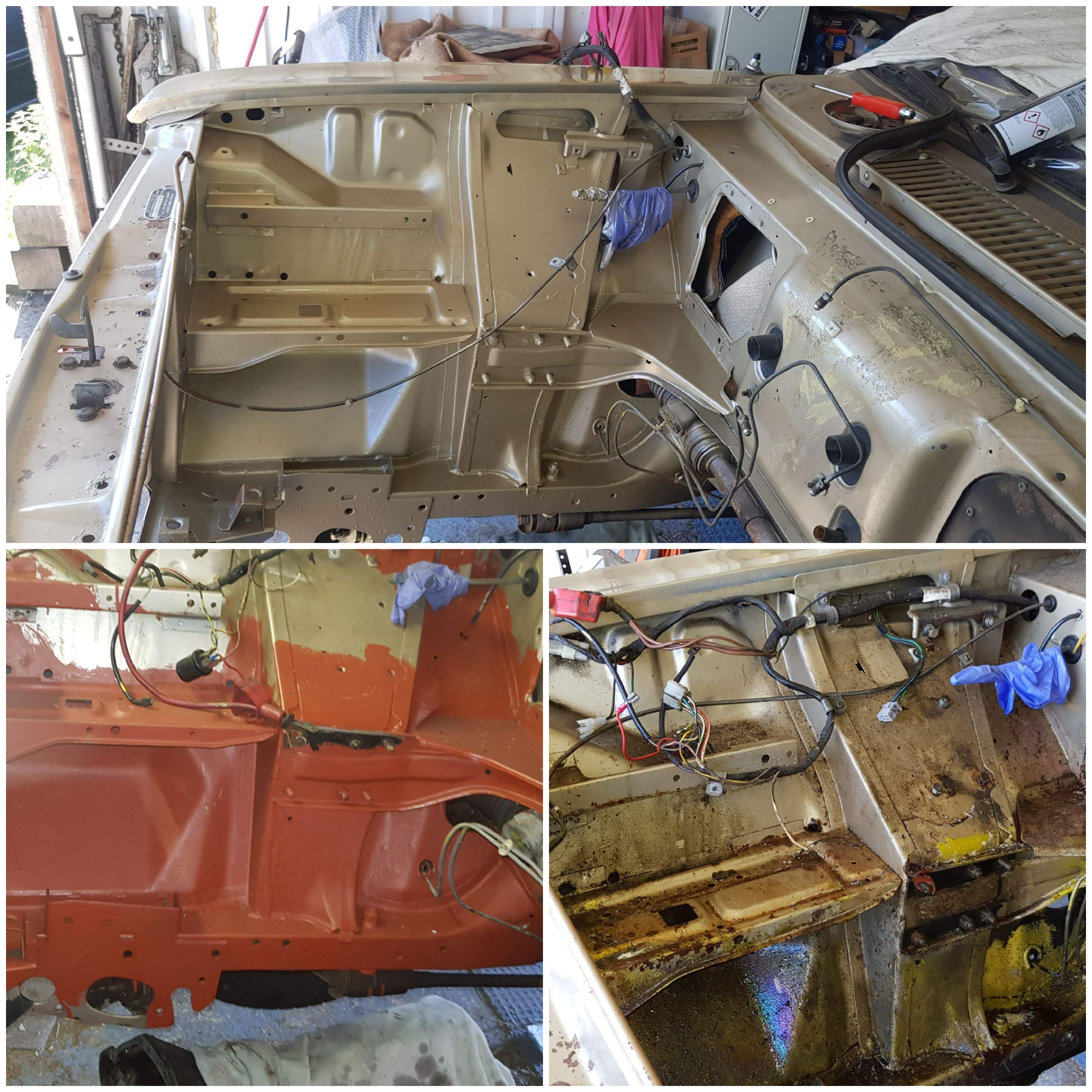

Just a quick update, i managed to get the engine bay painted yesterday.
