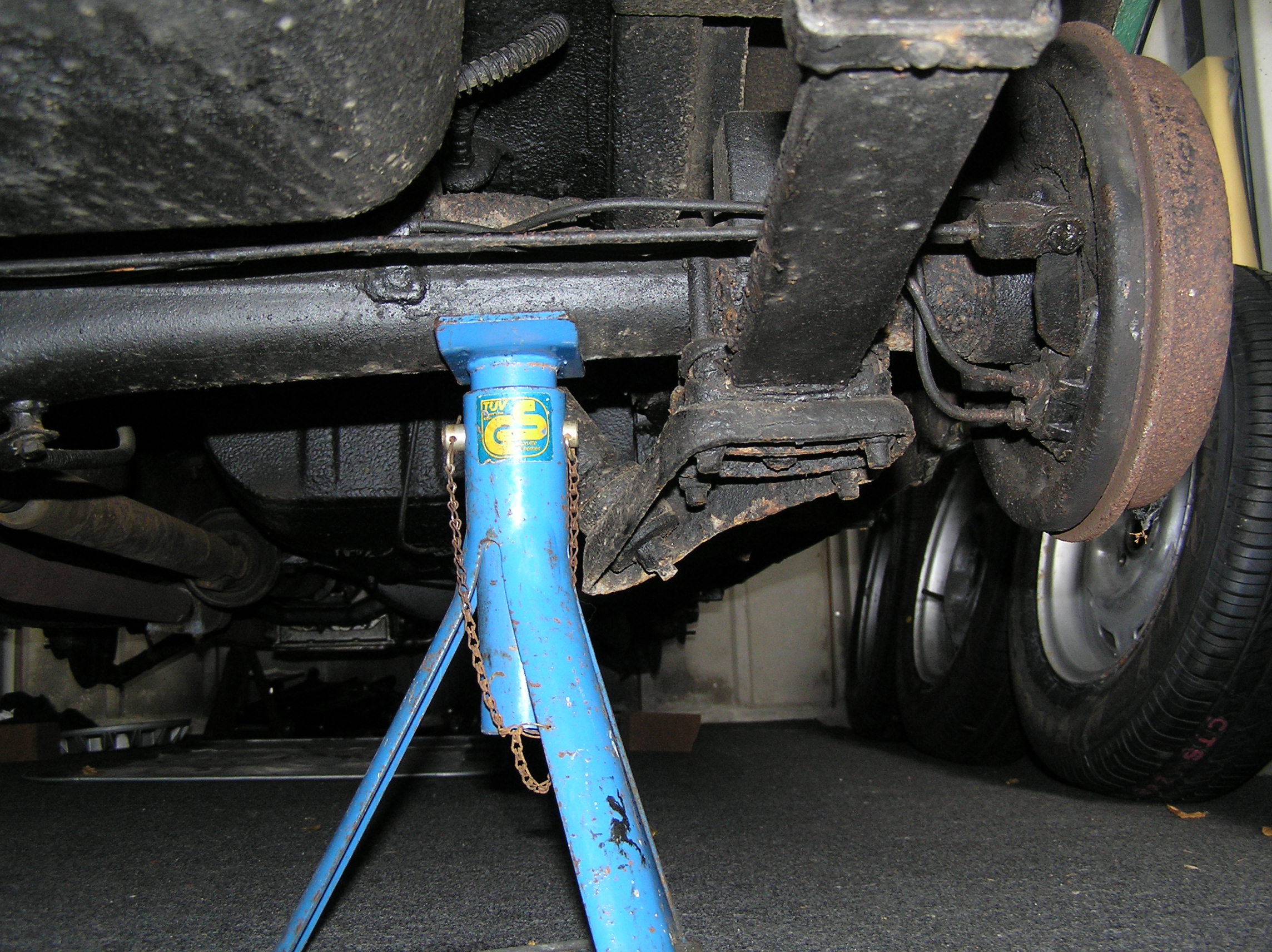

Okay so I asked the question at first, now I'm providing the photos!
The back end is easy. I never had any worries there. I lift on the diff casing and support on axle stands, just inboard of the leaf springs. Though the diff casing is probably indestructible, I do use a rubber pad or piece of wood just to spread the pressure points created by those castlelated claws they insist on putting on trolley jack lifting cups.

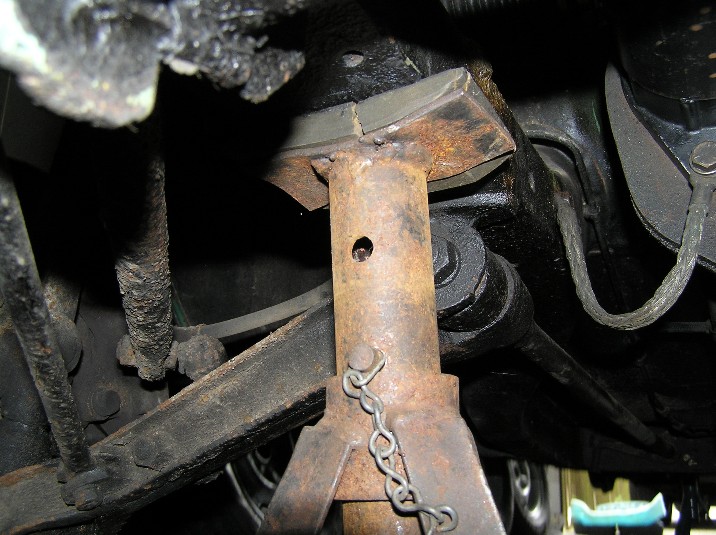

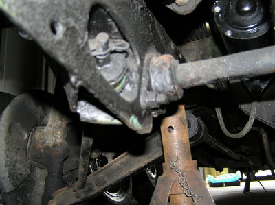

Where the suspension tie bar is anchored there are a collection of plates that form a triangular box, which also have the towing or lashing eyelets. They are pretty thick plate, but the lowest edge that a trolley jack cup catches is vertical rather than a flat section, that would spread the load better, or at least that's how I think of it. Still, I've been using these points to lift the two Marinas I've ever owned (I don't talk about the short term 'S' reg Mk2 I had for a month in 1987) so in the early 80s when the under floor jacking point on my white Mk1 looked a bit too suspect to use, I got myself a hefty scissor jack and carried that in the boot. And lifted off these same points I now use with a trolley jack. The cups on my jack(s) are pretty compact but again I've got some thick rubber (getting a bit worn now) I put in the cup to protect the car's metal as much as possible. You can see where the lifting process has taken the black underbody coating off the lowest point of the plate and revealed the green paint, but that's the worst that's happened. I place axle stands under the chassis just ahead of the lower suspension arm pivot point. Things would be so much easier if the Marina had a nice front cross member like a Cortina 3/4/5 or an HB or HC Viva, but unfortunately, it doesn't.
