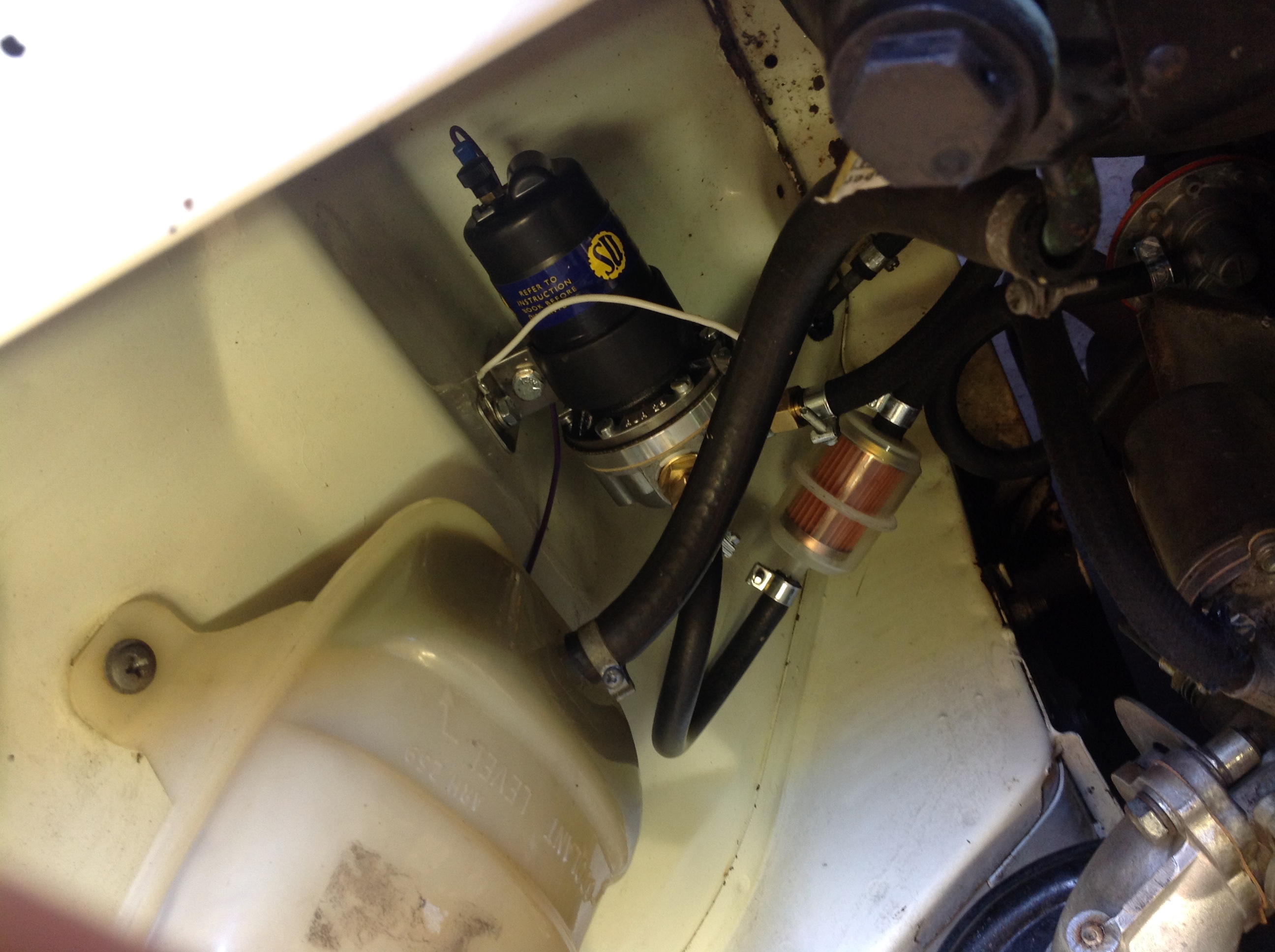

Went out into the garage and started the coupe for the first time in three months. After convertion to the electric pump it fired up on the first turn of the key. No more of that extended cranking for me, turn the key, wait for the ticking to stop and whoosh into life it sprang!
