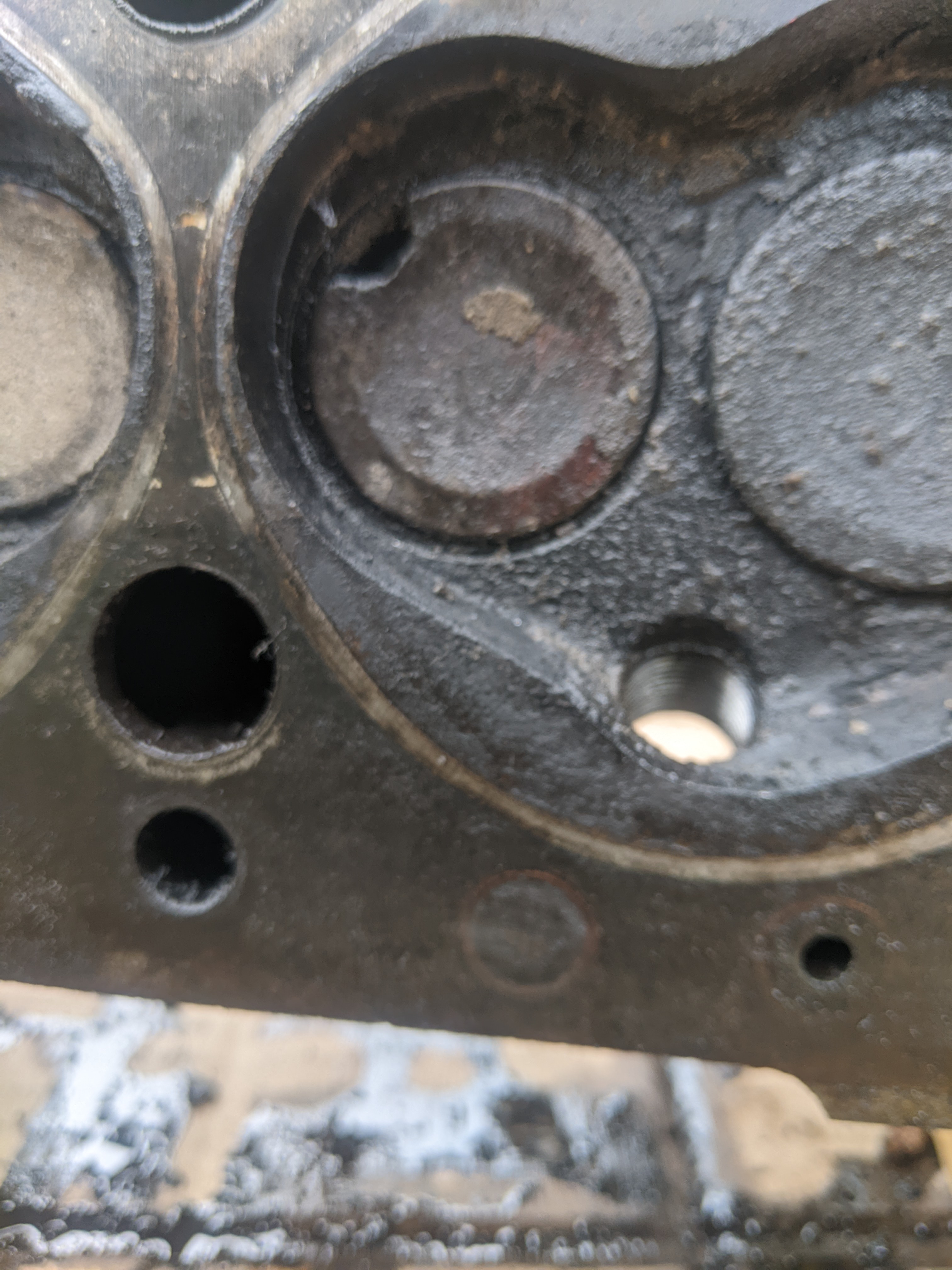

Took the cylinder head off my saloon to the machine shop:
Felt this valve go while driving along the A61 last week, with a sudden loss of power climbing a gradient. Managed to get home, then a compression test confirmed the fault was with number 3 cylinder. Thought that as the car has just ticked over 100k I might as well have some new valve guides, valves and springs fitted while the head is off.

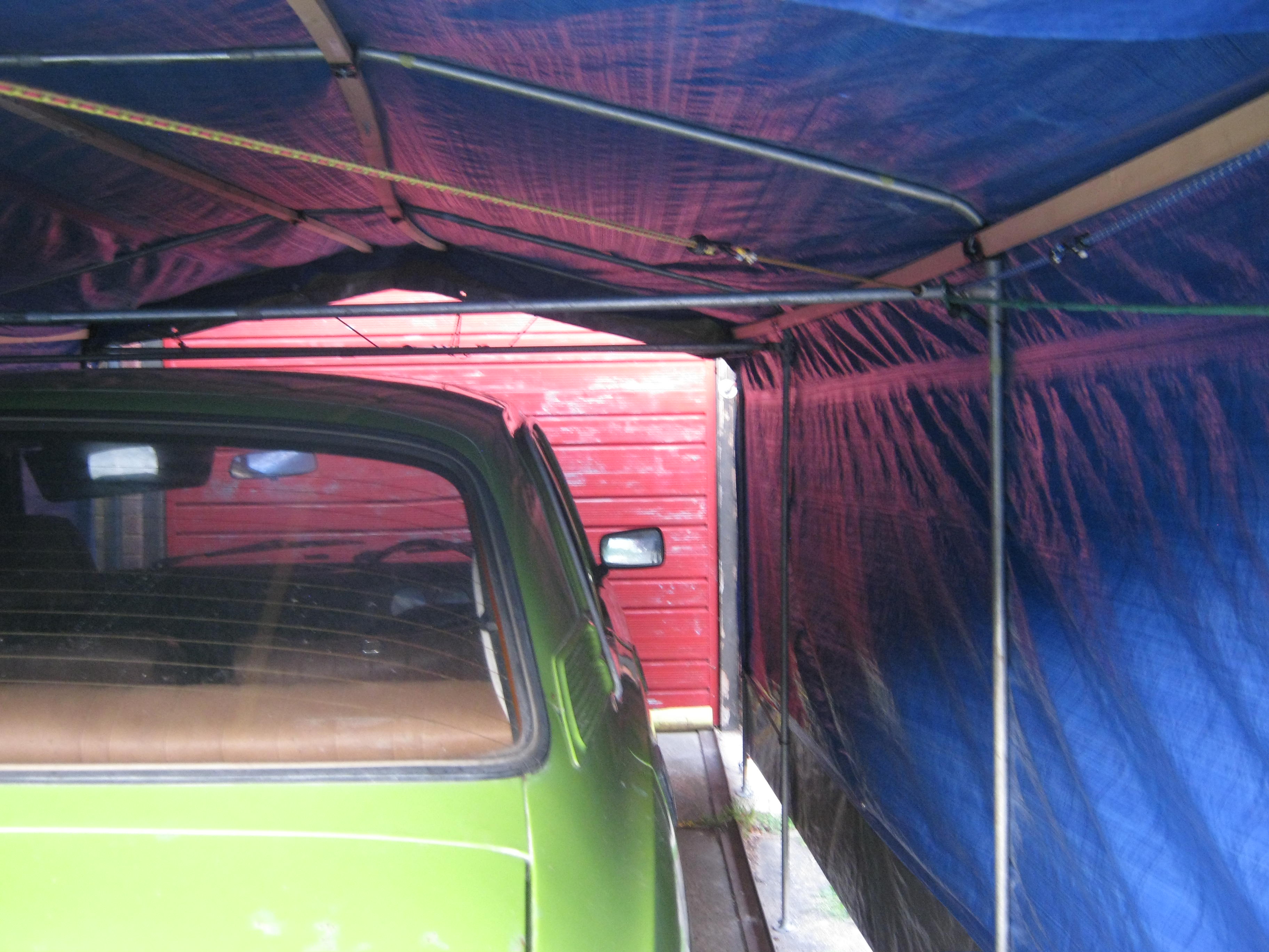

Post by Mandator » Thu Jun 02, 2022 9:46 pm
Have acquired some Walford Trunnions so when they arrive will get onto replacing the existing ones!
"Kermit the Flog" now has a little home to keep it a tad dryer.
As space is a little limited had to cobble one up from "Conduit"

Post by ScreamingLordStokes » Mon Jun 06, 2022 7:31 pm
Nice garage there! Good to get Kermit under cover (although I thought it might prefer being damp!)
