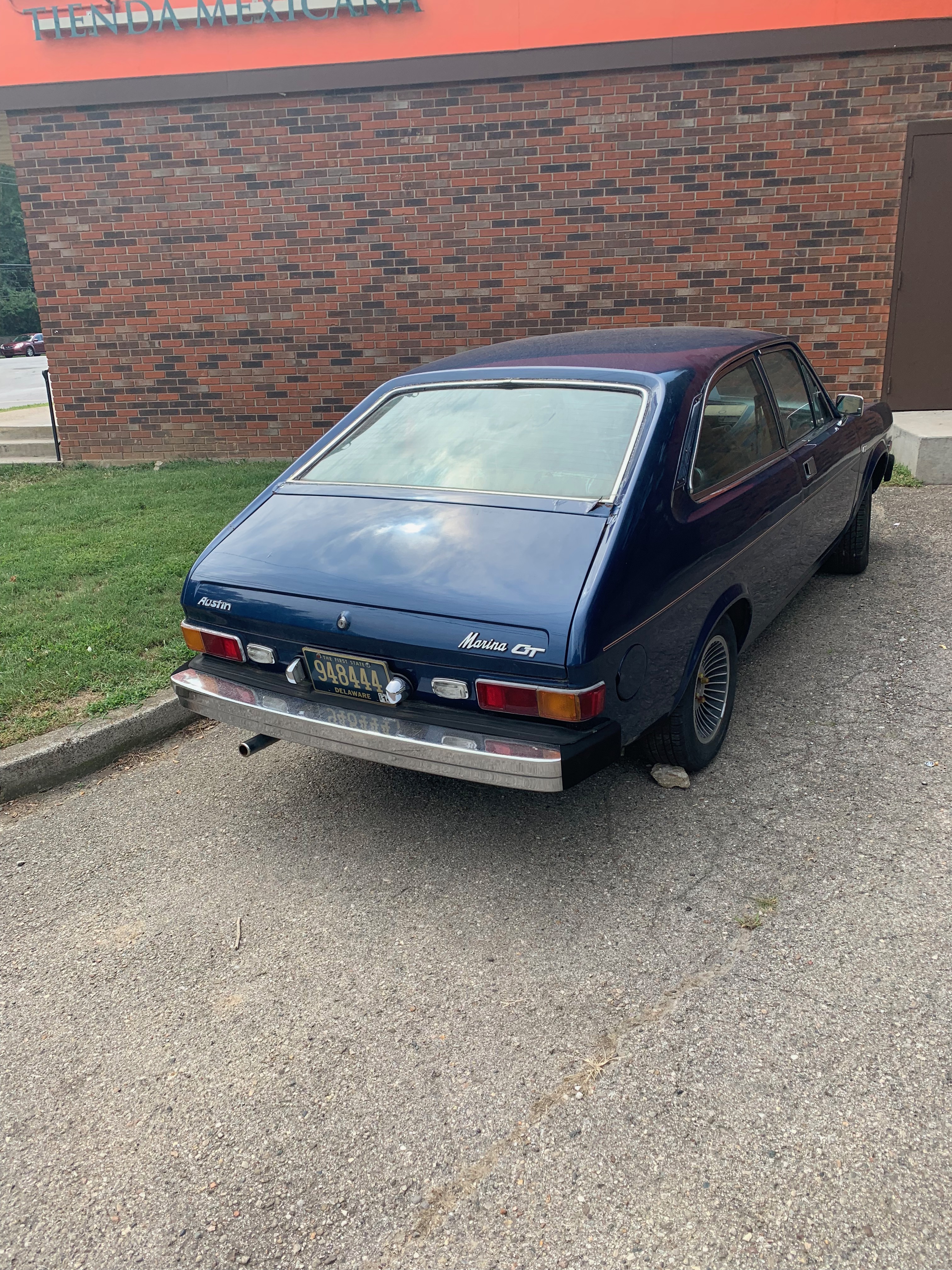

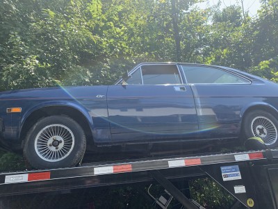

Hello all,
In my intro thread, I mentioned that I'm a US-based owner of a 1974 US market Marina GT.
This car appeared on Ebay back over the summer, and even though I didn't buy it then I made contact with the seller, and it arrived here in Kentucky on Friday.
The story of its arrival is a bit fun, and something that I will write up in time, but for now it's resting while I'm out of town for the weekend. The previous owner did a LOT of restoration work on it and had the exterior looking great but it has sat for 10 years and shows some evidence of that. It's not currently running, but I hope I can fix that by the end of the week.
As a bit of background on myself-I'm 31 years old, and have always had a bit of an interest/fascination with LBCs in general. I'd wanted an MG for years, and bought a 1970 in the fall of 2015. I've had a LOT of fun with that car and it's not going anywhere. Having learned to drive in the mid-2000s on fuel injected Japanense and American cars that just run, it was a bit of adjustment for me but I've also learned a LOT about cars in general and about MGs specifically since buying it. I'm also proud to say that it's only made three visits to the shop in that time-one was to fit a new top, one was to rebuild/restuff the seats, and finally to fit new tires. I've had the engine out(with help) to change the transmission, and am planning an engine rebuild and overdrive install in the next year.
The Marina is putting together a couple of desires. I'd shopped Morris Minors pretty heavily as a somewhat more practical(meaning a usable trunk and back seats) LBC to supplement the MG, but the right one never came along. I'd know about Marinas for a while, but they're quite uncommon in the US, with the number of surviving examples estimated at "around" 2 dozen. The larger size, somewhat newer design from a Minor, and shared engine with the MGB all appealed to me. So, after a few months of dragging my feet, I have now now parked next to my MG.
With the carrier issues in getting it to where it needed to go, I made a bit of an emergency effort to start it with a jump pack and ether, but it was a no go since it wouldn't spark(a coworker bailed me out with a tow strap hooked to his minivan and me steering and braking, plus some grunting for the final few feet, to get it in place). At least I know the engine is free given that it cranked fairly well, so I think I just need to track down the spark to get it running. I'm also afraid that the parking pawl MAY be broken, but I can deal with that if it's the case.
I can't do anymore on it until tomorrow, but I do have a fresh battery ready to be installed(the old one showed fully open circuit when I tried to charge it, and I was a bit afraid to try pumping 20V+ through it to see if I could break through any sulfation, especially since even if it had come back it would have been at seriously reduced capacity). I'll try a clean up on the points, but have a new set of points/condenser, a new cap, and a new rotor on the way. Unfortunately, since it's a 45D and not a 25D, I didn't have that stuff on hand.
I'll update this with my progress. Once the car is running again, I can drive it to the sheriff's office and get a Kentucky safety inspection-something that's a bit of a joke. They charge $5 and it takes less than 5 minutes while they check headlights, tail lights, brake lights, turn signals, windshield wipers, and the horn(you sit in the car and activate all of those things when they tell you). I'll have to risk driving it there on expired registration, since they won't come to me unless I have a minimum of two cars for them to inspect. Once that's done, it will be ~$50 to register it on historic plates and go from there.
I'm excited about getting this one back on the road!

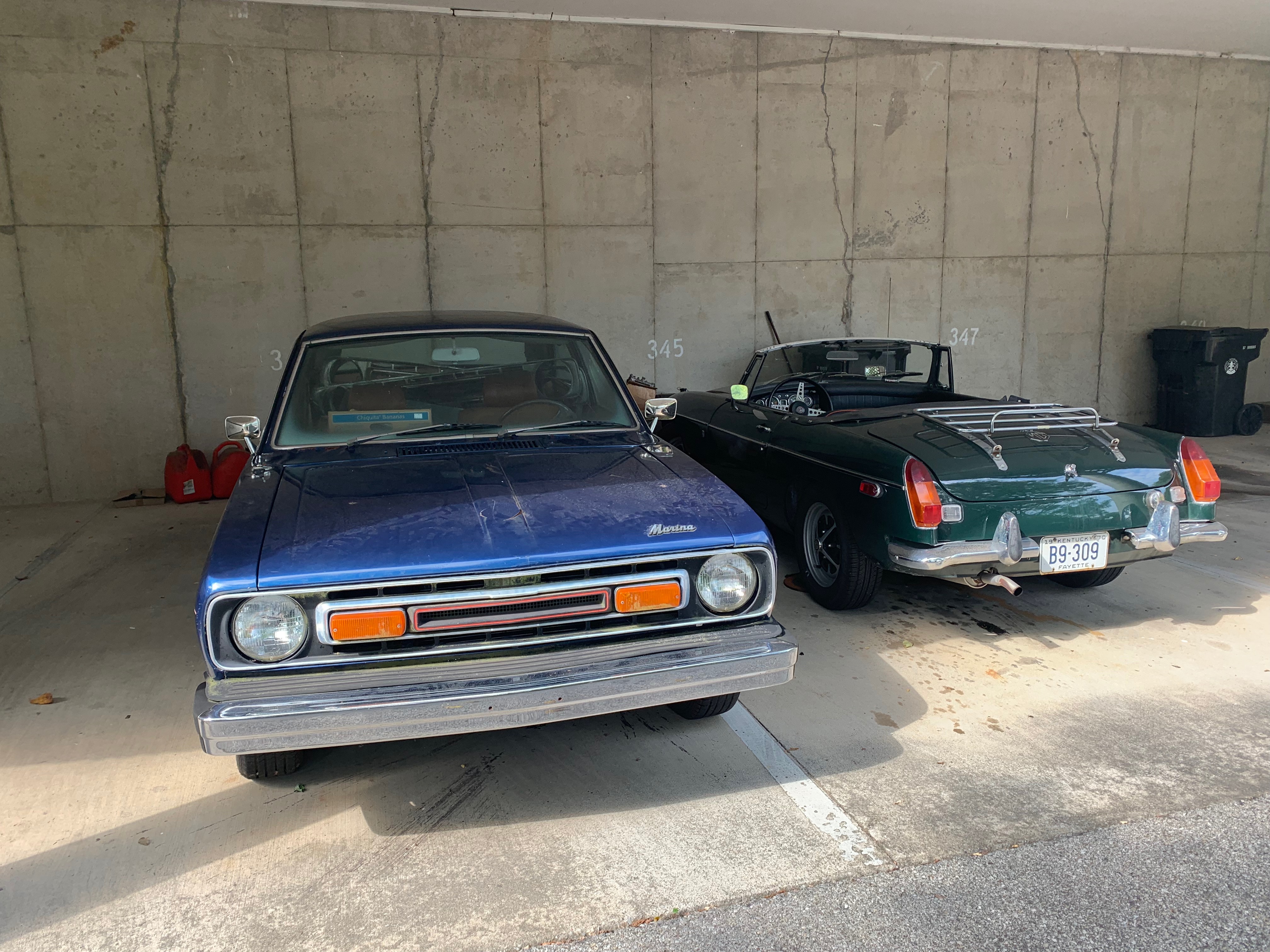

Welcome, that looks really nice and solid. I don't like those huge US spec bumpers though, our slim MK2 ones with the rubber strip and over riders suit the cars much better.

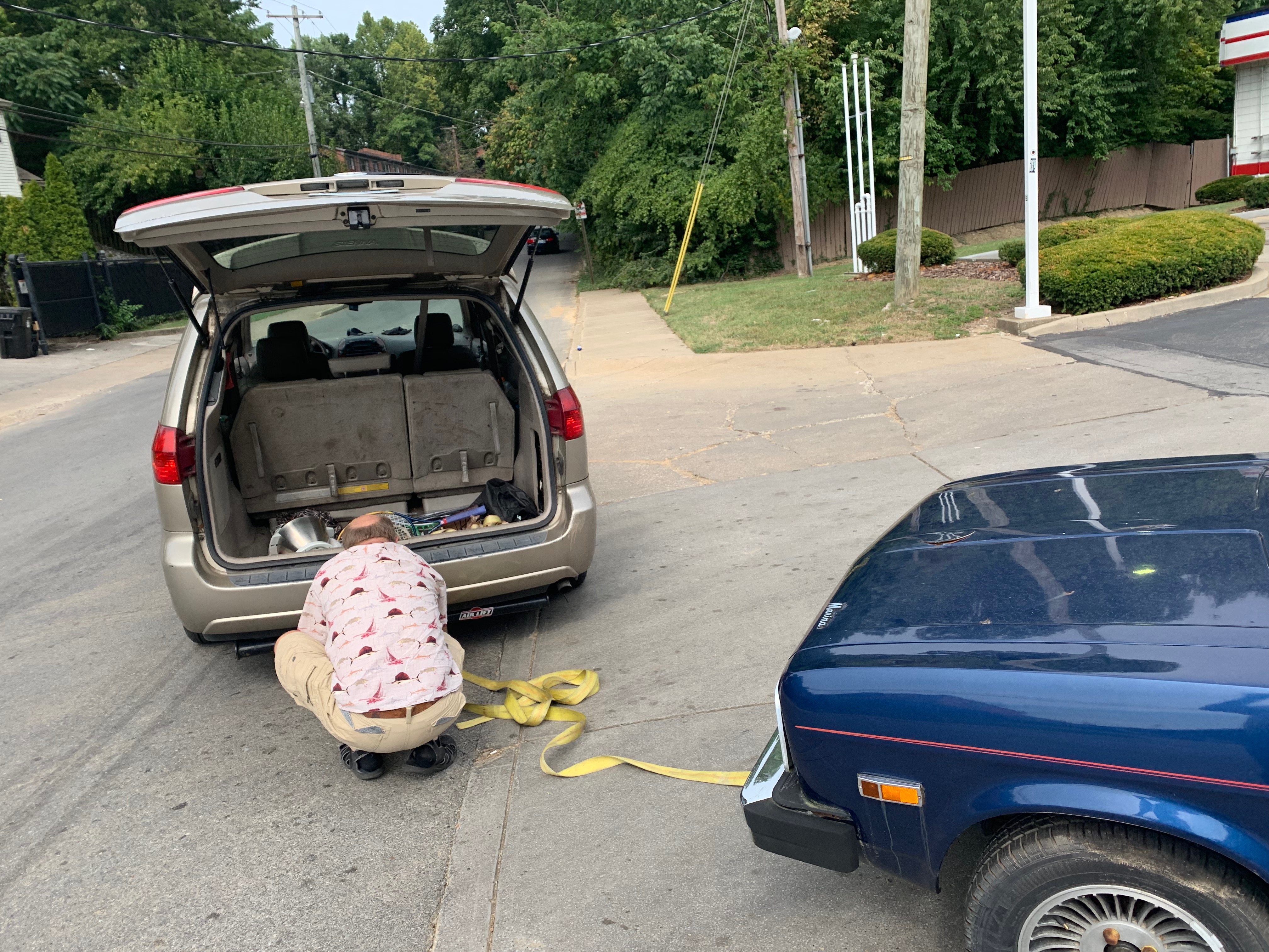

I was feeling adventurous and decided I'd go for a drive. I went to put it in "D", and felt the shift lever come loose from the linkage. I tried to get at it from the top, but couldn't see anything. Finally, a bit of digging through the service manual showed me how the linkage works, and I was able to get at it and reattach from under the car. I also figured out how to change gears from under the car using my hand or a screwdriver(if the exhaust is hot) if need be.
So, after a big of complaining, the car finally moved under its own power for the first time in 10 years. I did a few in and out trials of just moving a few feet, and then decided to head out to the road.
My normal road test is up a fairly steep hill about a half mile long right behind my house, and then a trip back down. It made it up to the hill and turned around, although I DEFINITELY noticed that the transmission was a bit sluggish to respond to what I wanted and a bit hesitant to downshift(I'm wondering if I need to look at and adjust the kick-down cable, but that's a job for another day).
All was going well, but I had to stop at the bottom of the hill to open the gate. Just beyond the gate is a moderately steep hill that I have to get up to park. I couldn't get the transmission to cooperate for getting it up the hill. If I pushed back a bit to get a bit of a start on flat ground, it would go, but only make it a few feet before stalling. Someone offered to help and I had them step on the gas while I pushed, but that didn't do anything. Finally, I managed to attract a crowd of about 6 people, who helped me get it where it needed to go, although that was quite a job(never actually successfully pushed a car up the hill). Somewhere in there, the lever also came loose from the linkage again, but knowing where the lever on the side of the box was, I was reaching up under it to get it where it needed to be.
So, with the car back in place, I'm stuck with a running car that won't move under its own power. I'll look at it again after work tomorrow, although probably after a stop to pick up some transmission fluid. Automatic transmissions have always been something of a magical black box to me. It seems that one of two things(or possibly both) are happening-either the torque converter is slipping up to very high RPMs, or it seems reluctant to engage first. Reverse is a bit reluctant also, and the service manual gives a few nicer sounding options for that situation than if it was only one gear that was reluctant.
I did check the fluid a few hours after driving when it was more or less cool, and it was a tiny bit below the lower "cold" mark on the stick. With that said, it was a nice bright red and had an "oily" smell and not burnt. I really wish this was a manual right about now-there's not much question about whether or not that works.
Also, once it warmed up and pressurized, the upper radiator hose had a previously invisible split open up. I've written Skip to see if he has a replacement or knows a cross reference, or failing that I'll take it to the auto parts store and find a flex hose of the same ID and length-I know I'd lose the fill port in the hose, but at least I'd have it.
At least I'm getting somewhere with it, though, and as I said it did move under its own power.
