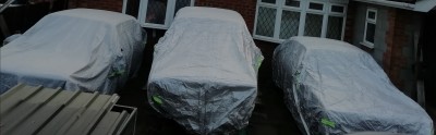

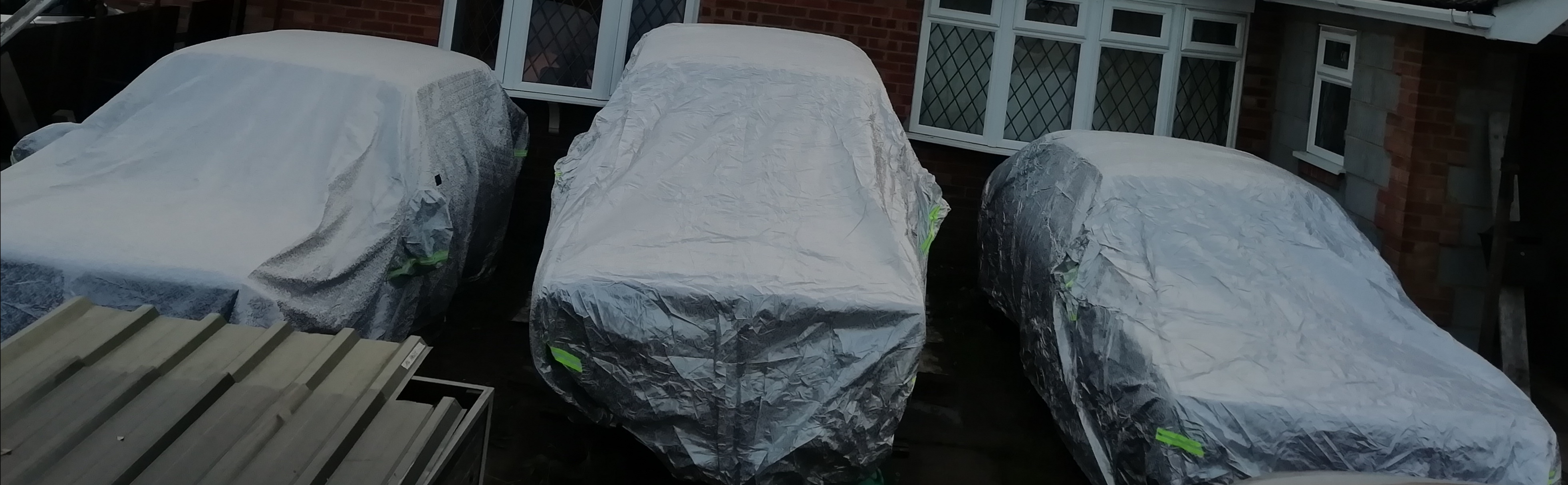

I can't see myself getting much done on these over the winter, apart from the doors and exhaust on PDA which will keep me busy enough until spring with everything else going on and it'll be a couple of good jobs off the list :thumbup:. REW will be pulled out every now and then just to keep it going, but I can't do much with it till the seat is back :lol:
So I bought them a present each and they'll be all dry with VGV, well as dry as they can be, over the winter :thumbup:

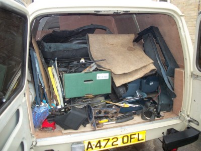

Used the van to pick up a load of stuff for my metro project
