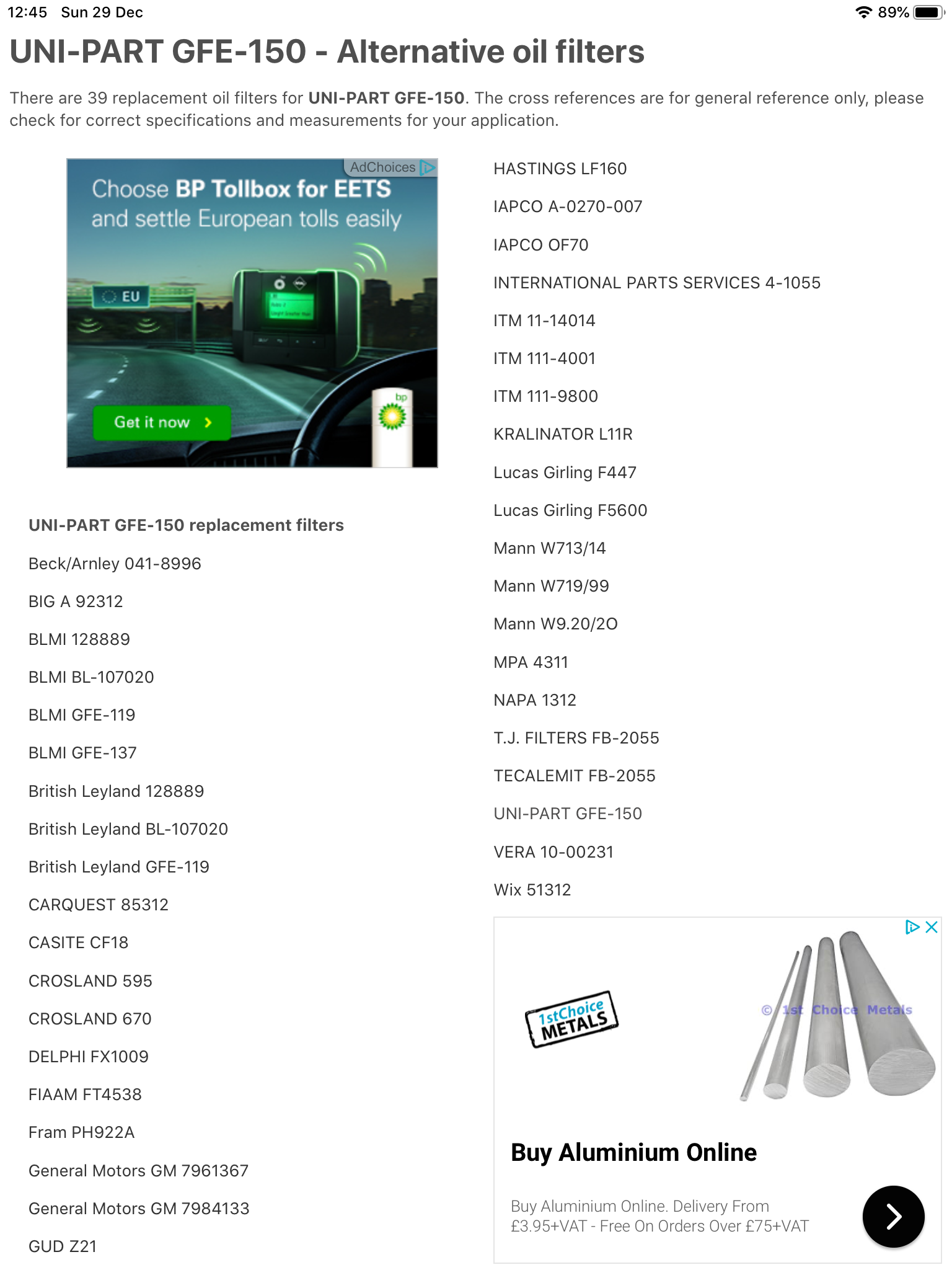

Post by MarinaCoupe » Sun Dec 29, 2019 12:48 pm
The original A-Plus oil filter was Unipart GFE 150, used on various other BL cars including Spitfire 1500 and Midget 1500. Here is a compatibility list lifted of the net.

Post by david painter » Sun Dec 29, 2019 7:50 pm
As Chris says GFE 150 is the original Unipart number. Genuine supplies of this seem to have long since dried up. ebay do have a few plain white filters listed as GFE 150 how good they are is anyone's guess. I have been using a Mann and Hummel W 713/14 on my Brown Coupe.
