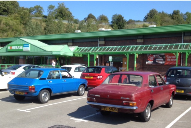

Popped to my local Homebase today and parked up near this Allegro VDP! What are the chances of that eh?

Where I live not much chance, all the local branches of HOMEBASE have closed down.ScreamingLordStokes wrote: Mon Sep 14, 2020 9:05 pm Popped to my local Homebase today and parked up near this Allegro VDP! What are the chances of that eh?
Ian
- Posts: 1130
Where I live not much chance, all the local branches of HOMEBASE have closed down.marina1300coupe wrote: Tue Sep 15, 2020 5:55 am [quote=ScreamingLordStokes post_id=105540 time=<a href="tel:1600113905">1600113905</a> user_id=1727]
Ian
[/quote]i
I'm not surprised, it is a pretty horrible place, well overpriced in my view. I only go under protest when the Missus wants some plants!

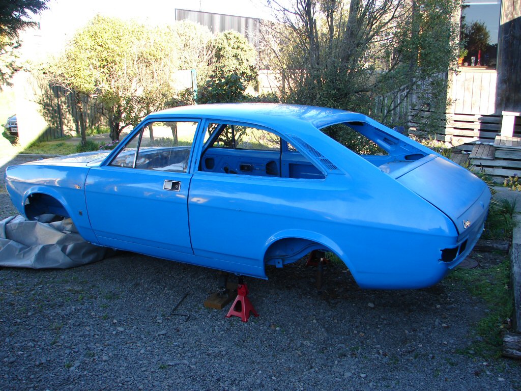

Today I removed the incredibly heavy rear axle and springs from my Leyland coupe shell.
It has the Leyland 6 setup with twin leading links to stabilise impending gobs of torque, and the link arms are made of light alloy, but the rest is massively heavy compared to the UK rear axles that I am used to.
So its all going and I will use UK suspension instead.
But here is the cool bit.
Even though this coupe is from 1976, it appears that the mounting points for the link arms are in the same place as the mountings points for the late type rear ASB's are.
They are visible in this photo..
These have an outer bracket with a captive thread welded through the outer wall of the chassis section, but the bracket wraps right around the inner side as well, so I figure I can drill through the captive thread and through the inner plates and then anchor the late type ASB from the inside out to the captive thread.
This is a great discovery and it has made my day.
Until proven wrong maybe, but I think not...
