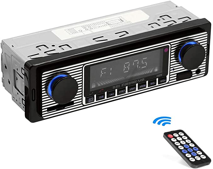

When searching "retro car stereo" on google/ebay/amazon etc this unit seems to alway come up first. I contemplated it for a moment but its just not right. These are incredibly cheap at £20-£25 dependant on where you shop, the problem is they also look incedibly cheap and garish.

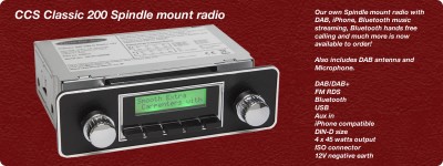

A bit of further research has brought up this unit "Classic Car Stereo CCS200" this is far more in keeping with the Marina's dashboard and it has all the features you would expect of a modern unit plus it has the added bonus of DAB radio. It will require a separate DAB antenna which is included with the unit but I have yet to find out what it looks like and it suitablity to blend in with the Marina. The cost is also considerable more than the cheap unit at £190 but it does look to be a better unit.

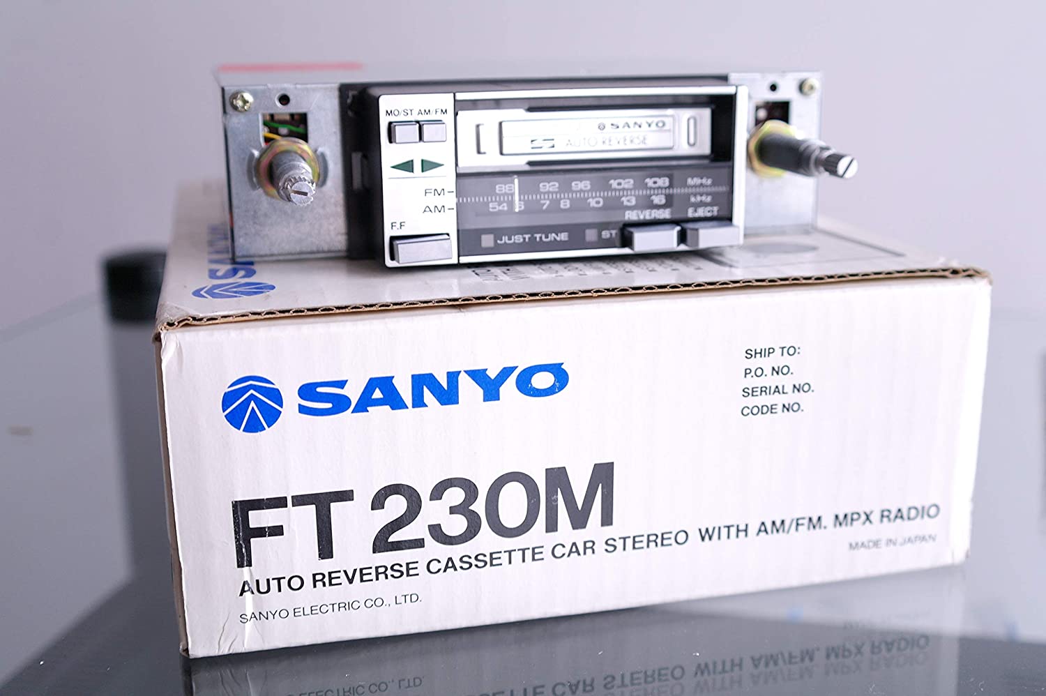

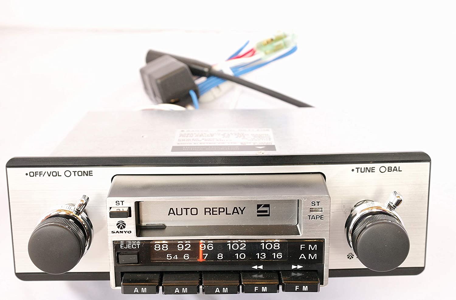

I have also turned up a couple of NOS spindle mount Sanyo radio cassette players on Amazon. I do like the look of these and as they have FM radios then would be fine for most of my listening needs and could they work with the Bluetooth/FM devices for playing music off of my phone?
£135 with auto reverse! Remember when that was a big deal?
£175 and this one has auto replay (whatever that is).

I have one of the super cheapo units in my Stag. It does exactly what it says on the can, but it does look a little glitzy. I have been thinking about keying the ribbed chrome plate and spraying it matt or silk black.
Re: A question or two for josh (radio related)
Yes Chris I think less bling on that stereo would improve its look. I am always wary of things that seem to be too cheap for all that they promise. Good to know that it is actually an ok unit and works as it should. I still don't think it is right for my car as it fits into a DIN size hole which would mean a lot of cutting to get it into the dash but may well consider it for another project in the future.

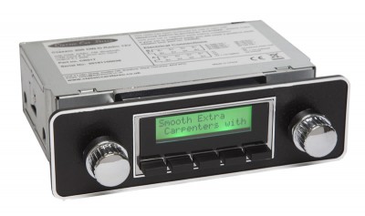

I follow a company on Facebook that retrofit stereos, but couldn't and still haven't figured out what they are called here in NZ. But that image was just from an internet search, looks like there's many options for those in the US as that's where it was from.
