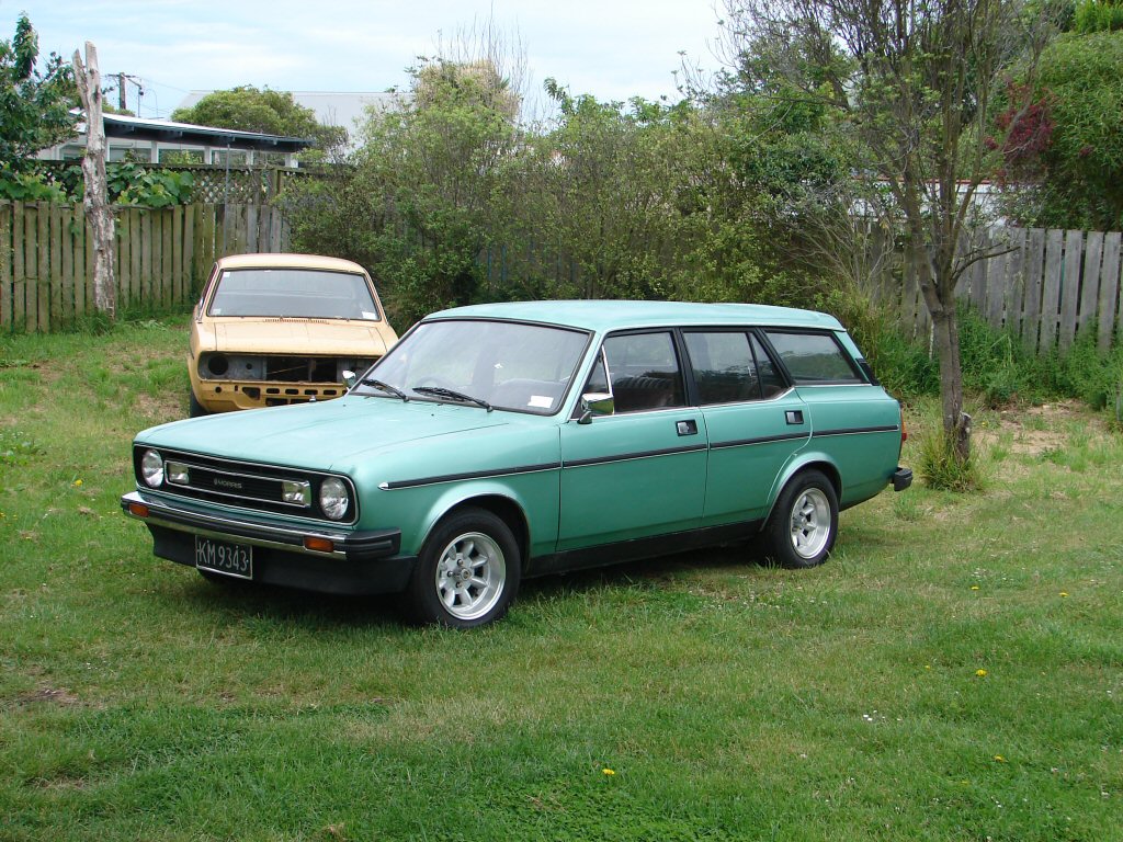

I have used quite a few lowering blocks over the years, and I had them made locally. They also made the longer U bolts for me.
At some point I decided to try just having the springs reset to give the same effect, so this was done to two sets of springs, also 2".
This led to two problems.
The first was that the springs stopped behaving like springs, as they could now go inverted on full compression and lost their ability to work properly.
The second was that some rear shock absorbers were a bit longer than others when fully compressed, and the suspension bottomed out on the shock absorbers, actually snapping two off their mounts.
With lowering blocks the shock absorbers remain at exactly the same extension as standard, only the axle is raised.
I have seen blocks made from 2" square section steel, with open ends, a bolt in the top and a hole in the bottom.
The blocks cannot migrate in any direction as they are effectively pinned top and bottom, plus the U bolts locate the sides.
Cheap fix...
This estate has 2" lowering blocks fitted..
Cheap fix...
