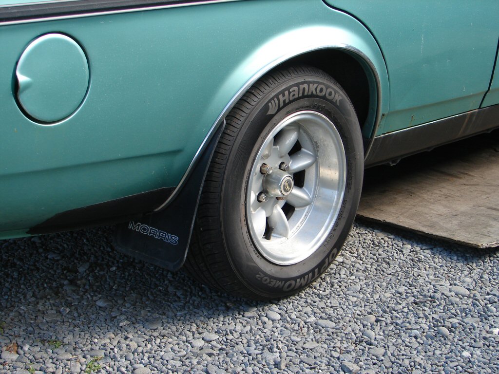

Any chance of a close up shot so I can see the tyre profile, Kilroy? Ta!

Post by Kilroy » Thu Mar 18, 2021 9:17 pm
The 205's also make contact with the inside lower edge of the front guard, but that has more to do with the fact that these Superlites are 7" wide with 100mm backspace - which is the minimum required to clear the suspension upright - so the outer edge of the wheel rim is further toward the edge of the body, and the wheel now rolls further fore and aft when turning.

Post by Bazmatronic » Fri Mar 19, 2021 3:21 pm
Kilroy wrote: Thu Mar 18, 2021 9:17 pm The 205's also make contact with the inside lower edge of the front guard, but that has more to do with the fact that these Superlites are 7" wide with 100mm backspace - which is the minimum required to clear the suspension upright - so the outer edge of the wheel rim is further toward the edge of the body, and the wheel now rolls further fore and aft when turning.
Thanks Kilroy, and great info too. I have to say those rims look great on your estate! I’ve purposely opted for these 7” rims so that the arches are properly filled with wheel/tyre, as I feel that standard rims, even the wider TC rims, still sit too far under the car and it all looks a bit odd.

Post by Kilroy » Sat Mar 20, 2021 12:15 am
Strangely enough, you will also find that the rear axle is not mounted centrally in the body.
With my Superlites and these tyres, the left rear wheel arch will make contact with the outer edge of the tyre on full compression.
The cure is quite simple, as there is a fold on the lower edge of the arch which extends maybe 3/4" inwards, and this can be tapped upwards and is not visible externally.
