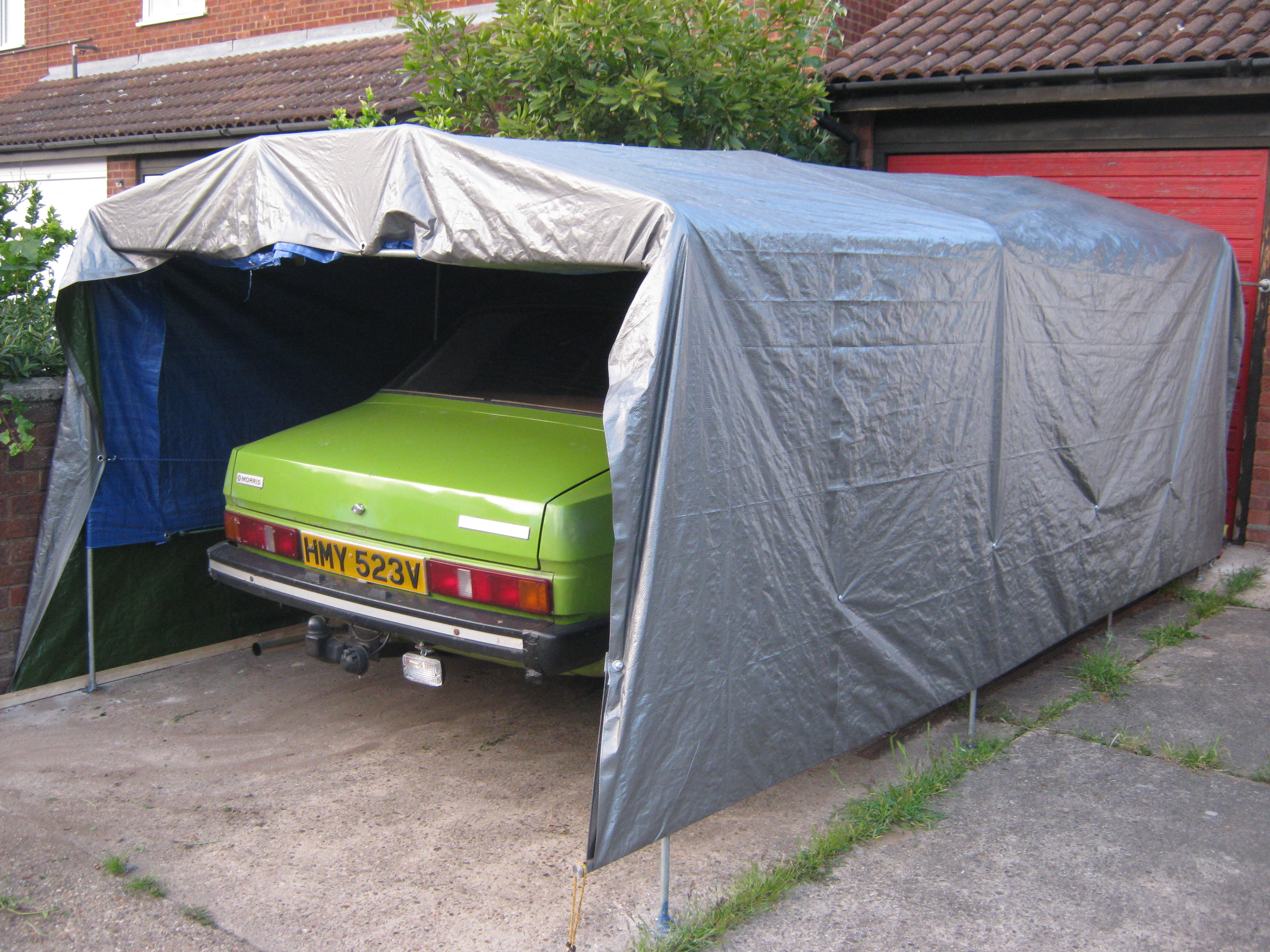

Post by Mandator » Thu Jun 02, 2022 9:46 pm
Have acquired some Walford Trunnions so when they arrive will get onto replacing the existing ones!
"Kermit the Flog" now has a little home to keep it a tad dryer.
As space is a little limited had to cobble one up from "Conduit"
Post by ScreamingLordStokes » Mon Jun 06, 2022 7:31 pm
Nice garage there! Good to get Kermit under cover (although I thought it might prefer being damp!)
