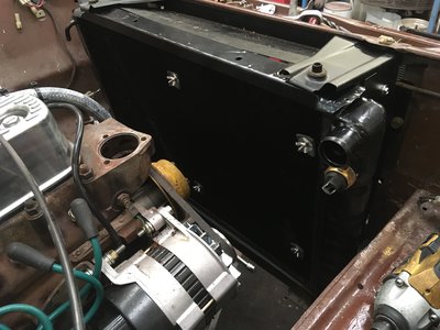

Getting the rad done by DRS in Widnes.
£230. With extra capacity as detailed above.
Double rowed with 10mm gap.

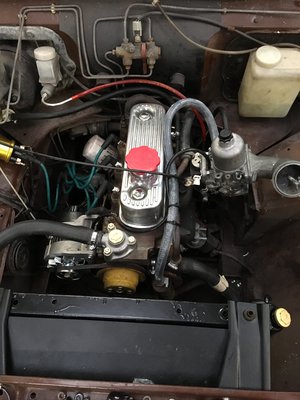

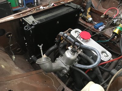

Quick update on the cooling..
So, pending the radiator fitment, yesterday I swapped out the twin pancake filters for an original TC version with a fresh filter and weakend the mixture on each carb by 2/3rds of a turn as it needed to be richer to run smoothly previously. This also enabled me to turn down the idle speed screws to an acceptable level.
Having freed off the clutch and an oil change with a dose of Slik50 I took it out tor a run in 27degree heat.
Pleased to report with cooler airflow into the engine and more vortex suck across each jet its running nicely with the power band spread over a much wider range.
Again the car runs well and at a good temperature on the gauge apart from idling which is now much better with the cooler finer mixture but with the standard rad and fan still gets warm with the electric fan kicking in at 100 degrees on the dail setting . This also kicks in when switching off as the heat rises to the top off the engine but nowhere near as bad as it was.

So, I trialed the new radiator during the recent nationals weekend.
It went well with a wider power band and drove much better, keeping cool in standing traffic and no hint of overheating when stopping after stressful driving.
I binned off the electric fan at the same time. With the original air cleaner and weakening the mixture it's made all the difference and my mpg is much improved also!
