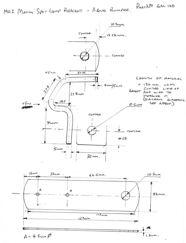

I think Billytits on here had some made up to the BL/Unipart pattern out of stainless steel. Might be worth a PM to see if he has any left or will be making any more.
No, that was me!
And the metal place hated doing them and they were done as a one off - Sorry!
I do have some info on the dimensions and may even have a pair of normal steel ones for sale.

if you give me the dimensions i may be able to make some if needed in stainless will have to look for some materials at work though :)

These were from an original bracket.
The ones I had made were from a thinner stainless steel, just as strong.
The fabrication company hated doing them as the bends were not nice to do and in stainless made it worse.
Trev,
I have got all the cad files for my stainless brackets but I would need your email to send them.
