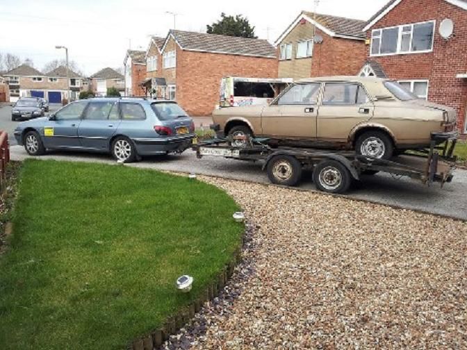

Post by Gee tc » Thu Feb 21, 2013 12:36 pm
Brought this home!
