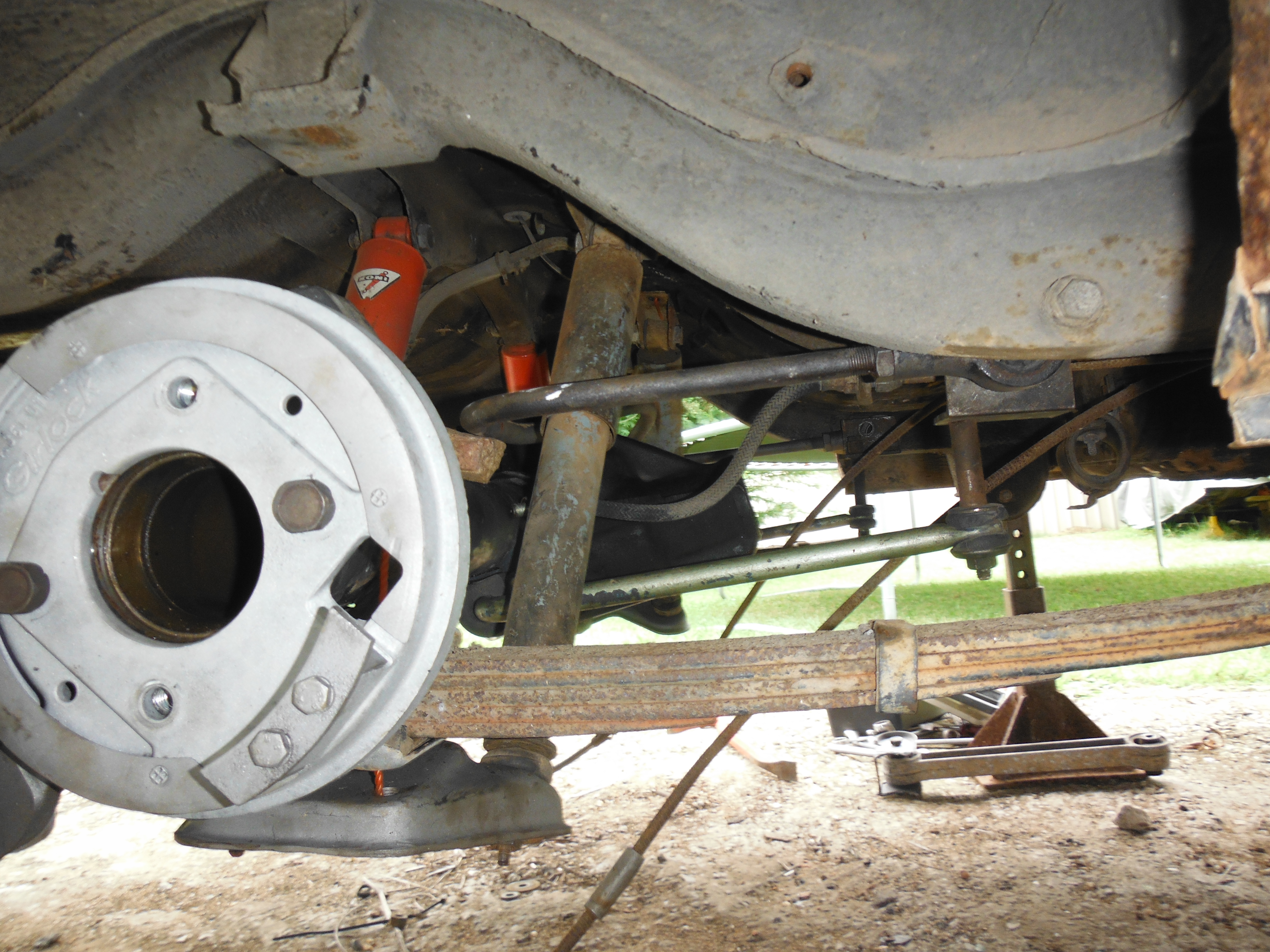

The eye bushes on the ends of the sway bar fit inside the chassis rails.

Tried the UK sway bar,it could work with some trimming of the tubes for the torque rods.
Just make some brackets,more factory jobs ( from Ford ).
Here is some pics
