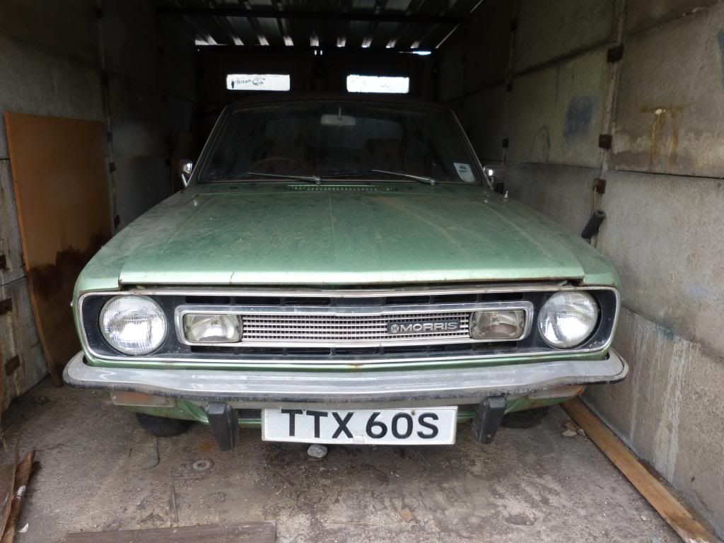

I have had a tidy, very low mileage mk2 1.8 Special Automatic in Jade Green stored since 2002 with the view to giving it a really top notch paintjob some time soon.
However, having had it stored in a lock-up I wasn't anticipating what I've found this week, and as a Marina novice could do with some advice. The garage wasn't the driest but wasn't THAT bad either. Or so I thought

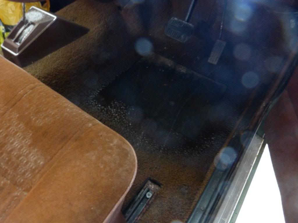

The rear floors are an inch deep in water and, somehow, the previously fine vinyl roof has disintegrated in places. Has anybody how this could happen in a roofed and ventilated garage???
The immediate job is to take it somewhere to dry out over the next couple of weeks, and investigate the damage. If the floors have started to rot, are repairs available or is it a dead loss?

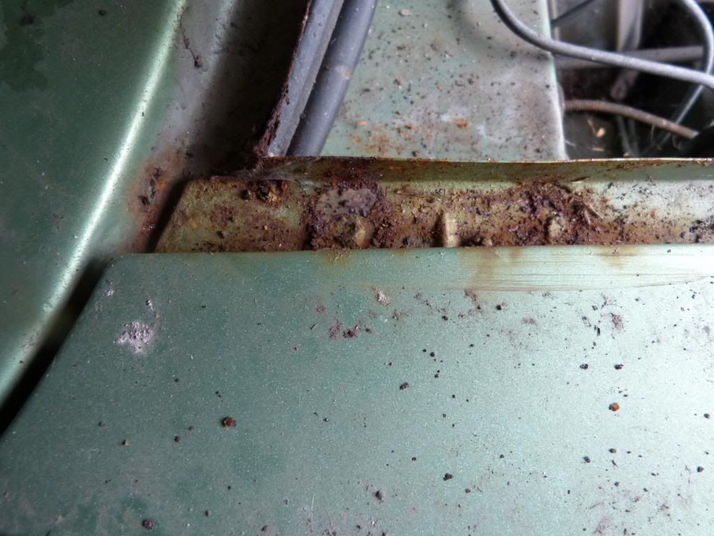

Panels are available through the club, but surely it's not that bad? Rear floors need a lot to rot out but was the floor rusty to start with ? Has the sealer lifted where the inner sill meets? The water would need something to 'latch' onto to create rust/rot.

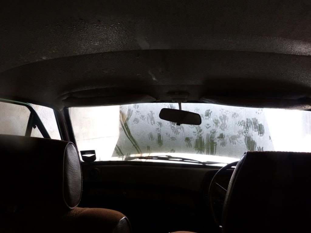

Seriously though, I had a similar lockup garage with a vent in the far end of the garage. Unfortunately it faced into the prevailing wind and would blow in the rain through the vent throughout the winter. I would leave my Coupe a week or two and come back to find bodywork covered in "rain" stains. If left for too long I can believe that the water would get in through the seals. I expect your carpets are sodden from the windscreen leaking through the rubber, down the inside of the bulkhead and into the carpets and floor pan.
It would also explain the degradation of the vinyl roof.

I'm prepared to spend a bit on this car to get it spot-on, but first of all it needs to go somewhere to dry out and examined. I was aware when I bought it of a couple of small holes in the boot wells but that was about it - sounds like it will be a 'windows out' job for sure...
