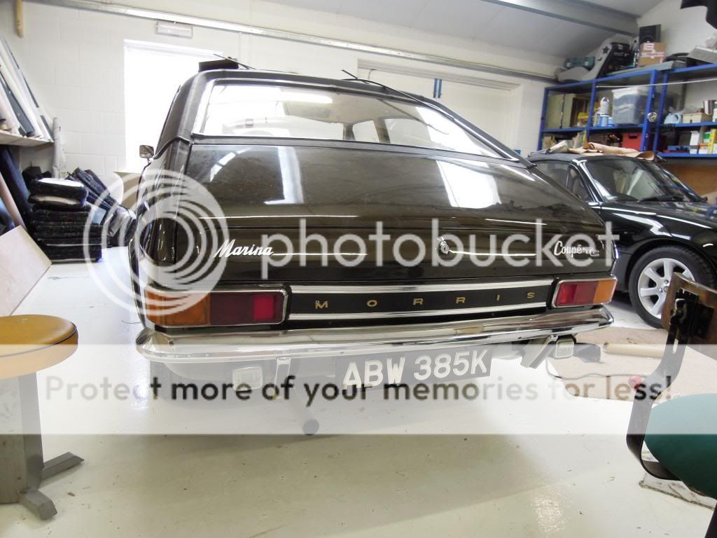

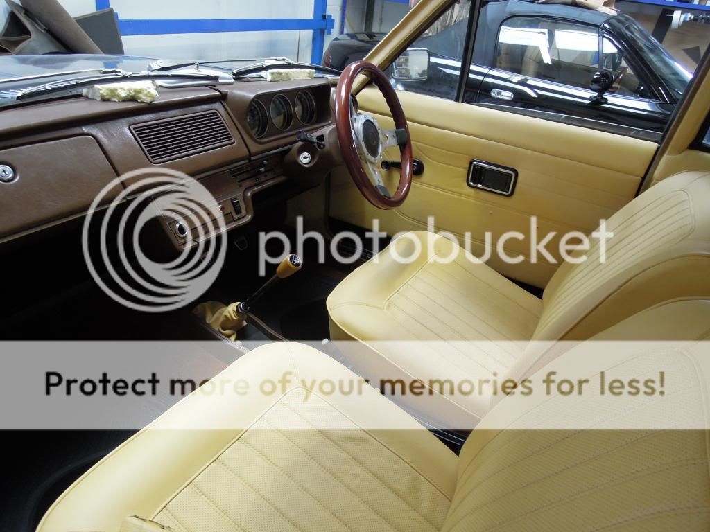

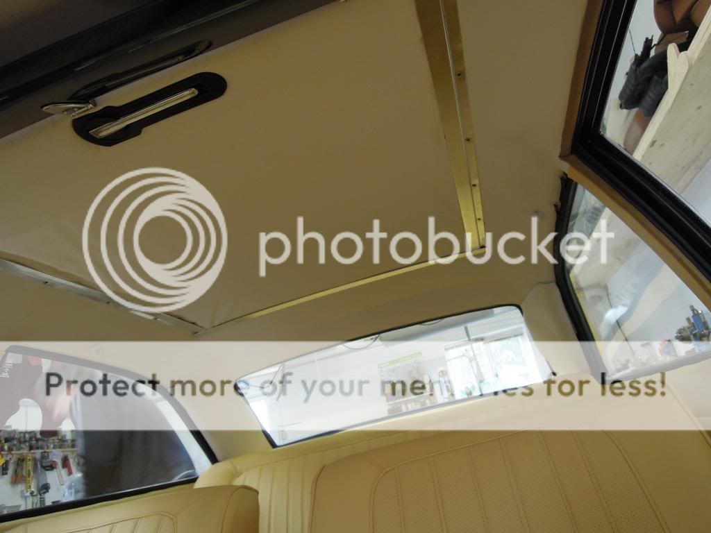

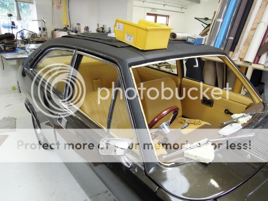

Hi as promised pics of my coupe that's been in for interior work,
This includes new rear screen rubber from mk3 Escort as previously discussed
New vinyl roof
Headliner and webasto retrim
Still bits to do but getting there!! :thumbup:

Post by PHUQ » Fri Oct 04, 2013 5:04 pm
Oof! Those seats and doorcards are lovely 8-)

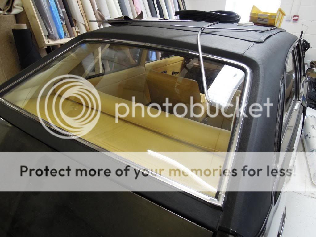

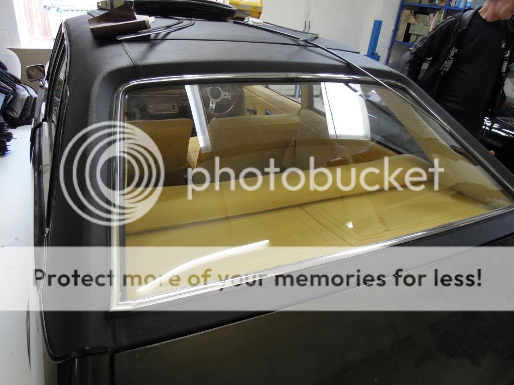

Forgot pics of rubber (rear)
Rear view

Post by JubileeNut » Fri Oct 04, 2013 7:54 pm
Liking that alot :thumbup:
They have made a nice job of the roof and inside trim.
who is doing it and where are they?
Good trimmers are not easy to find.

Post by LIL1937 » Sat Oct 05, 2013 3:01 pm
The rear rubber was made from a mk3 Escort front screen rubber as previously advised by other members (thanks for that!),
It was reduced top and bottom after careful measurement of the glass allowing for a little shrinkage then re glued to seal,
The original stainless finisher was then put in the rubber around the glass on the bench before fitting to the coupe, Its a slow job getting it all in place without disturbing the trim whist loading the whole set back in the frame but worth it to keep the trim original,
It sits in recess very well, but I've noticed the corner trims are a little proud but have been told by the fitter it will shrink a little and may level out! but the whole effect is pleasing I think anyhow,
Just waiting for a new windscreen, its been specially made as they are not on the shelf anymore, when this arrives I've a new rubber to fit and replace the stainless trim again,

Was it re-trimmed in vinyl or leather? Looks loverly, either way. :thumbup:
Is that a standard rear parcel shelf, or has it been custom made? :geek:
