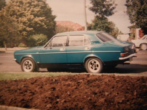

dazza2623 wrote:Got the V8 diff back in with the ventilated discs.Checking road height as well.Almost finished front coil over conversion as well.
I see you have factory P76 wheels - I had a set and gave them to an old guy who has a P76 (surprise-surprise!) and a MArina ute, he is going to (eventually) give me the wheels, dif etc from his ute as it's got all Datsun running gear now.
dazza2623
Posts: 366
Location: Brisbane,AUSTRALIA
Post by dazza2623 » Sun Feb 16, 2014 11:14 am
Yes I have but they were originally going to be for the Force 7v,then when that went south they put them on the Targas.I put them up to the car years ago & was impressed with the look of them on the Marina so there they stayed.
