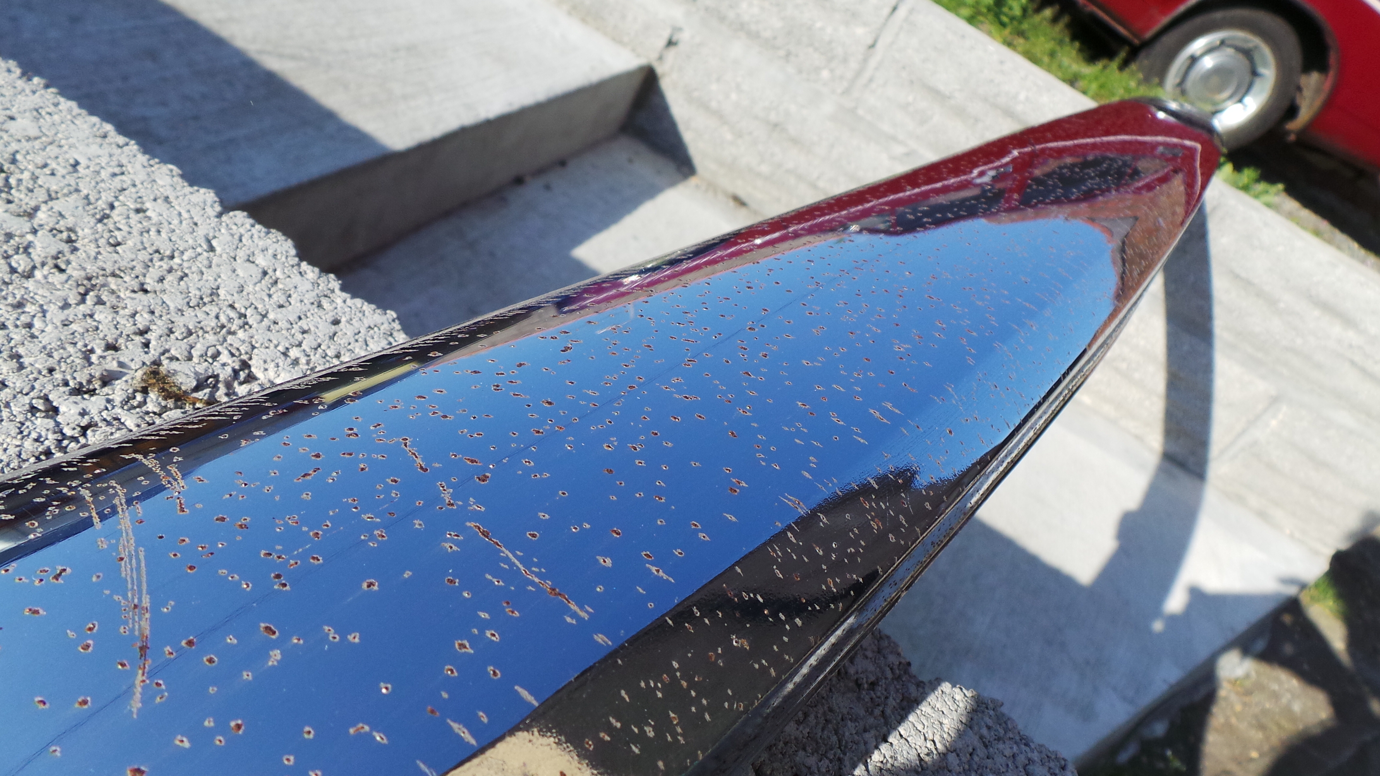

Post by Morris McKinnon » Sun May 07, 2017 6:47 pm
timspencer wrote: Sat May 06, 2017 11:09 pm Keep me posted mate, my rear bumper is quite tired.
Pics as promised Tim. Not sure if the pitting is too far for you but it's straight and solid so could be re-chromed if you chose to do so one day. I had a look for some stainless door trims and I only have four fronts! Typical :rolls:

Re: Too Many Spares!
Post by timspencer » Sun May 07, 2017 8:27 pm
Thanks Gareth it's about the same as mine so will keep hunting .
