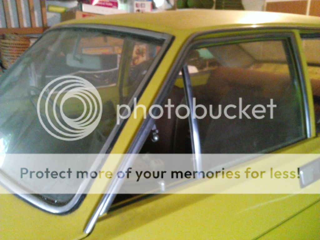

I have a set of cloth seats from a saloon (probably Mk2), but no sliding adjusters. The reclining front seats have a bracket on each side, with a hole at the front and back for bolting on to the sliding mechanism. They've never been fitted into my Coupe, they were just sitting loose on the floor when I bought it.
(can anyone see my photobucket photos?)
Re: Alternative commercial/coupe seats?
Post by Kilroy » Wed Jul 12, 2017 4:21 am
In reply to your photobucket question..
Post by locost_bryan » Wed Jul 12, 2017 5:10 am
Yup, thought it might be. PB have decided to start charging $400 p.a. for their previously free service, so an awful lot of build threads are now broken. :-(
