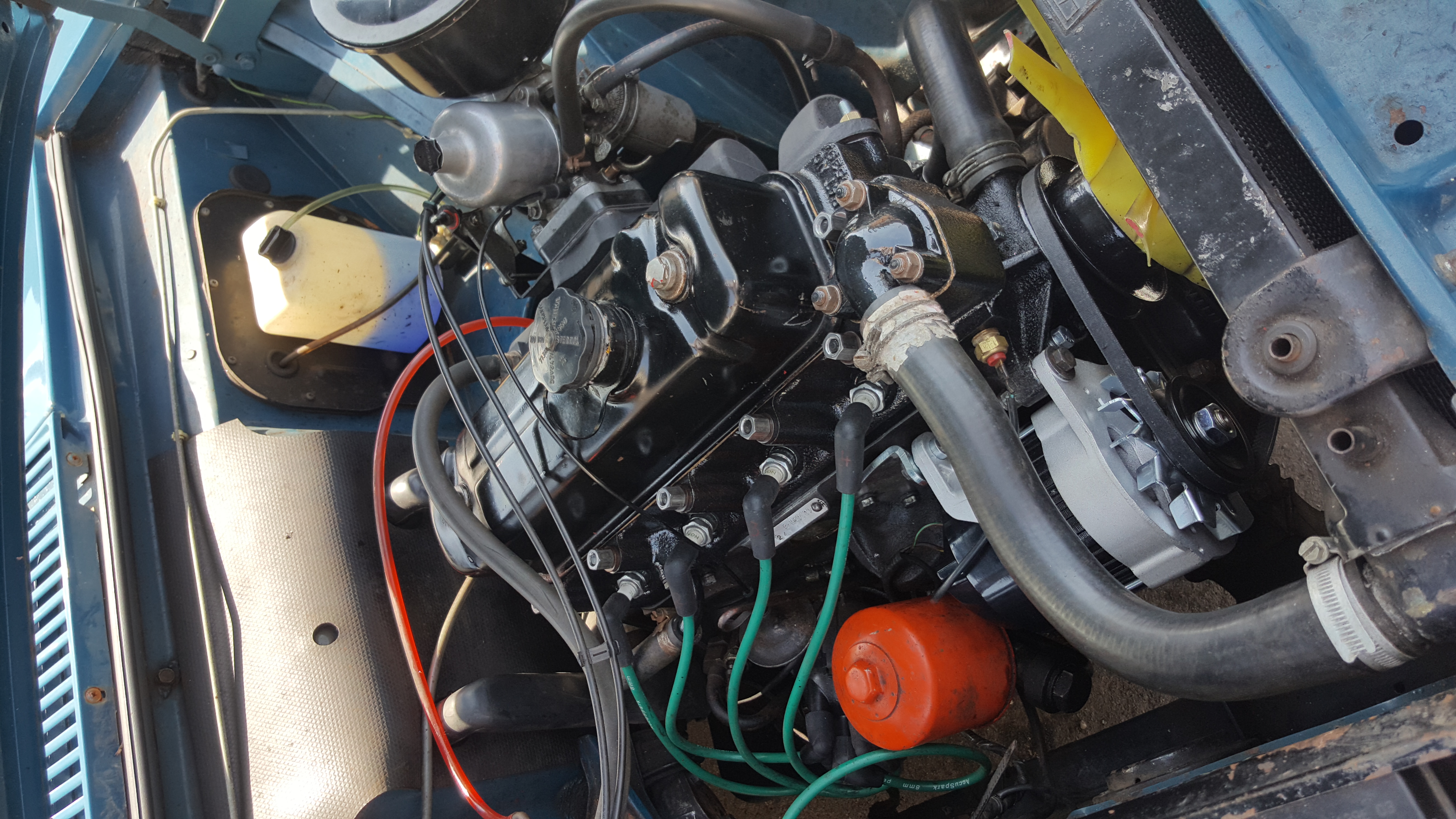

Just thought I would give an update on the progress of GRO, the engine is back together now, and it is looking much smarter than before. I am just getting over the trouble of getting it started now, we have a spark, compression but for some reason no fuel, the carb is really giving some trouble. I removed it today and blew through the fuel line and a lot of crap came out but it made no difference. The most I have had from it is a little wobble as it spluttered a tiny bit but other than that it is as dead as anything! Nothing is ever simple with this one but I'm sure we will soon get there, if anything I'll see if there is an exhange service and fit a recon carb. Here's a photo just to show the results, may not be running yet but at least it looks much more pretty!
Re: Carbon deposits(?) in cooling system
The head sounded like a right nightmare to deal with! Perseverance pays off
Have you checked the pipe under the carb? It has a spring around it to stop it from getting kinked but sometimes the pipe becomes weak and pinches up anyway. It was the reason I couldn't figure out for weeks why my car wouldn't start.

It all looks very smart have you had the top dashpot off the carb and blown back trough the jet into the float chamber making sure the pipe Morris refers to is clear. When you put the dashpot back on make sure you can lift the piston smoothly and freely to the top with ought the dashpot damper in it should drop back onto the bridge at the bottom in under two seconds with a sharp clunk.

Thanks for the tips, perseverence was the key to success on this one, it was a real nightmare and it has had a lot of work done which, now, stepping back and looking at it I'm very pleased with. I've not looked at that pipe in full but I will, there may be a chance that has happened as it was placed in a shed on a bucket of mole traps whilst we did the head. I did notice when I partially stripped it that the fuel would flow through at some angles but not others strangely. Then a load of black sediment ran out of it and it seemed to clear it up although it was blocking the air flow every now and then, a kinked pipe may be likely.
I've not blown back through the opposite way but I will give that a go too, the carb looks pretty original, it's only had a new needle whilst I've had it but I'm not too sure if it has been rebuit in the past certianly needs doing if so. I will see if I can get it going and probably swap it for a recon when I'm not as skint! P.S Dave, the ignition lights are working fine, thanks for all your help with the alternator conversion!
