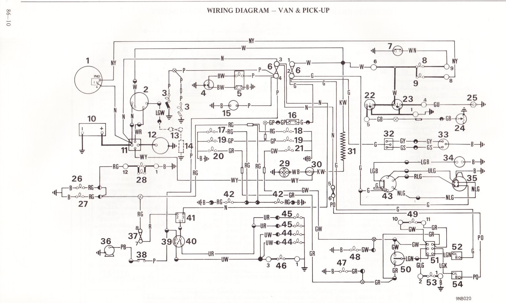

A friend brought his pickup over for me to get a wof for him.
He then mentioned in passing that his fuel gauge/water temp/panel lights were suddenly not working.
I lack a wiring diagram for a commercial - anyone got one they can post please.?
I am thinking fuse or fuseholder, but I do not even know what fuse does what.
I can work my way around it, but a diagram would speed things up a lot.. :)

Here you go
Marina Mk3 & Ital Commercial wiring diagram and key
These are scans direct from the BL workshop manual.

Baz - thanks for the heads-up, and you were on the money.
Thanks to the wiring diagram which informed me that various things that were working got their power from the same source as some that were not, I realised it had to be a connection issue.
It is mid-winter here after all, and this pickup lives outdoors.
Manipulating the wiring loom behind the dash got the fuel gauge going, and it soon became evident that the multiplug was the culprit.
A fair amount of wriggling got me a permanent connection for the fuel gauge, and I then found that the panel lights were also working again.
So that's nice.. :)
