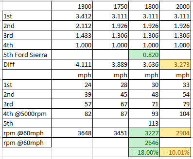

These are the speeds for each combination. Changing from a 3.63 to a 3.27 drops the revs by 10%. As a comparison, I have shown the Ford Sierra 5th gear, which drops the revs by 18%.
Annotation 2022-11-01 125932.png (13.79 KiB) Viewed 29892 times
