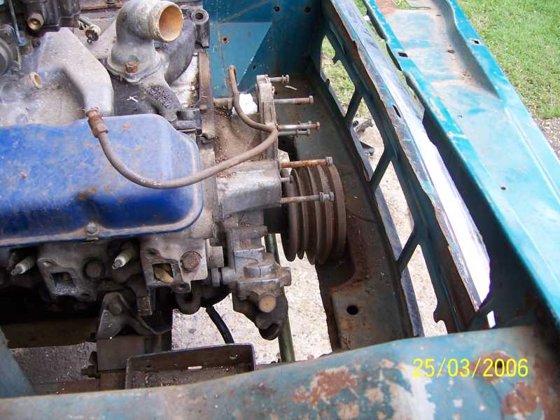

A few shots of Darren (notthatmarinaman) V8 saloon in Oz.
Close to the rack - this is an Oz 6 cylinder originally so the steering rack is 30mm higher I believe. One would assume that in the UK car (depending on G/Box) you may need to cutout a slot in the bellhousing so that the rack can sit without fouling.
Larger front pulley has meant front cross member has to be cut. I'm unsure of the differences between V8's but my P6 motor has a short bottom pulley, an SD1 engine may be different.
Front valance different on the Oz cars (6 Cylinders). UK version with a narrow high capacity radiator in place may not need cutting?
See more at: http://www.ozmarina.com
Regards,
Re: Installing V8 in pick up
yep that's the 4.4 litre P76 engine sitting in there and the pulley is from the executive model that has air and power steer
hence all the pulleys.
the deeper front valance allowed leyland Australia to reposition the radiator down and forward to fit the much longer 6 cyl which only just ft
albeit with an electric fan beside the front of the engine
