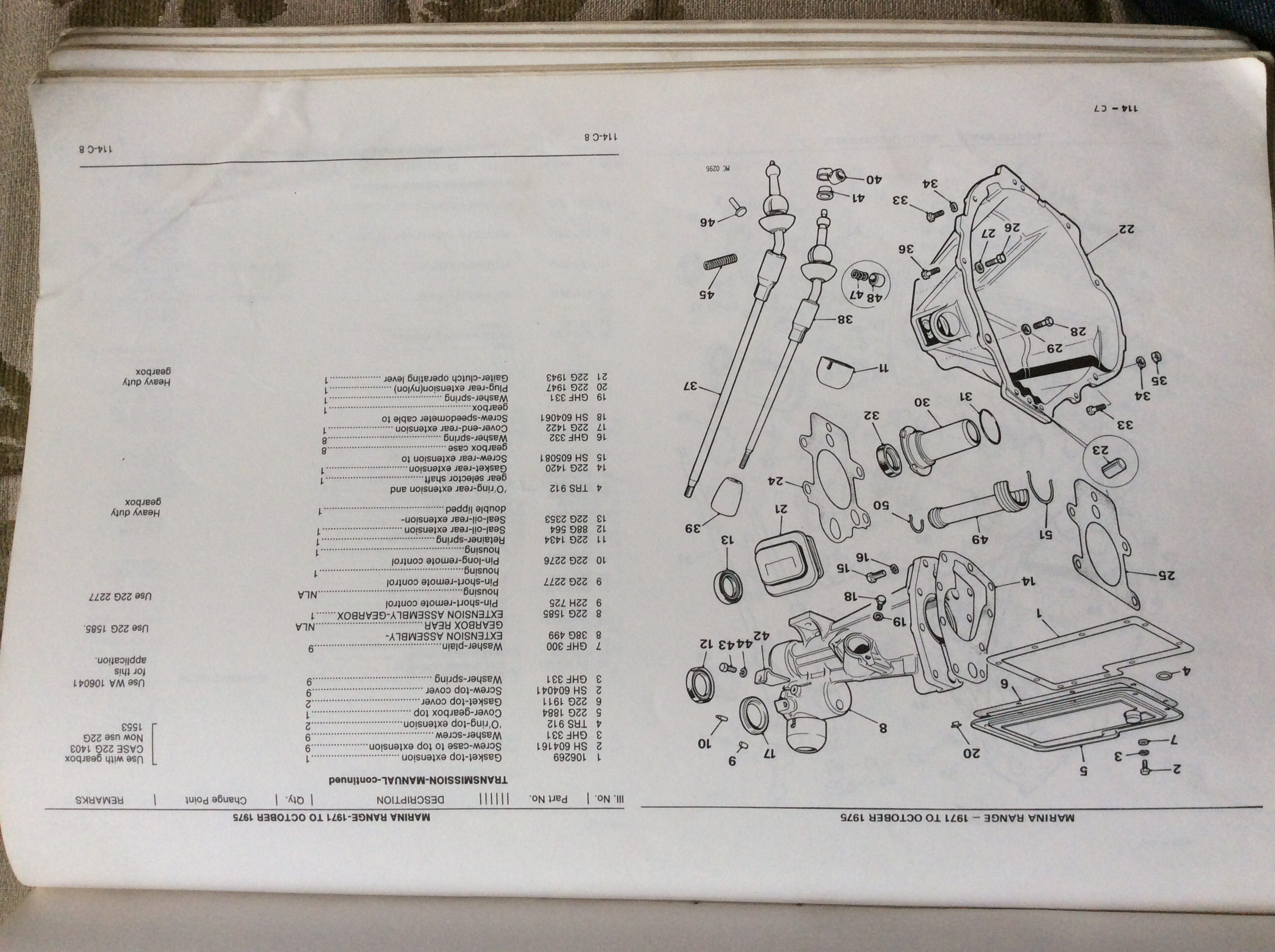

			Found this parts diagram 22g1943, gaiter,clutch operating lever for heavy duty gearbox.

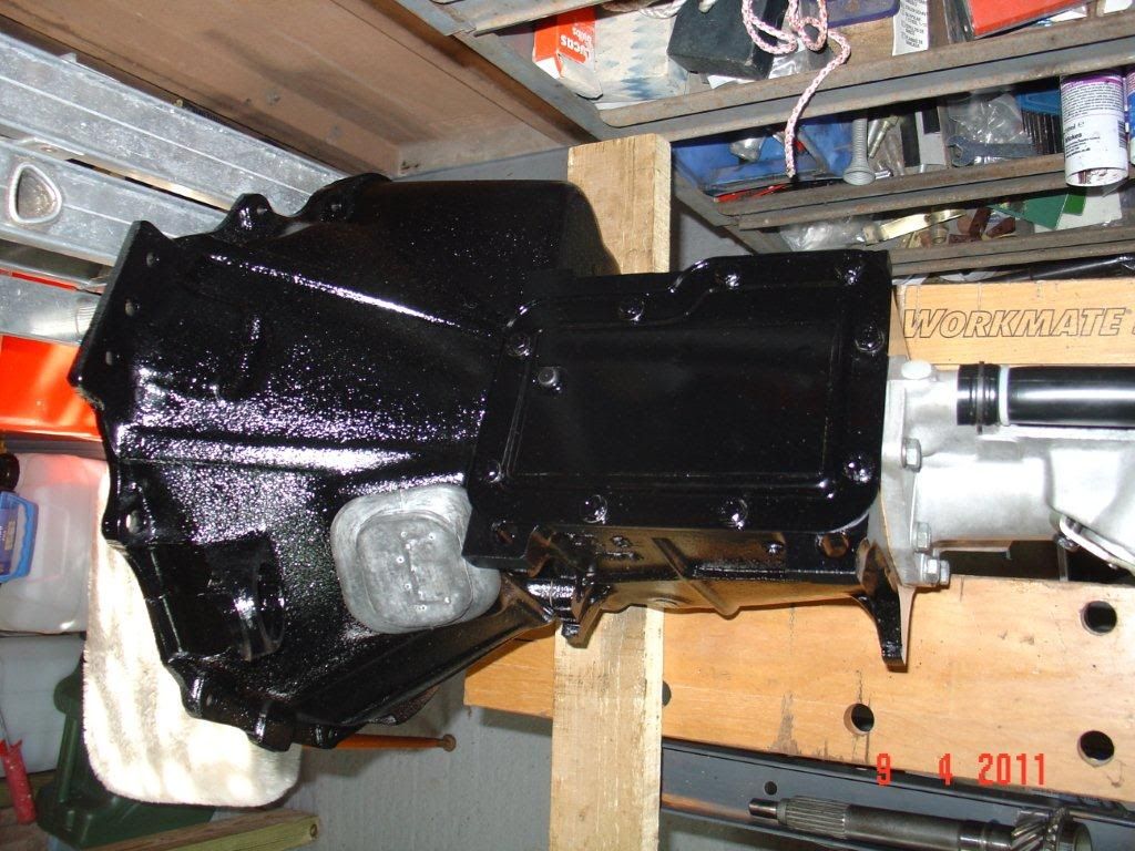

			I know they increased the main shaft size as I have both here and also reverse gear, laygear etc altered with chunky teeth.
- Posts: 10257
						Post
								by MarinaCoupe » Sun May 15, 2016 10:59 pm
			The cage bearing in the back of the input shaft that takes the main shaft, is more robust.  It then got used as the standard in later Mk1s.

			MarinaCoupe wrote:The cage bearing in the back of the input shaft that takes the main shaft, is more robust.  It then got used as the standard in later Mk1s.
My TC had the smaller bearing but I had it rebuilt and 'uprated' with the bigger bearing. Guess it was after '74 they came through as standard?
