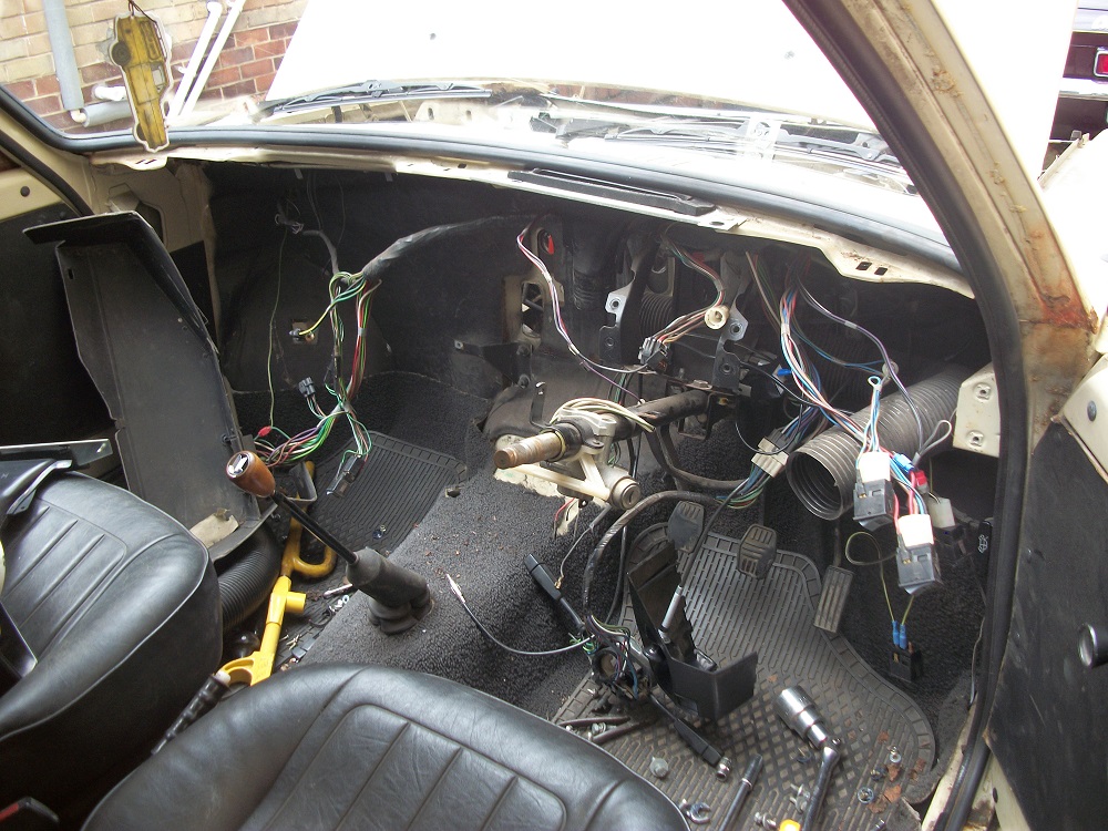

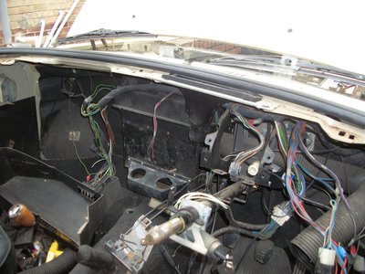

Swapped the heater unit in the van today to replace burnt out blower motor.
Post by Morris McKinnon » Fri Jul 29, 2016 10:36 pm
Well done. Hope my heater motor don't break! Nightmare of a job by the looks of it :o
Posts: 10273
Post by MarinaCoupe » Fri Jul 29, 2016 10:40 pm
Along with a number of other cars, BL hung the heater on a piece of string and built the car round it.
pickup-16v
Posts: 111
Post by pickup-16v » Sat Jul 30, 2016 6:14 am
A lot easier job on the pick up it just comes out with out the dash being removed in the n/s/f foot well
lock1506
Posts: 828
Post by lock1506 » Sat Jul 30, 2016 8:34 am
It's not as bad as it looks to do really, I've done a few over the years. Much easier than when I did the one in my SD1.
