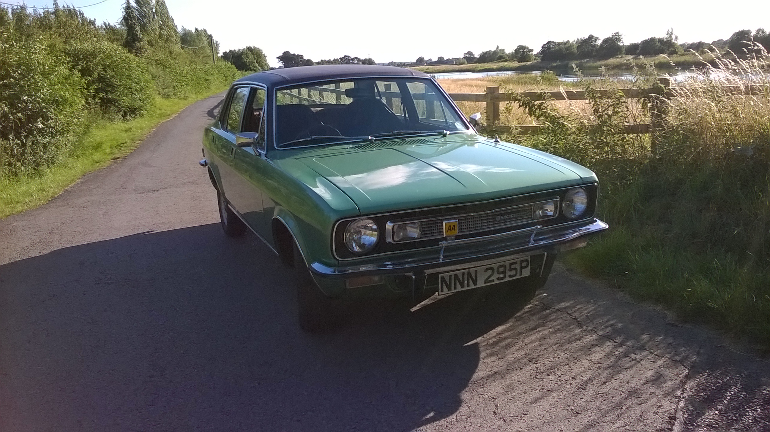

Here are some photos of the old sod not on my driveway, not on axle stands, not with its bonnet up, not with its arse-end poking out of my garage with a sheet thrown over it, but - shock horror - actually DRIVEN somewhere! All of about two miles from home, in a scenic setting, but after a roughly twenty mile 'shakedown' run. Only took a year and three months to become usable. Okay I'm fairly lazy and not 18 any more and don't relish getting my hands dirty every weekend like I once did, but hey, its been difficult at times with this one. And there's still a lot to do to it, like fix the transmission leak, probably replace all the tyres, see if I can have the odd crease ironed out of the bodywork....but it actually GOES now! And I did seem to enjoy driving it.... in fact for a 41 year old car with a reputation for bad road manners, I thought it drove very well. Of course, I didn't try cornering on two wheels like every modern car driver does now....
My voltage stabiliser quit part way through my journey again, but then came back to life after about five minutes. And just before putting it away I put about 100ml of mineral transmission fluid in it while it was hot, to bring it back to just below the 'H' on the dip stick. It was on about half before, which is just what it has lost more or less standing in my garage for six months since the last time I topped it up. At least it wasn't the half-litre I had to put in it the first time I checked the level with a hot transmission, but obviously until I get the leak attended to, I will have to keep a close eye on those levels. Otherwise, the auto transmission appears to be working normally. The car is a bit like an old Supermarine Spitfire on idle until it properly warms up, and even when hot, the engine rocks like an old lady in a rocking chair on tickover. Rev it though and it sounds fairly smooth. And now at least it does appear to have some 'oomph'... I had it up to sixty on the A52, no trouble, but did most of my run on that road at a more comfortable 55mph. And with that new re-cored radiator, even on a day like today, the temperature gauge needle (when the voltage stabiliser works) never reaches halfway.
Anyway, here are the photos.

Well done Mick all that effort has been worthwhile. Now enjoy.
Posted: Sun Jul 16, 2017 8:33 pm
by mickthefitter
MarinaCoupe wrote: Sun Jul 16, 2017 8:12 pm Well done Mick all that effort has been worthwhile. Now enjoy.
Thanks Chris. ;)
Posted: Sun Jul 16, 2017 9:22 pm
by balmy
Love Tara green
