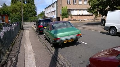

by mickthefitter
I quite enjoyed myself today.
I took it into town while the sun was still shining, a little bit more acclimatisation to the car now that it is actually usable. I didn't get a shot of it parked elsewhere, nose-to-the-pavement in a town centre car park after I'd done what I needed to do here, but somebody else, a middle aged man laden with shopping bags, was staring at it as I walked back to the car. He'd started to walk away just as I reached it and I shouted "You don't see many do you?" and I got the inevitable "Is it yours? Can I take a photo?" We were chatting for about ten minutes. He reckoned he'd not seen one since the 1980s. The man who belonged to the white Transit parked opposite in the photo was smiling, as he drove off looking at it, and when I moved off, a young couple with a push chair were waiting to cross the road where that tree is on the right. They were both looking as I heaved it round the 90 degree corner, and I'd got my window open so couldn't resist saying "It's only like a tank, that's all!" It made them laugh. And I got lots of other glances and stares of almost disbelief as I drove it through town in the sunshine. And that's what I wanted it for when I saw it at auction a year ago.
