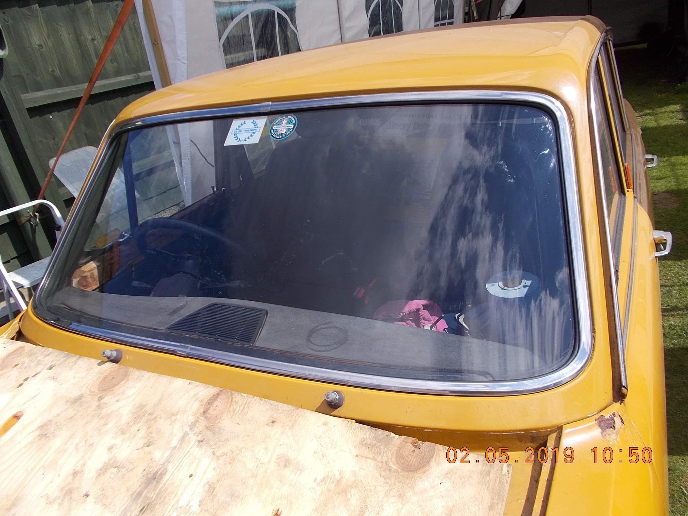

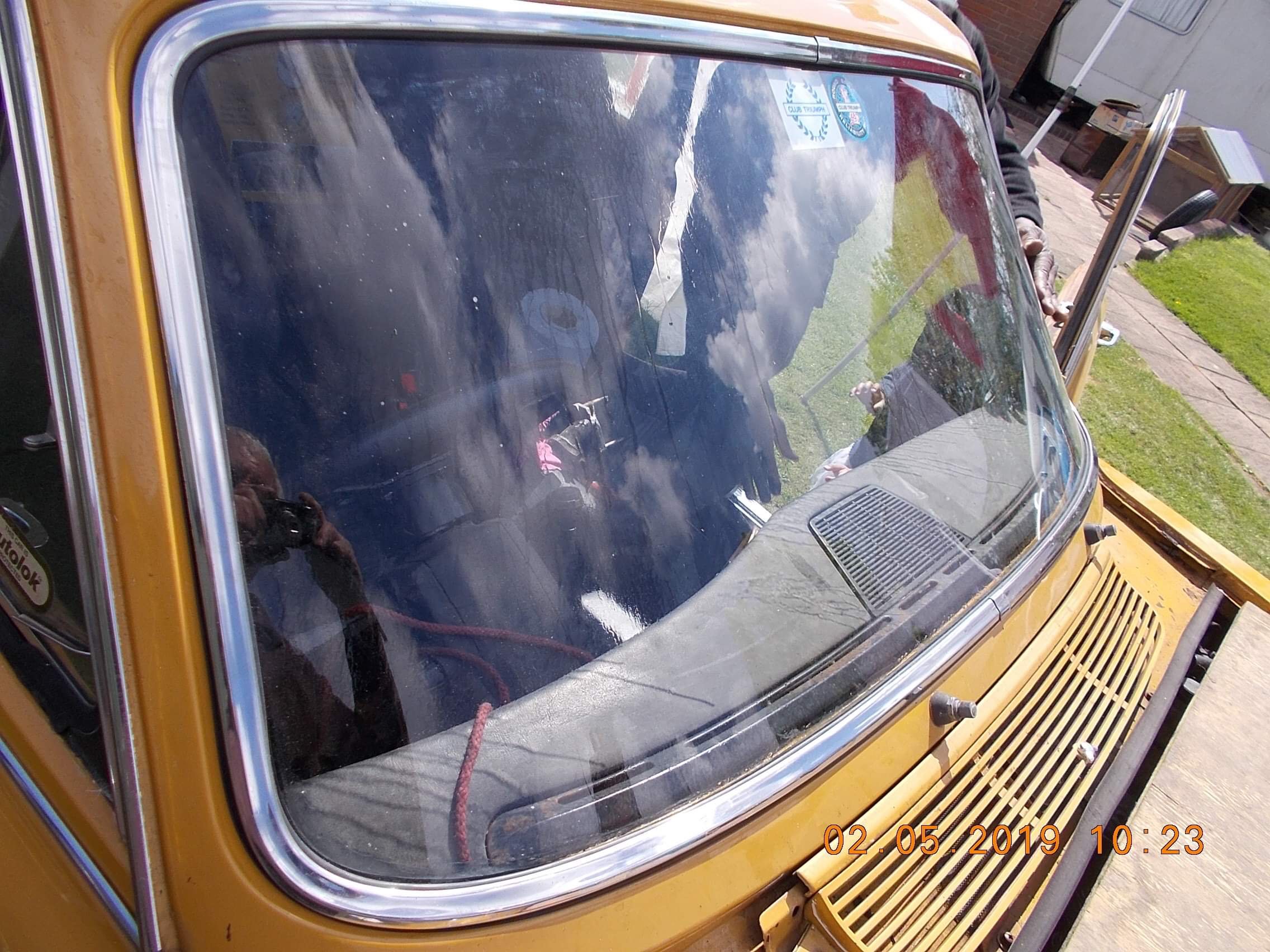

. Yeah I thought the volvo trim looked the same thickness as Marina. Probably triumph as you say
- Posts: 10273
Triumph 2000 Mk2
Nah, definitely not Triumph 2000. The trim I have sits in the rubber, the 2000 looks wider and seems to sit on the rubber looking at the pic. The mystery go's on
The trim is almost identical to the Marina rear window in size and profile but it's not as wide in the rubber, like the later plastic trim but it's stainless.
