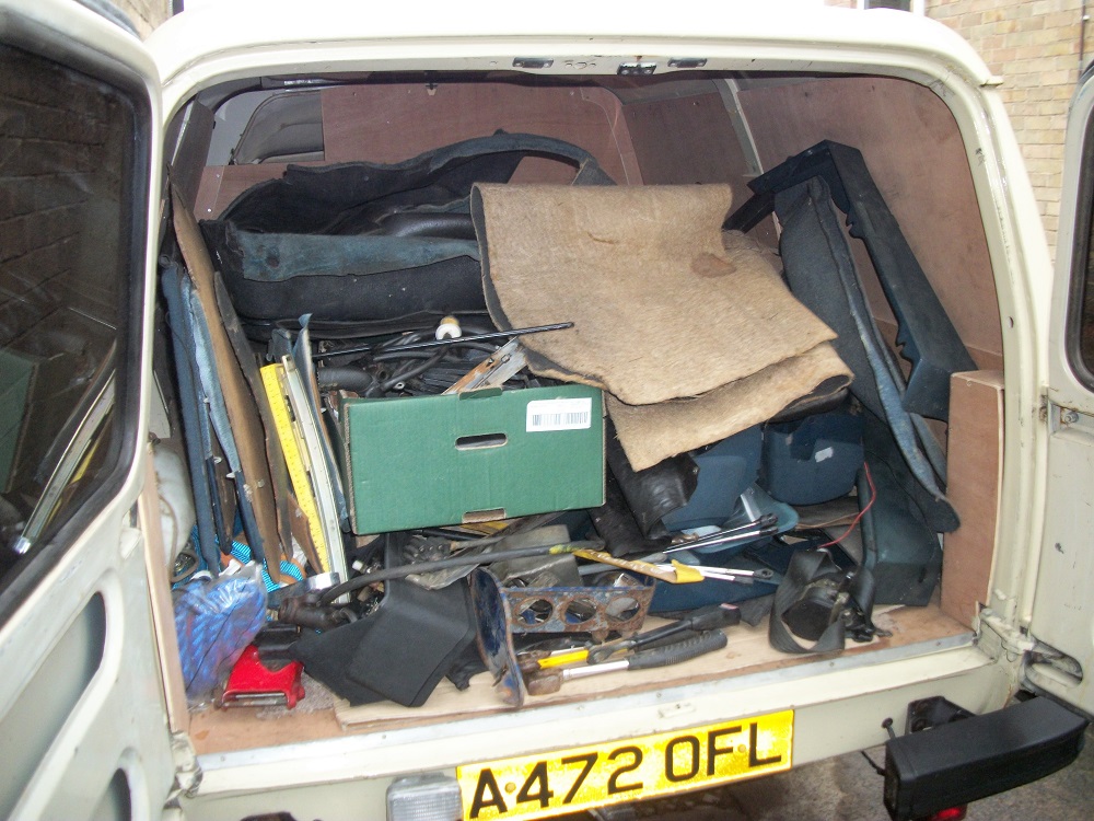

Used the van to pick up a load of stuff for my metro project
