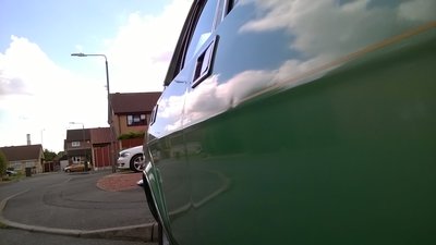

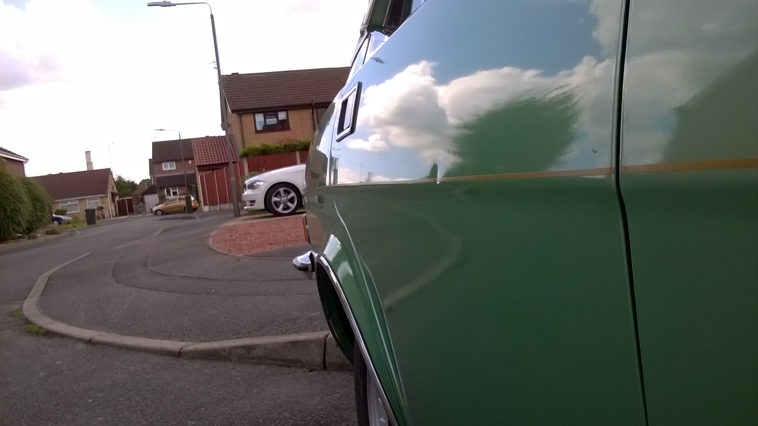

Just taken my old dad to the dentist in the Marina, his first ride. Terminated the ride to swap to the Volvo to take him home because one of the front brakes is starting to bind, and just noticed another chip/ding low down in the driver's door I'd not seen before. Looked at my old photos and I can't see it so it looks like it happened on Sunday and I only just noticed, or it's happened while I've been parked up while in the dentist. Unbelievable!

The easy bits are I took off the offside door cards to gain access to the insides of the doors, and made first contact with someone recommended to me to get the dents repaired, at the following points on the car....here... here... and now here - the one I hadn't seen before yesterday....(at the bottom of the driver's door in line with the door handle) I've also had the car on axle stands and had all the wheels off (yes Chris, I've finally had all the wheels off, after 16 months

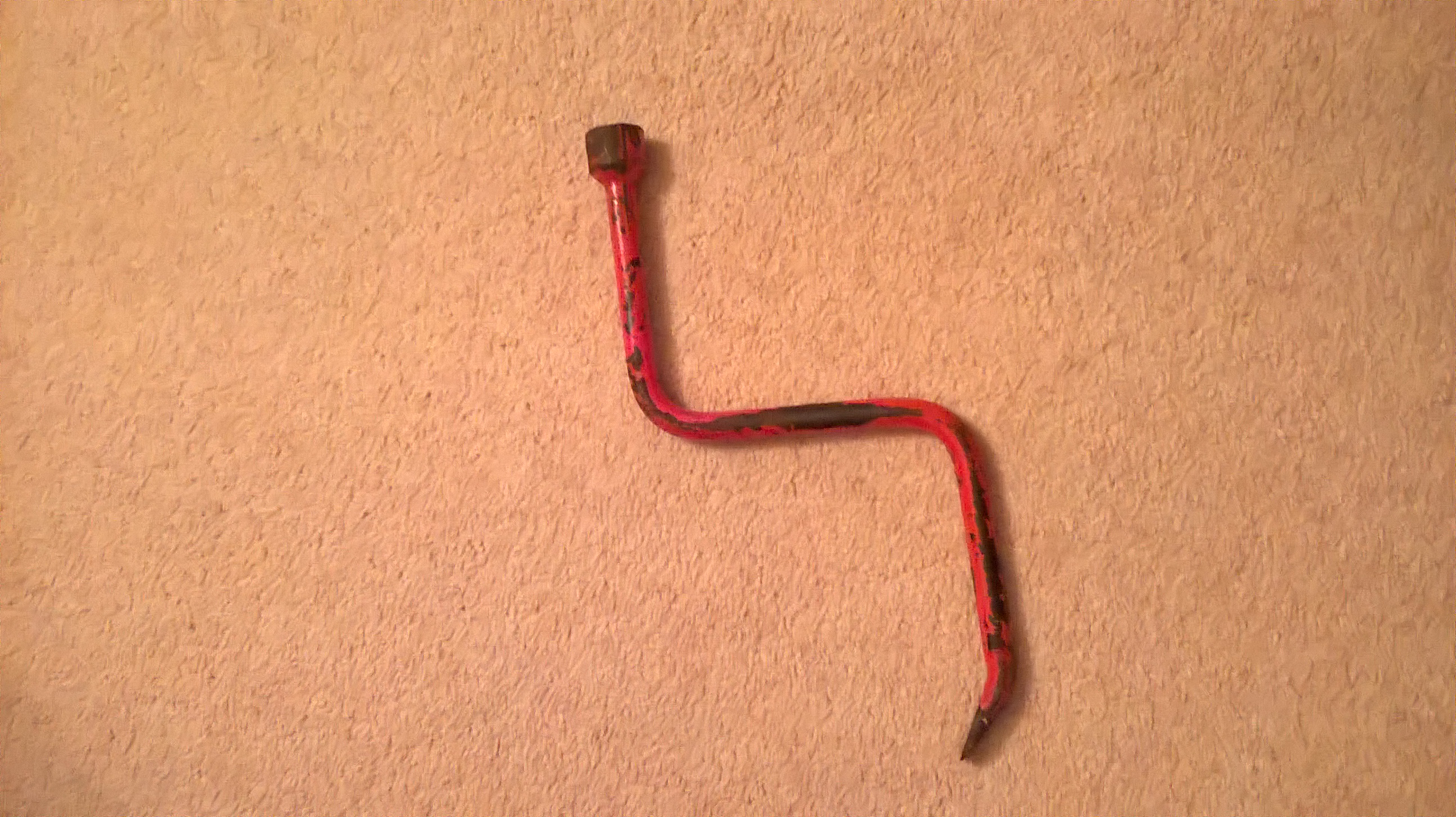

The bent wheel studs I tweaked more-or-less straight by putting a nut on the offending stud, and gently massaging it with my long wheel wrench. I'd also got an engineer's square to check them. Unlikely to be perfect, there were a number of bent studs on all four corners of the car, and they are now a lot better than they were. I believe the culprit for the bent studs, combined with the long chromed (but rusty) domed wheel nuts on my wheels, is this thing I found in the boot - Now correct me if I'm wrong, but that's not a Marina part, is it? Looks more like a Mini wheel brace to me. It's easy to yank the wheel studs out of shape with that thing. It's not in my boot now. I've got a ratchet and socket instead for the time being. It never ceases to amaze me how many cars get separated from their original jack and wheel brace and end up with inferior substitutes. Mind you, my Volvo C30 wheel brace split, because it was made of Belgian chocolate instead of real metal....
