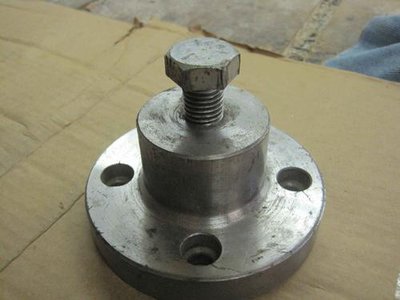

If the car drives forward and back you must have something turning, if not you have broken halfshaft/ axle. You will not have any drive at all! As for the roughness I suspect just the normal sound of the Sun and Planet gears turning in the diff If you do not have a whirring noise on the road and given your recent MOT, I would not suspect you have a wheel bearing problem. As for removing the Hub VL Churchill did a special tool for removal on the car before halfshaft removed, similar to picture. But only undo nut two turns so hub don't fly halfway down the street!!! Best tactic for removal is tighten bolt up a few sharp clouts with a good hammer, retighten forcing screw then a good sharp hit with hammer on end of forcing screw. Usually breaks the taper.
