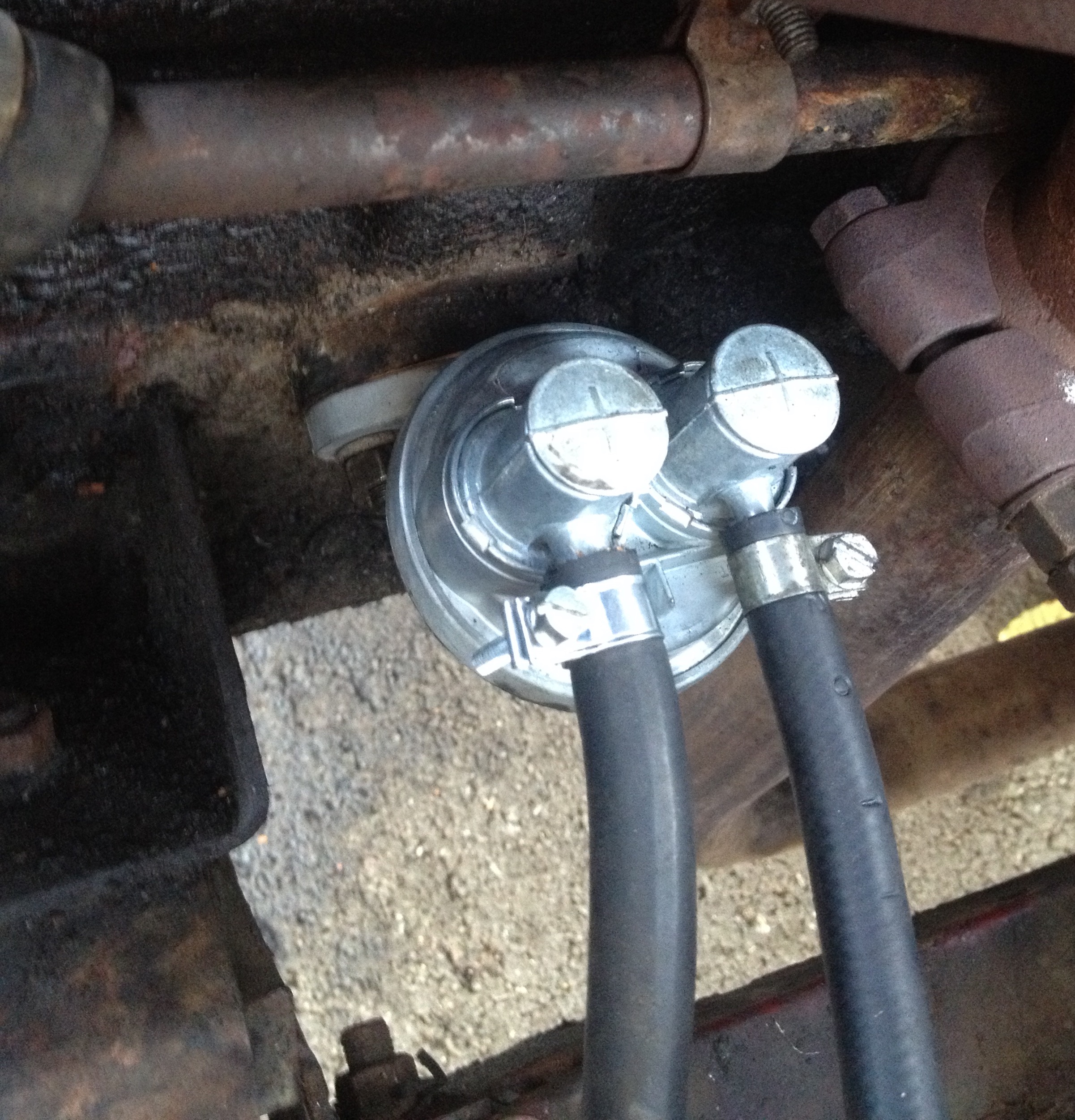

Fitted new fuel pump supplied by the club.
Thanks again to Balmy and Matt for their super quick service!

Those SU pumps can have new diaphragms fitted if you can get a kit.
Possibly similar to this item - 401810157546
- Posts: 1130
Hi Paul, thanks. Yes I do intend to rebuild the pump and keep it as a spare.
You're the first person to actually test one so I hope it works OK!
They seem to be getting harder to find (we only have a limited stock of the old stock ones) so definitely worth keeping the rebuildable types- hopefully ethanol proof diaphragms will start being more available for these.
- Posts: 1130
Don't worry Matt, it fired up straight away with the new pump, seemed to be working fine. I'll take the car for a drive in a day or so and give it a proper test.
