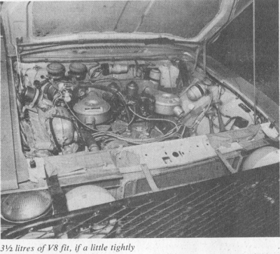

Just a couple of pics from my collection for you.
The Marina V8 Rally Car engine bay at S/T:
S/T Foden V8 Coupe
S/T Foden V8 Coupe
The Marina V8 Rally Car at Mira:
S/T Foden V8 Coupe at Mira
V8 Pickup underside (P6 Manual Gearbox..):
Marina V8 Pickup Gearbox
I have more but not on this computer. I shall dig them out for you over the next week.
