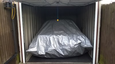

I said it couldn't be done, and I said I wouldn't do it. But I've spent Christmas morning wrapping something instead of unwrapping something. Last week I went into the garage and found the underneath of my Marina drenched in condensation. I used a fan heater run from an extension lead strung along the garden fence to dry it out, and very effective it was, but the open bedroom window for the lead, and rate of electricity consumption meant this couldn't go on. So the Permabag I bought in 2009 to protect a £1500 Mini held together with welded plates, was forced into action again. I'd bought a bag big enough to house a Cortina or a Viva (I never imagined I'd buy a Marina back in 2009) but when I put this car in this garage almost two years ago I believed I'd never get all the way around the car to pull the bag over the top. And I thought it would be best to keep it running anyway. But last year it hibernated with a sick engine, but I never noticed the damp on the car like this year. It's not easy pushing a big car over a bag, single handed, without running over the folded section that I've got to pull over the roof, but I managed it eventually. It'll be here now till the end of March. I know that's not everyone's idea of classic car ownership, but for me this is the best step for preservation in winter. Happy Christmas

Can you see why I bag it?
