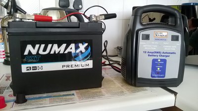

This battery is amazing. Numax 015 bought off the internet. Yesterday I recharged the Oldham 038 that came with my car, that had been in my shed all winter and had been left fully charged, and it took 6-8 hours to reach full charge. This Numax has been on the car all winter (but isolated) had been in use before I laid the car up, then was subject to about two hours of abuse while I was trying to solve the mystery of why my car wouldn't start AGAIN after winter, its had a relatively short boost from three short journeys on the car and I've put it on charge and after less than half an hour it's full. It'll be going straight back on the car.

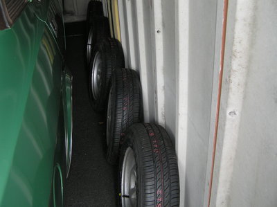

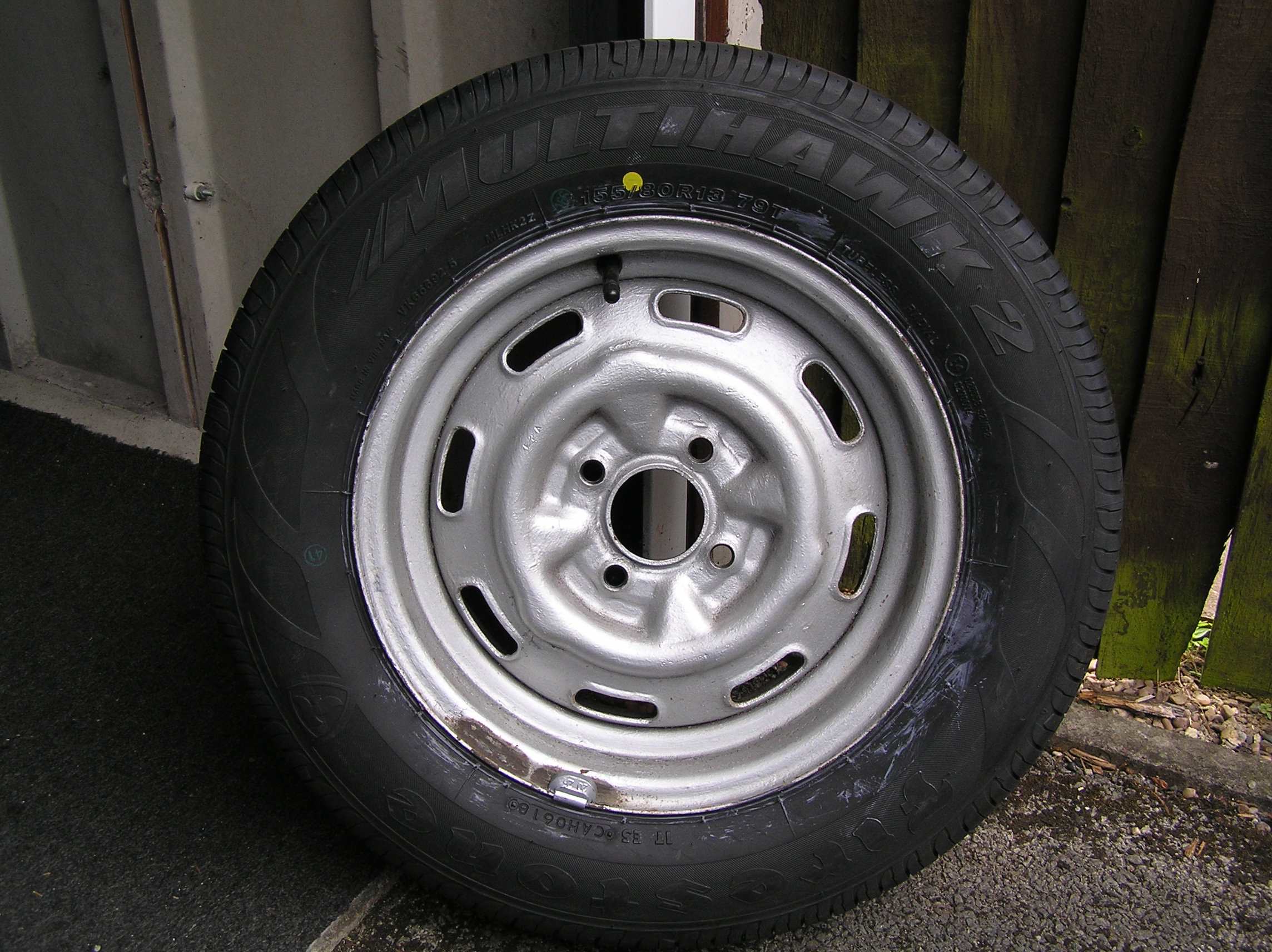

Wot I call narrow tyres...
I've downsized from 175/70/R13 (with cracked sidewalls) to 155/80/R13. In the hope it makes my steering lighter, and it's closer to original standard spec anyway. I chose Firestone Multihawks, ordered from Asda's tyre sales website and delivered at my chosen appointment time to my local Formula One tyre and exhaust centre near Long Eaton railway station. Ordered online, pick your nominated participating local fitter, pick your appointment time, pay on fitting. In part I chose Firestones because it's what I had fitted to my Mk1 in 1982!

Have you greased the top swivels? Could be why your steering is a bit heavy. I ask because for a couple years I only knew about the lower trunnions but had no idea there was grease nipples on the top swivels that need doing too.
- Posts: 1457
Yep, first year I owned it, but I'm going to do it again while its hanging in the air. Autobooks manual reckons that's how you're meant to grease them, while its suspended. Those 175s were fat. Much fatter than the 145s I had on KRB, my main other Marina experience. Fat, and old, and cracking.
They are what I put on my Mk2 (size and tyre from memory) and that drove fine to me, although it was the lighter 1300. Lighter than the estate but that was on 185s.
- Posts: 1457
185s? My God! I don't think I'd be able to turn the wheel at parking speeds on mine with those!
