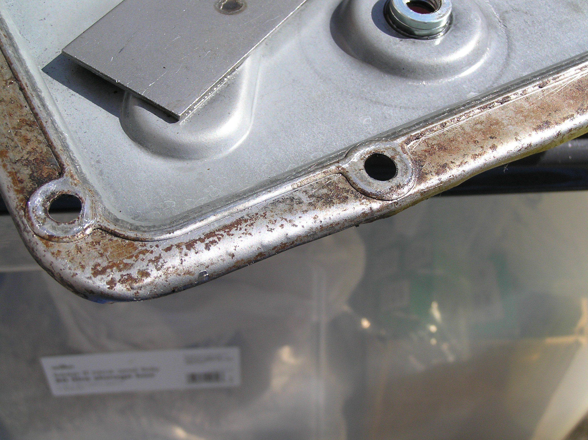

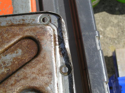

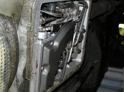

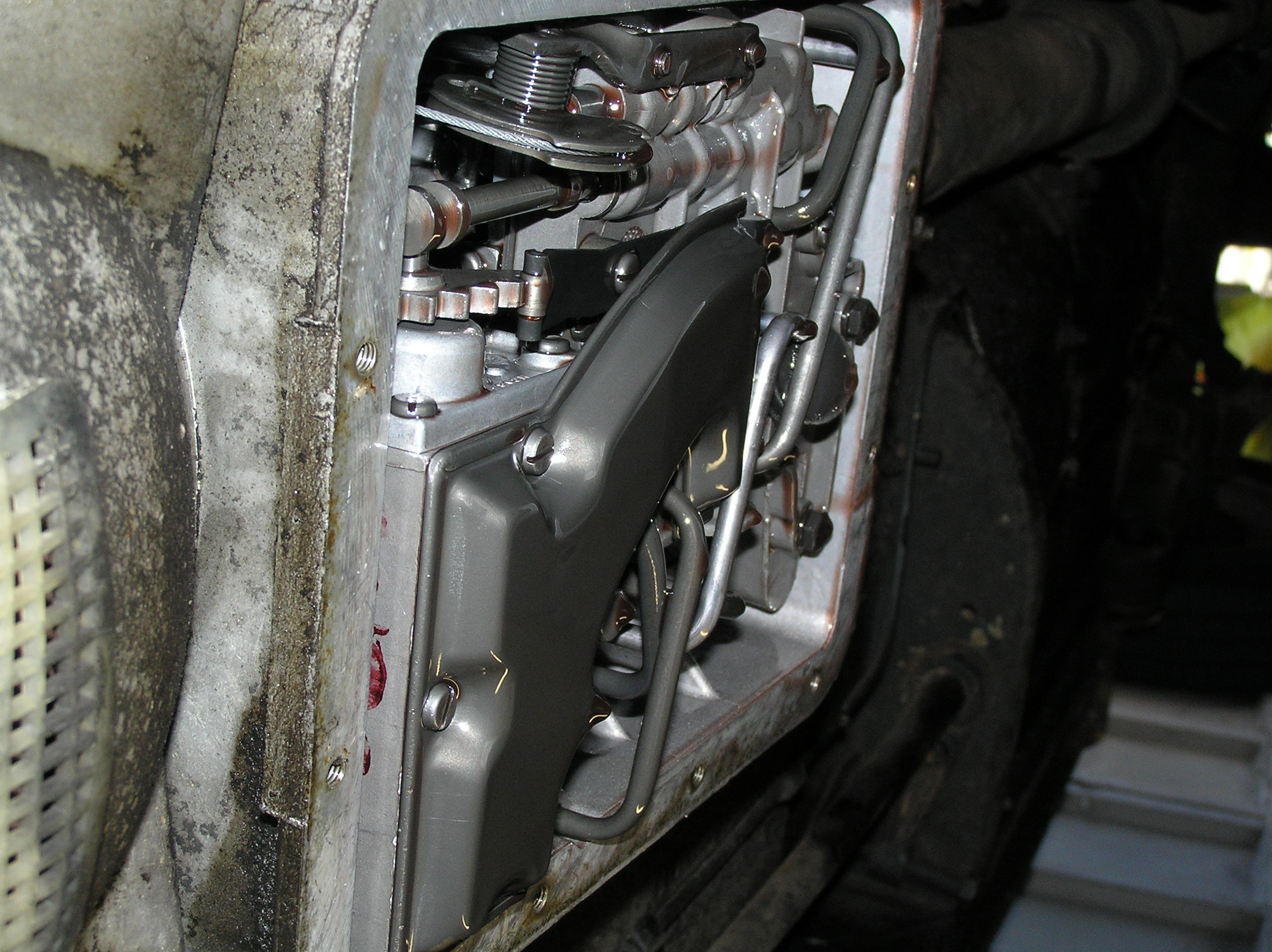

I'm mid way through the repair of the automatic gearbox right now. Pictures show the sump as first removed, with some tiny particles at the bottom which I'm not going to worry about. When my Mercedes went in for a fluid change 8 years ago, and I ended up with an £800 bill, there was metallic sludge in the sump on that. I'm not sure what the plate spot welded to the inside of the sump is supposed to do, but it isn't, as it looks, a bit that has fallen off inside. But I've also found a small round magnet stuck up in the pipes exposed by removing the sump. Obviously there to attract metallic particles, I can't remember reading about it in the manuals so i'll have to look that up again. It can probably only do more good than harm, but I'm not sure it is a standard fitting. As long as it cannot become dislodged and get somewhere it isn't meant to be, but if I wasn't doing this job myself, I'd have no idea it was there.
One corner of the sump is well bashed back and the bolt in that corner was loose. Other bolts were very tight, tighter than I expected, but the sump holes don't seem especially domed. The bashed corner hasn't done the straightness of the sump flange any favours though. The old cork gasket came off in tiny pieces, I had to scrape it off with a Stanley knife blade. Very compressed and no doubt its been very hot. The dip stick tube has a flared end like a big brake pipe, and no rubber seals or anything. I'm just going to use Loctite 542 on the threads. The sump plug (screw) has a rubberised-looking washer still stuck to the sump pan. I've got nothing like that to replace it with, so i'm just going to hope for the best that it still seals.

Yes there is a magnet, the Autobooks 850 manual says so but not Haynes. It also says to use Loctite on the sump plug threads so I'll do that. It also says if you see any bits in the sump, take it to an agent but that's not going to happen. Not after I had the Hornet for five years and bought it unknowingly with a main bearing that had picked up producing metal shavings in the oil. Classic car dealer as well. I found that out too late after doing an oil change six months into ownership. Worried me sick but after five years and regular oil changes nothing ever happened.

Thanks Chris but I've been back under the car again away from my phone! It's back together now, it just needs filling with ATF. I think that washer will be fine. The least of my worries. I put a little hydraulic thread lock on the threads of the plug, and the dip stick tube union. That sump was a bit bashed. And the metal was thicker and harder to bend than I'd been led to believe looking at forums on the BW transmissions. It's been a while but I got most of my useful info off a Stag forum. So I've nipped the sump bolts up, cylinder head style, just using a 1/4" rachet and holding the head not the handle, progressively going round until they all seem to offer the same resistance without the new cork gasket being crushed flat. I was trying to use a steel rule and also my kitchen worktop as a surface plate, trying to assess the flatness of the sump flange. No way could I get it perfect, but I hoped the tiny amount of distortion would pull out as I nipped the bolts down. Time will tell when I get the ATF in and run it...
