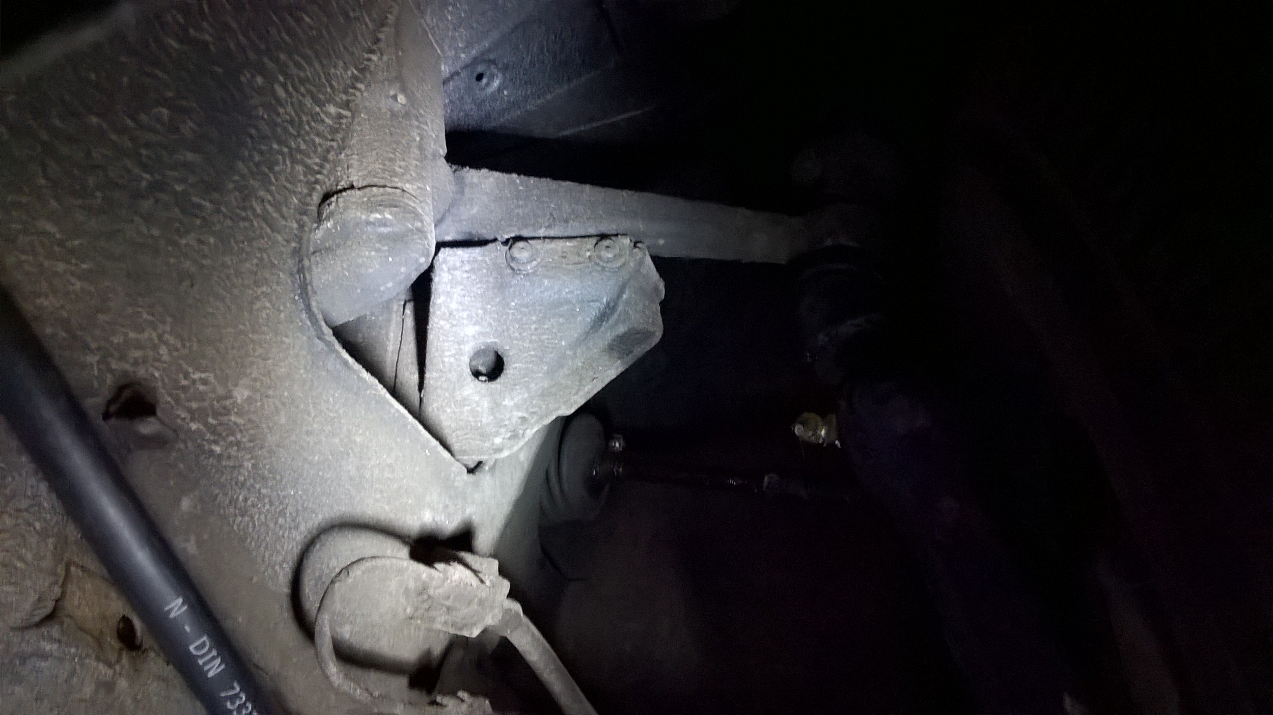

I once read in a magazine where someone said that if you go in the garage to do something, and you only end up doing fifteen minutes worth of work, as long as it is in the right direction, it's progress. So far this Bank Holiday weekend I've been underachieving as ever, though not helped at all by a maintenance call-out to work this afternoon. But I did get in my puny under sized garage, which I've said I cannot work in, jacked the front of the car up a bit and put it on axle stands, and bolted the puny under sized starter motor back on. Certainly these aren't ideal working conditions! Next job, I hope to fit that relay and get rid of the hot-wired starter button while connecting the starter back up.
But while the car was in the air, I noticed one front wheel still touching the ground, and the other raised. Odd, since the axle stands were both on the same setting and placed in the same position either side of the chassis. The answer - the bump stop rubber has disappeared on the nearside. And the one on the offside looks a bit like a Shreddie. I am guessing there are one of two possibilities here - either they are totally unobtainable, or they are a Morris Minor part.

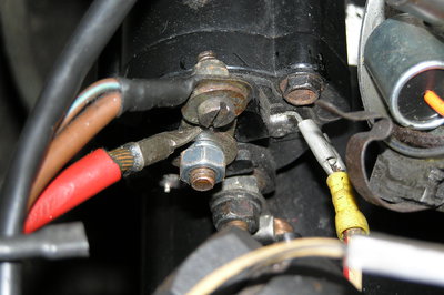

Saturday I bolted the starter on, this Easter Monday I connected it up. It turned with the flick of the key and since at that moment the 'bodge' starter button was still located in the engine bay, I gave it a few flicks with that too. All looks good. Although I do have some questions about the way this 'small' starter motor is wired, that I'll come to later.

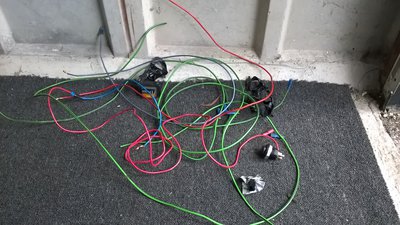

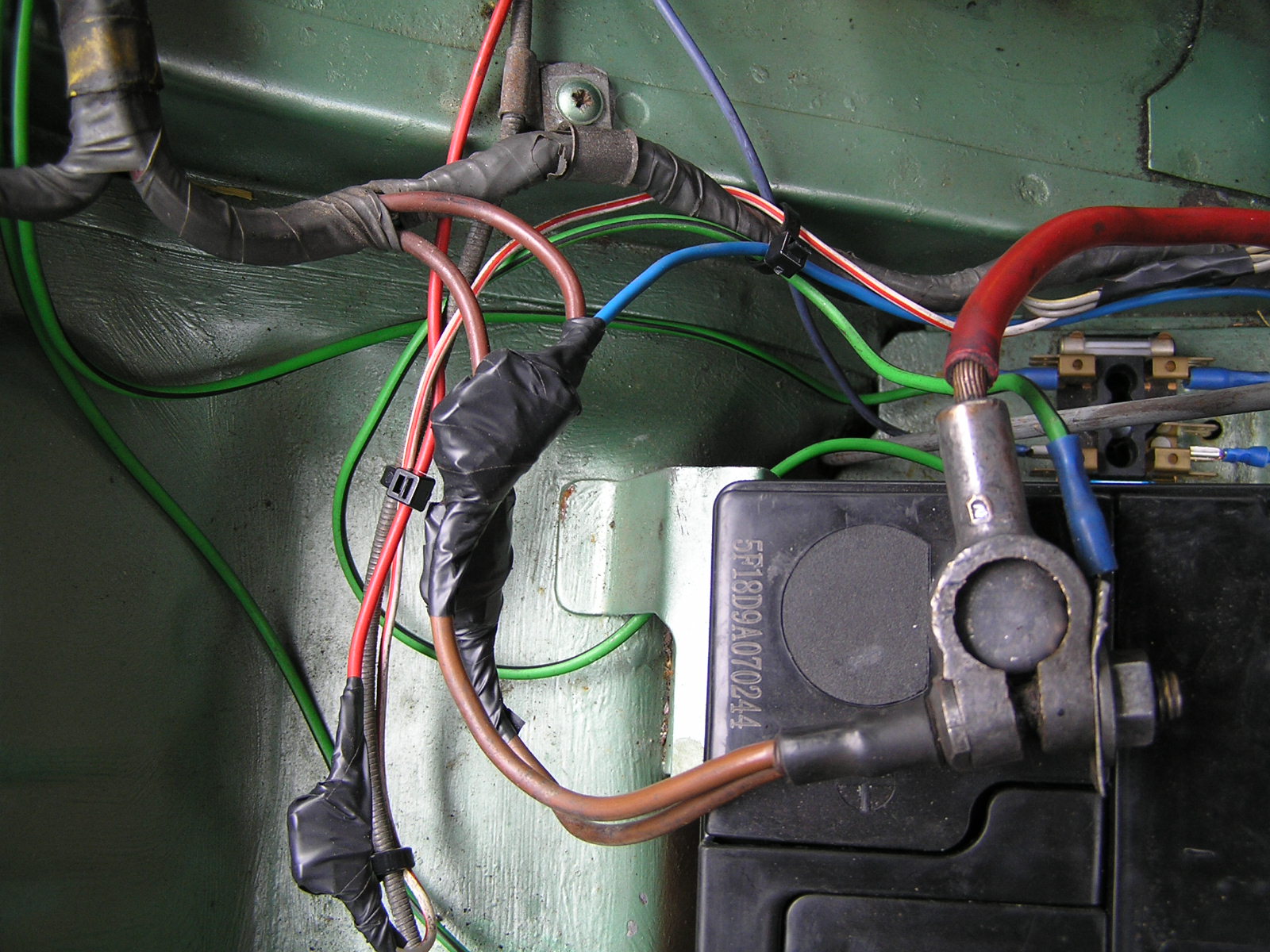

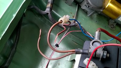

So next I wanted to do the long overdue mod to the wiring, putting in a relay into the starter circuit as per Kilroy's advice. First I decided to get rid of the redundant Kenlowe fan wiring and tidy up the hacked about parts of the loom that had been butchered to fit that starter button. The two brown leads from the battery positive terminal had both been cut and rejoined with domestic terminal blocks. One was just cut and joined, I know not why, the other had a blue wire clamped in the terminal along with the brown, to send a live feed to the starter solenoid via the button, by-passing the ignition switch. I think butchering car looms like this ought to be a punishable offense. I rejoined the brown cables using 30 amp heat shrink bullet connectors (or at least that's how Halfords describe them - I always thought bullet connectors were the type that plug into each other - these take a wire at each end and crimp).

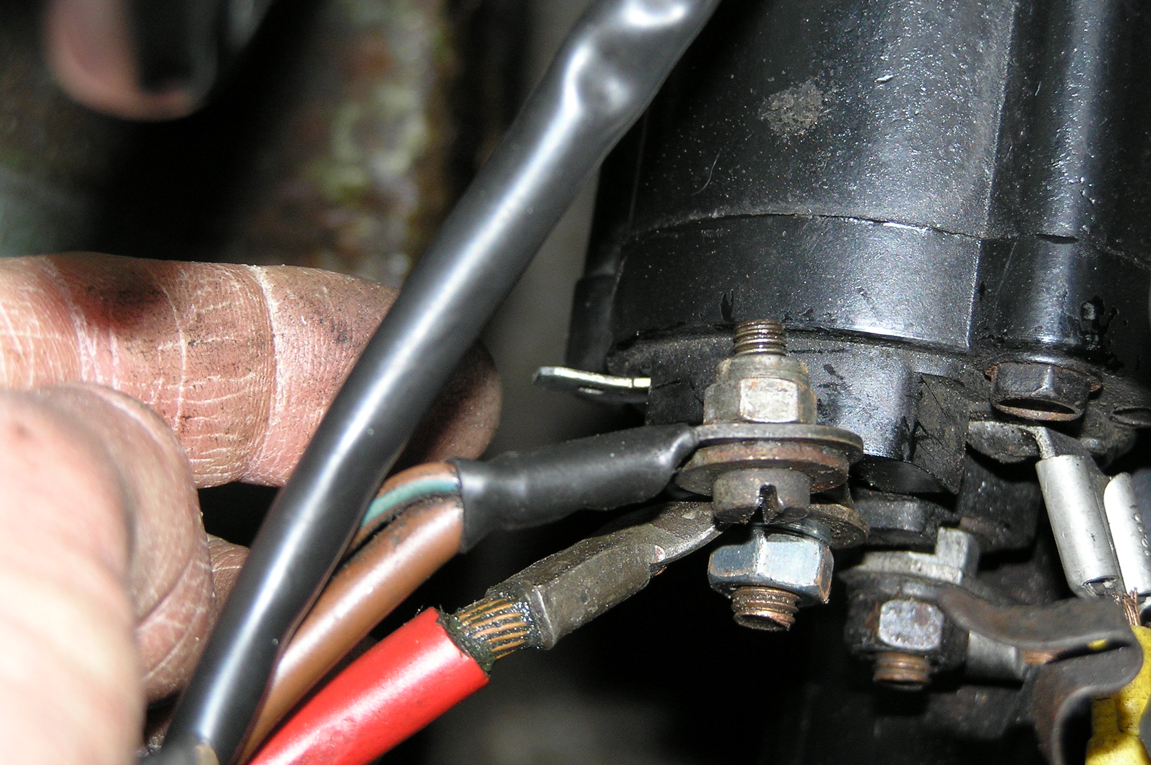

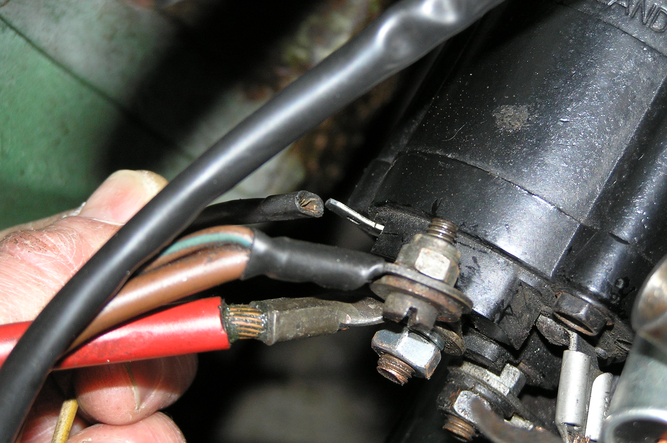

So, the last pictures in this sequence are of my starter solenoid and wiring. The white/red wire with a 35 amp spade connector goes to a male spade terminal, then a red cable goes from the battery +ve to a stud on the solenoid. It looks like somebody has made a little plate that fits over that stud, and a nut and bolt holds the brown cable and a green and brown wire above the red cable, so the brown, green and brown, and red are all connected to the same stud. Now I don't instinctively understand circuitry but this must be correct because it works. What further puzzles me is that the solenoid has an unoccupied 5 amp spade terminal, and my wiring loom has an original-looking 2 amp spade connector flapping about doing nothing, that apart from the mis-match in sizes, looks like it might belong there - but clearly everything works without it. Anyone got any suggestions?

Post by JubileeNut » Tue Apr 18, 2017 8:18 am
Good pictures! Bet your glad to get rid of that bodged wiring?
Posts: 10264
Post by MarinaCoupe » Tue Apr 18, 2017 8:28 am
I'll bet that at some time the wrong battery was fitted with different terminal posts so they chopped the old connectors off and substituted some that fitted.
Post by Kilroy » Tue Apr 18, 2017 9:38 am
Here is my thought about the spare terminal on the starter.
Later models featured a 6 volt ignition coil with a '6 volt' ballast resistor so that it could happily be attached to a 12 volt car.
When you operated the starter, a terminal on the starter solenoid supplied power that bypassed the ballast resistor - so the ignition got a shot in the arm while the starter was effectively dropping the available voltage for the ignition when it needed it most.
I believe that is what you have on your starter solenoid.
If you have a 12 volt coil then it would make no difference at all.
Coils have their normal operating voltage stamped on the base as a rule.
Any coils with a '6' are designed to run in conjunction with a ballast resistor.
I believe this arrangement would work well with 1800 engines as they require a lot of energy to crank over.
The 6 volt coil method was adopted for all of my Mk3 cars but none of the Mk1 or 2 models I have encountered.
