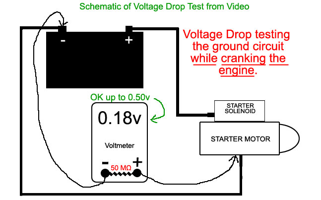

- Posts: 1722
Re: Starter Motor Replacement
Be best to measure the volt drop in earth circuit and check you are getting 10 volts at starter under cranking earth volt drop should not exceed 0.50 volts cranking ideally 0.25 volts

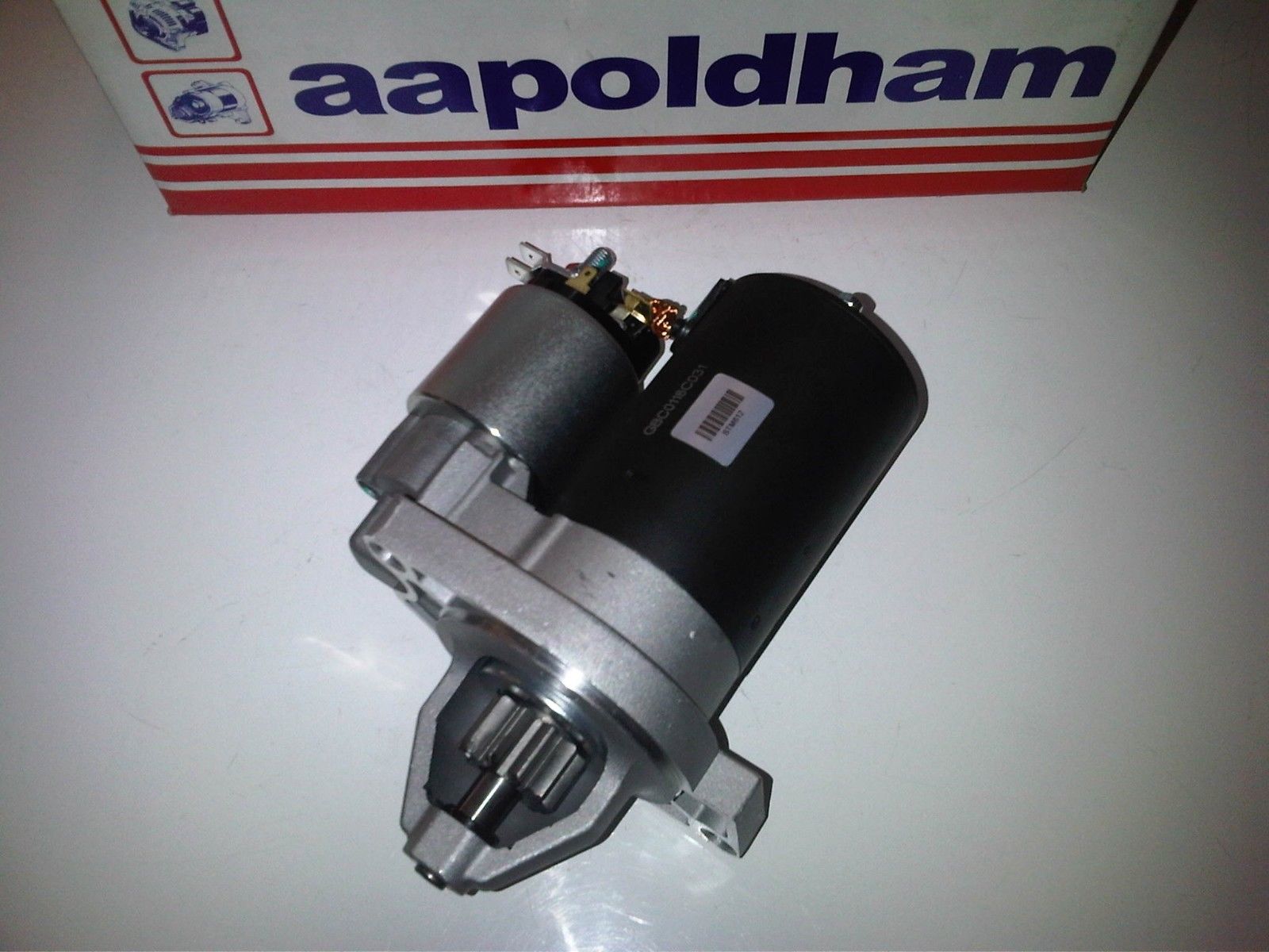

Can anyone point me to the correct Inertia starter please? There's a 2m100 on eBay https://rover.ebay.com/rover/0/0/0?mpre ... 2734479057 but someone posted above that the 2m100 was for the automatic.
- Posts: 1457
The only reason the automatic was mentioned was because the automatic is supposed to create more drag to turn over, hence the starter motor is reckoned to need more guts. As far as I know (though my experience is limited to my car, workshop manuals and advice on this forum) the starter motors are interchangeable whether for automatics or manuals. The Lucas designation only applies to the electric motor parts anyway, just like the M35J, which is why you see motors listed seeming to be what you need that have the flywheel end opposite handed for a different car.
