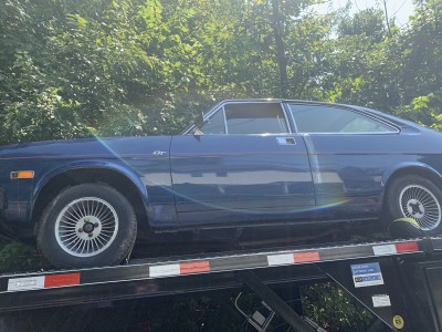

Hello all,
In my intro thread, I mentioned that I'm a US-based owner of a 1974 US market Marina GT.
This car appeared on Ebay back over the summer, and even though I didn't buy it then I made contact with the seller, and it arrived here in Kentucky on Friday.
The story of its arrival is a bit fun, and something that I will write up in time, but for now it's resting while I'm out of town for the weekend. The previous owner did a LOT of restoration work on it and had the exterior looking great but it has sat for 10 years and shows some evidence of that. It's not currently running, but I hope I can fix that by the end of the week.
As a bit of background on myself-I'm 31 years old, and have always had a bit of an interest/fascination with LBCs in general. I'd wanted an MG for years, and bought a 1970 in the fall of 2015. I've had a LOT of fun with that car and it's not going anywhere. Having learned to drive in the mid-2000s on fuel injected Japanense and American cars that just run, it was a bit of adjustment for me but I've also learned a LOT about cars in general and about MGs specifically since buying it. I'm also proud to say that it's only made three visits to the shop in that time-one was to fit a new top, one was to rebuild/restuff the seats, and finally to fit new tires. I've had the engine out(with help) to change the transmission, and am planning an engine rebuild and overdrive install in the next year.
The Marina is putting together a couple of desires. I'd shopped Morris Minors pretty heavily as a somewhat more practical(meaning a usable trunk and back seats) LBC to supplement the MG, but the right one never came along. I'd know about Marinas for a while, but they're quite uncommon in the US, with the number of surviving examples estimated at "around" 2 dozen. The larger size, somewhat newer design from a Minor, and shared engine with the MGB all appealed to me. So, after a few months of dragging my feet, I have now now parked next to my MG.
With the carrier issues in getting it to where it needed to go, I made a bit of an emergency effort to start it with a jump pack and ether, but it was a no go since it wouldn't spark(a coworker bailed me out with a tow strap hooked to his minivan and me steering and braking, plus some grunting for the final few feet, to get it in place). At least I know the engine is free given that it cranked fairly well, so I think I just need to track down the spark to get it running. I'm also afraid that the parking pawl MAY be broken, but I can deal with that if it's the case.
I can't do anymore on it until tomorrow, but I do have a fresh battery ready to be installed(the old one showed fully open circuit when I tried to charge it, and I was a bit afraid to try pumping 20V+ through it to see if I could break through any sulfation, especially since even if it had come back it would have been at seriously reduced capacity). I'll try a clean up on the points, but have a new set of points/condenser, a new cap, and a new rotor on the way. Unfortunately, since it's a 45D and not a 25D, I didn't have that stuff on hand.
I'll update this with my progress. Once the car is running again, I can drive it to the sheriff's office and get a Kentucky safety inspection-something that's a bit of a joke. They charge $5 and it takes less than 5 minutes while they check headlights, tail lights, brake lights, turn signals, windshield wipers, and the horn(you sit in the car and activate all of those things when they tell you). I'll have to risk driving it there on expired registration, since they won't come to me unless I have a minimum of two cars for them to inspect. Once that's done, it will be ~$50 to register it on historic plates and go from there.
I'm excited about getting this one back on the road!
- On the carrier
