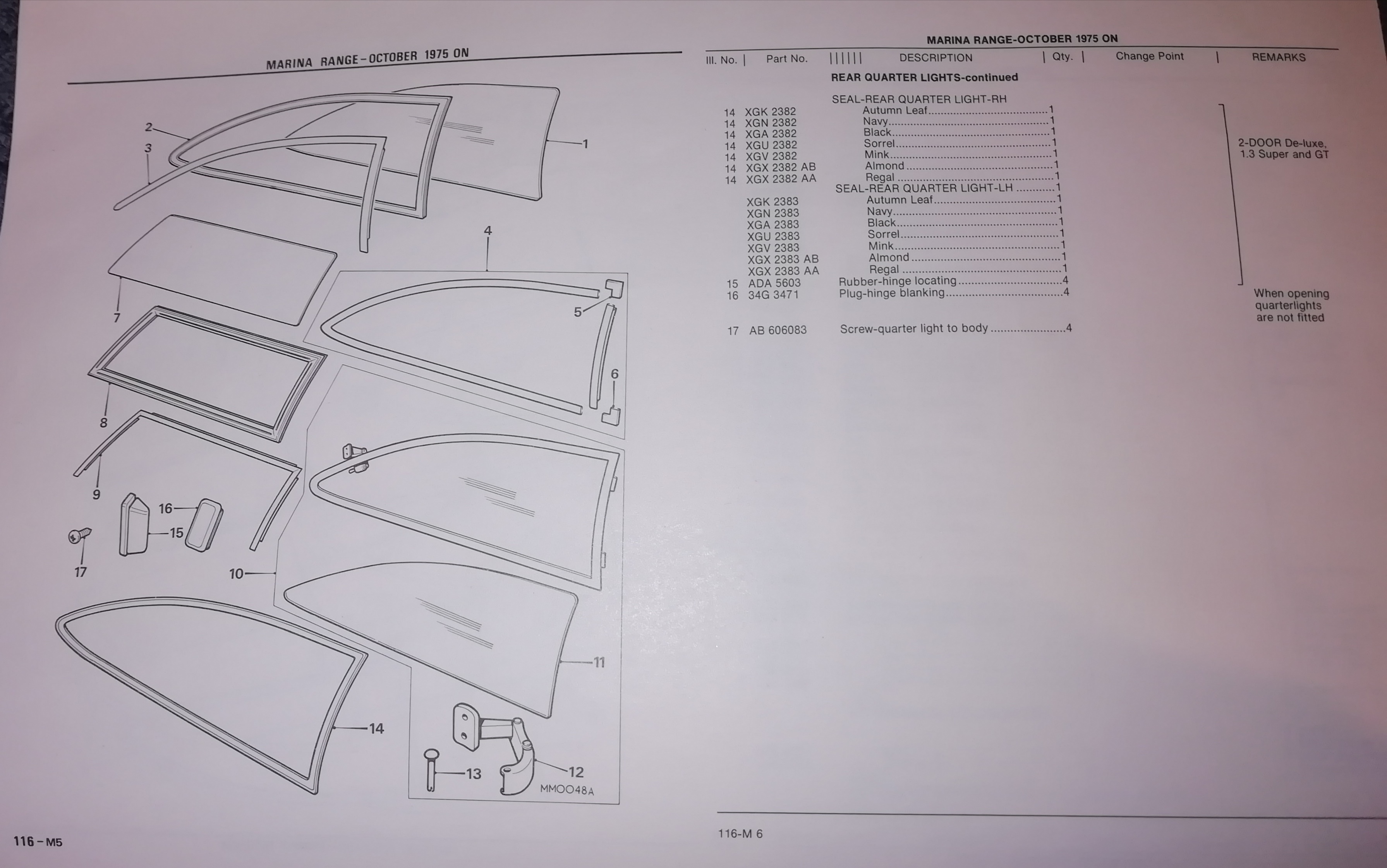

Does anyone have an English parts book that lists the part numbers of the hinge rubbers for the opening rear quarterlight windows?
My Australian parts book has HYB6260. Were they shared with any other BL or BMC vehicle, such as the 2-door ADO16 1100/1300?

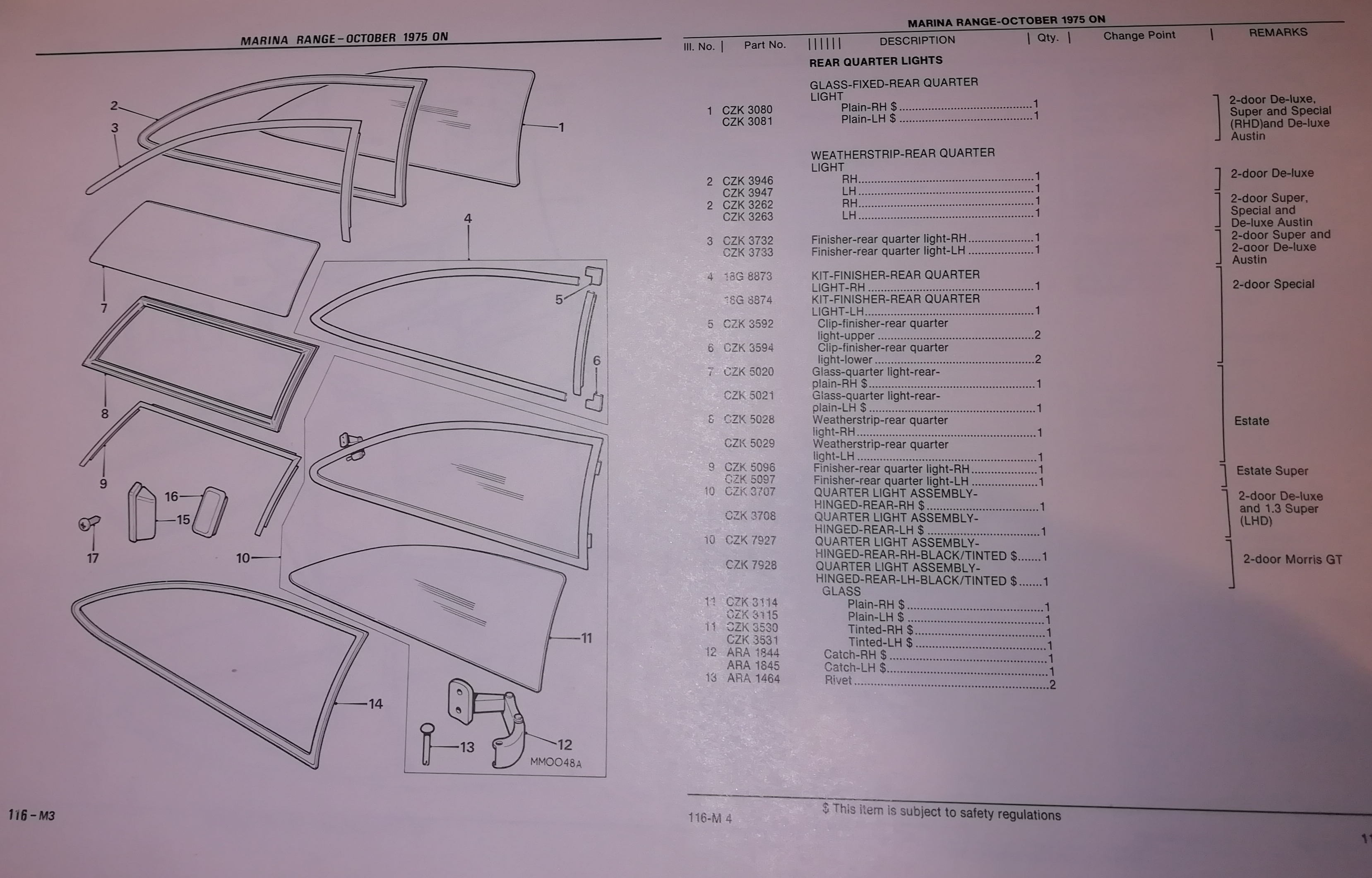

Hi Bryan,
Not sure if you're still looking for this information but I found this in one of my part books. If it's not quite what you need or it doesn't bring anything back let me know and I'll have another look in some others I have somewhere

Thanks for those pages. The part number ADA5603 came up amongst ADO16 1100/1300 listings here. That was the only hit I got.
So Skip Harris' supplier in the US could be the fallback option, if the ADO16 facebook groups draw a blank.
