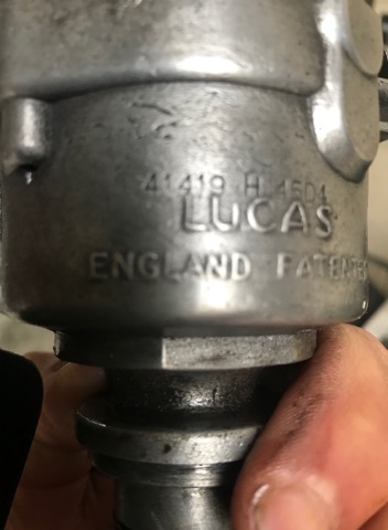

She has 1.8 super camshaft and the distributor that she has is mini clubman according to the number on it.

The advance curve for an A-series Mini Clubman will be different to a B-series Marina. The ignition advance is likely too far off below 50kmh, hence it feels flat and unresponsive.
Ideally you need to get a Marina distributor, or change the weights/springs/vacuum advance unit to match the Marina, or get one of the tunable electronic distributors (with 16 different advance curves) so you can trial to find the one that gives the best performance.

I wouldn't worry about changing the camshaft, until you have got the correct distributor. If you can't find a good Marina distributor, then one from an MGB would work better than one from a Mini.

So the flat spot is coming because i don!t have a good distributer, or something in the carbs? Not because she is 1.8 super but have two carbs and she didn’t have camshaft Tc ? Thanks Renzo

So I think, this distribuer is the problem, i try to find one for 1.8 super, then I hope that my mechanic make the things exactly that I read.

Personally I’d start with a dizzy and go from there. Dave’s advice is spot on and the way to start.
