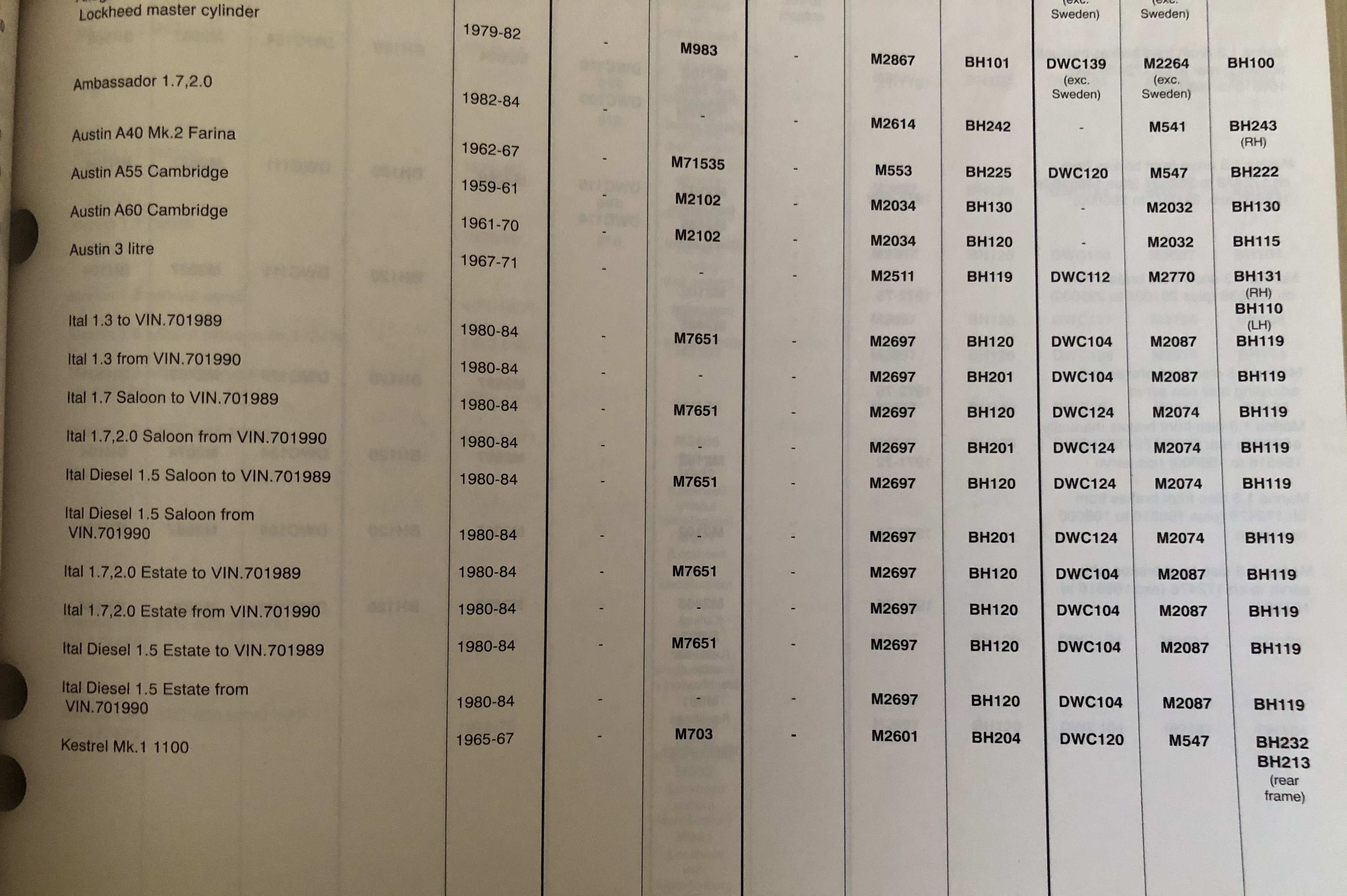

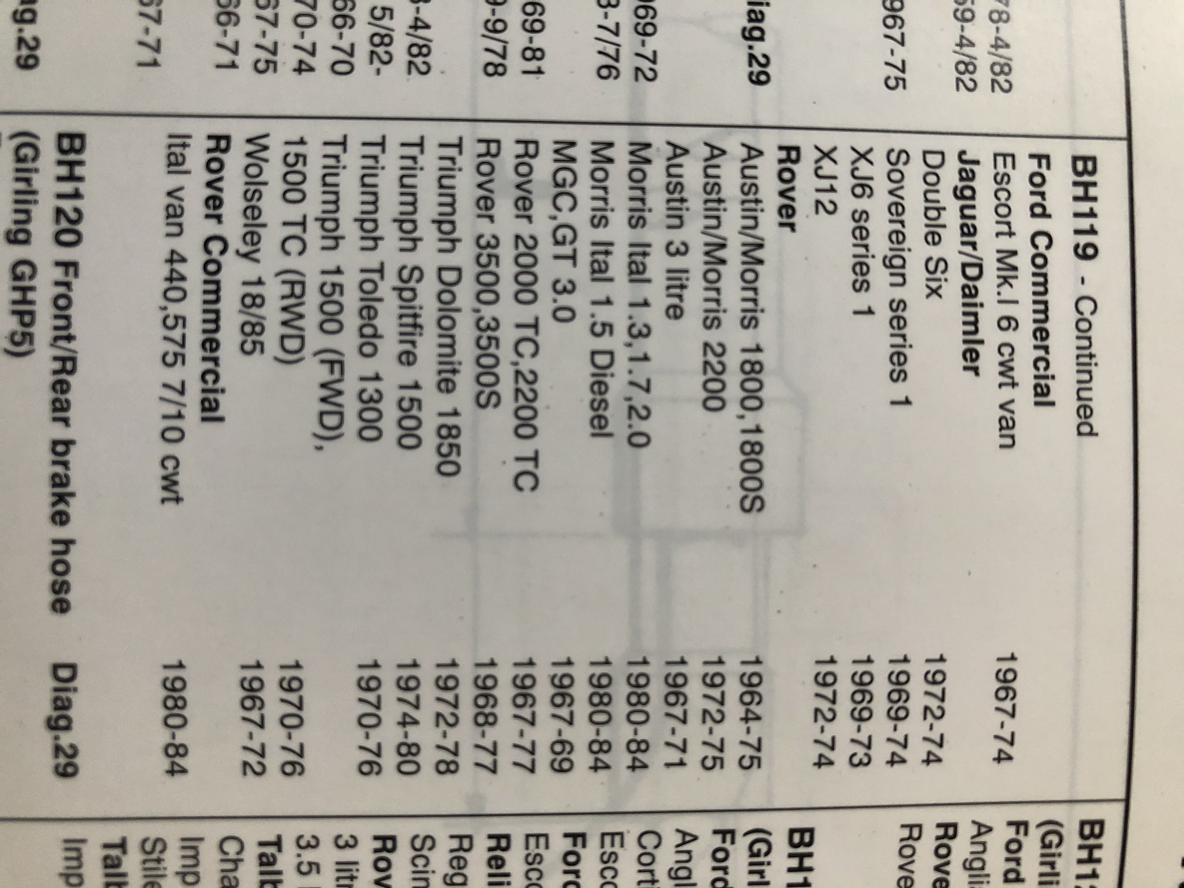

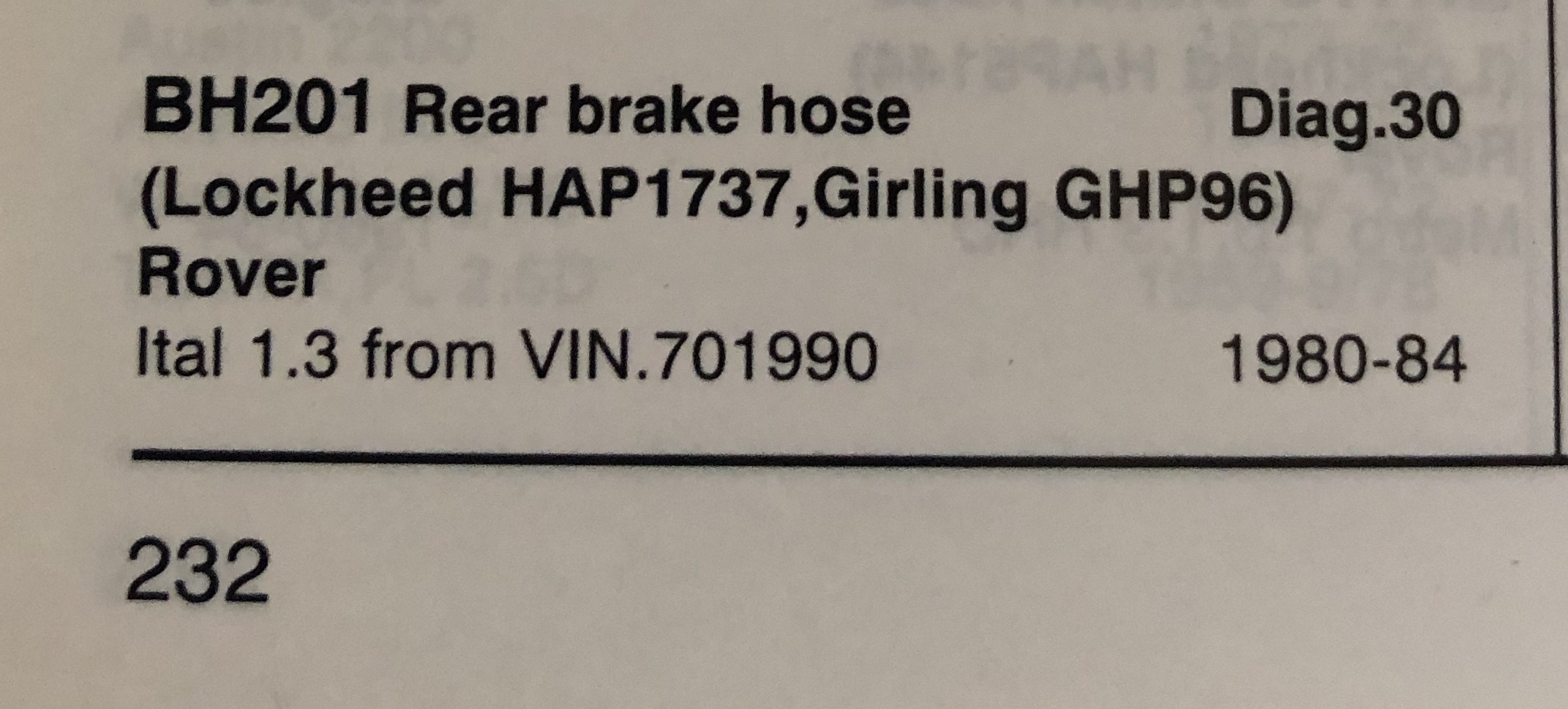

Hi David
I have a lovely paper Moprod hydraulics catalogue, that gives details by model, part number, all vehicles using the same part so here we go.
Ital options
It’s the late Ital pipes we are interested in so the front hoses are BH119 & the rear BH201
Rear pipe
Front pipe

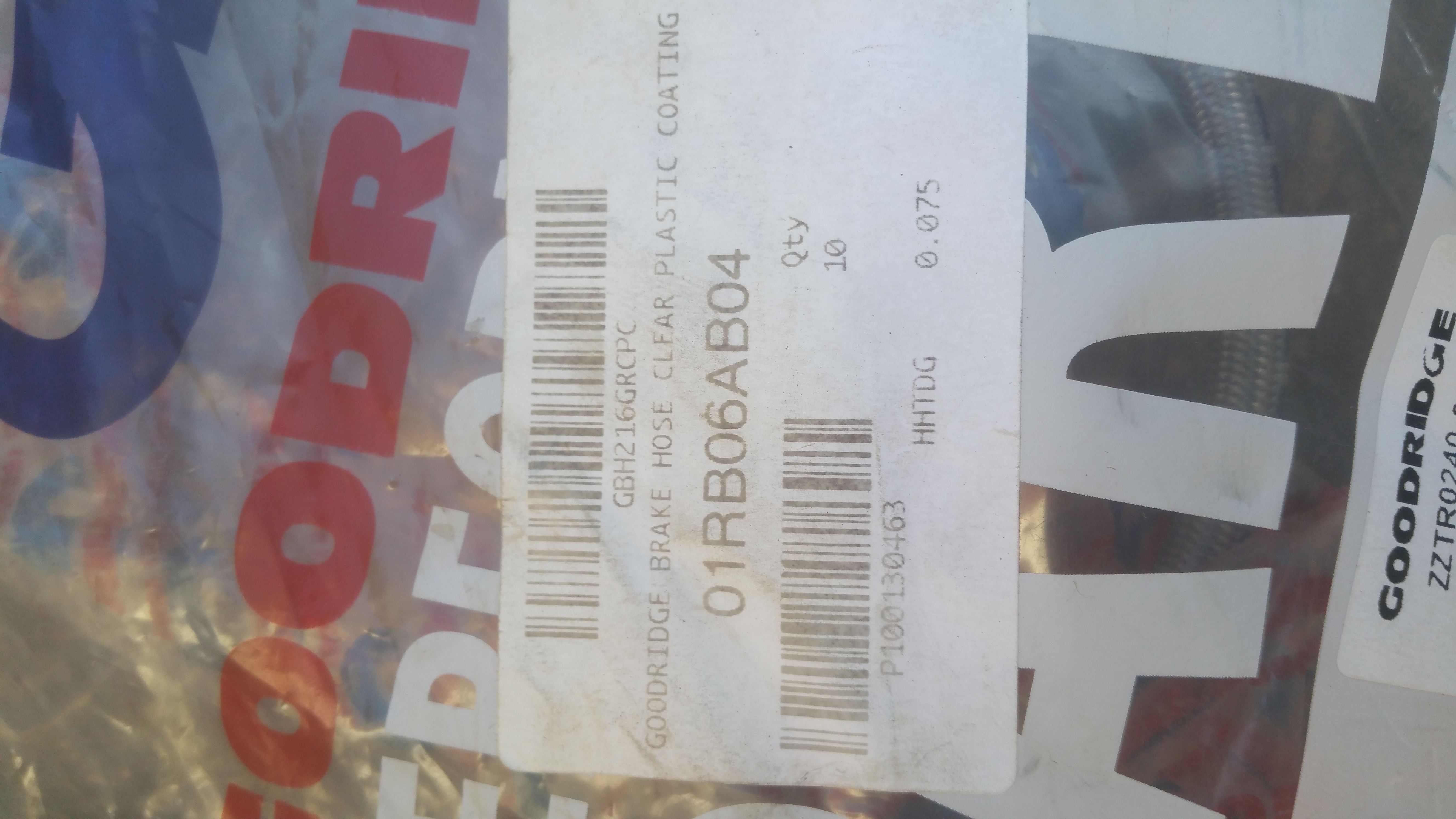

Post by MARINAMADBAZ » Fri Feb 07, 2020 1:02 pm
my mistake gbh216
these are longer and screw straight into caliper.
the good ridge no.gbh216gr
baz

Post by MarinaCoupe » Fri Feb 07, 2020 6:06 pm
The tables give you some cross-references into cars where stainless braided hoses are readily available.

Post by david painter » Sat Feb 08, 2020 4:49 pm
Thank you both. With the pictures Chis put up and some online catalogues and my original marina BL catalogue I have discovered that the front hose is a
GBH 211 same as front on Stag and 2000/2500 range I have compared the new TRW hose I have with my pick up and my Stag it is the same the MGB listing is 22 mm shorter. The rear is GBH138 the same as Dolomite and Spitfire/GT6 range rear hose. Tomorrow I am going to the Triumph / MG spares day at Stoneleigh so will see what I can find
