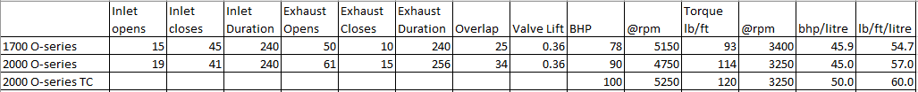

Found the cam timing specs, 2000 has longer duration exhaust timing, and more overlap :-
O-series cam timing.png (9.22 KiB) Viewed 616824 times
Interesting to see how the power outputs compare between the various engines fitted to the Marina (and a couple that weren't).

Interesting to see that the 2 litre TC managed 100bhp albeit at significant revs.
I think with some head work I may manage a little more, although I would love to mount a pair of 40mm Webers for the win.
I do have a pair here, but would need to have a manifold made, so the twin HiF setup on my Rover inlet manifold will be the first trial.
I have an aftermarket camshaft which I should be able to use thanks to some shims supplied by a forum member.
There are many advantages to be had by using the 2 litre setup, and if faced with the necessity of an overhaul anyway it makes sense...
Re: 1.7 and 2.0 O series compatibility. Replacement or replacement parts
Posted: Tue Dec 01, 2020 11:51 pm
by locost_bryan
52-55bhp/litre seemed to be the BMC/BL standard for sporty variants, so the 2000 should be good for 110bhp with a similar cam, inlet, exhaust and compression ratio as the 1800TC and 1750TC (and the Mini Cooper).
Interestingly, the 1750 TC seems to have got all it's extra power from a higher compression ratio (9.5:1 vs 8.6:1) and the twin carbs, as the head and cam and exhaust manifold are the same on the single carb variants, so just boosting the compression ratio of the 2000TC to 9.5:1 might gain that extra 10bhp.
