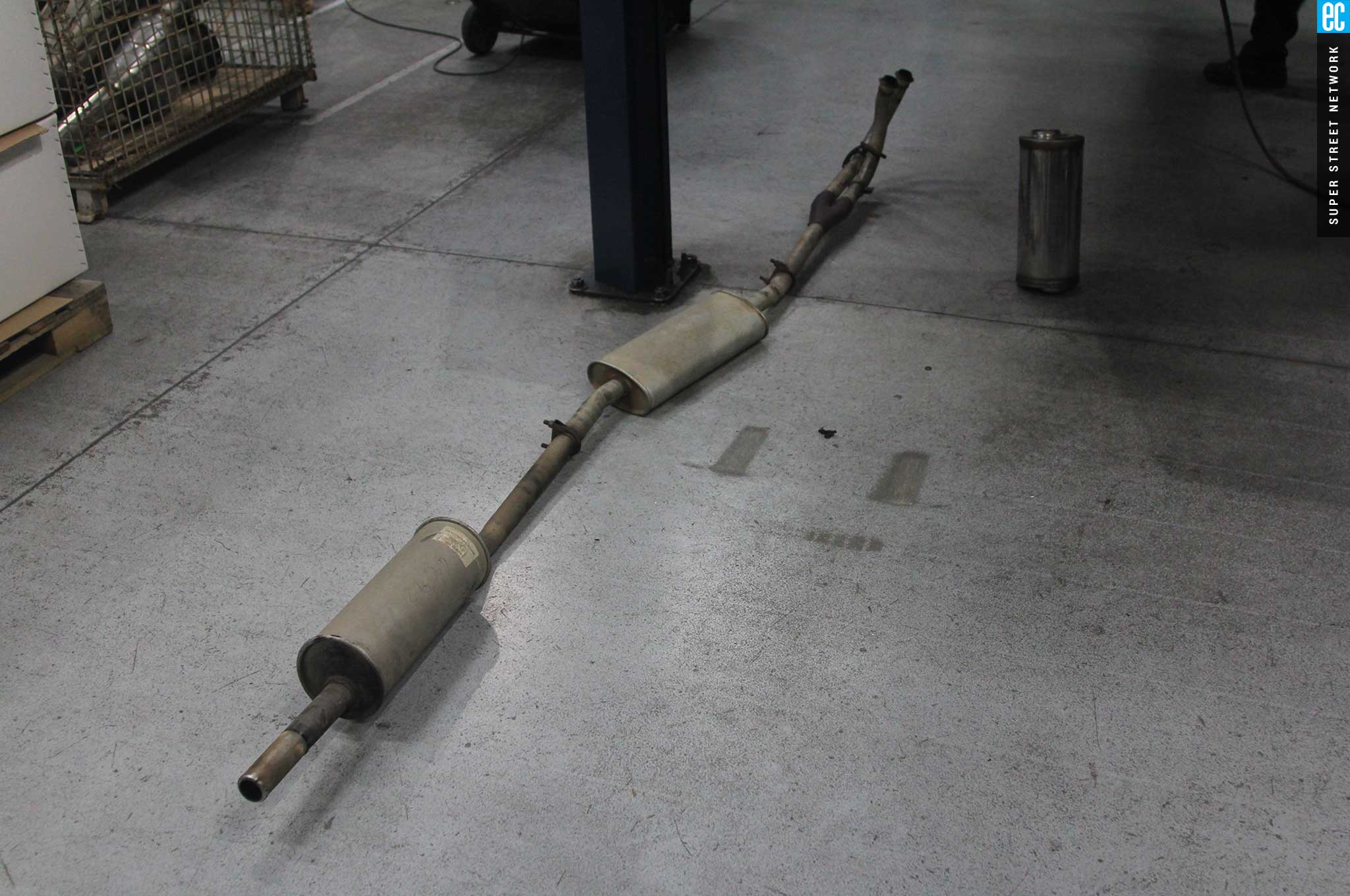

Post by ClaytonSpeed » Mon Oct 19, 2020 7:51 am
The MGB factory mid exhaust box in this shot from Bryan's link looks very similar to the RC40 as used on minis:
Obviously with straight in/out pipes. Now, they do sound nice on B series engines.
